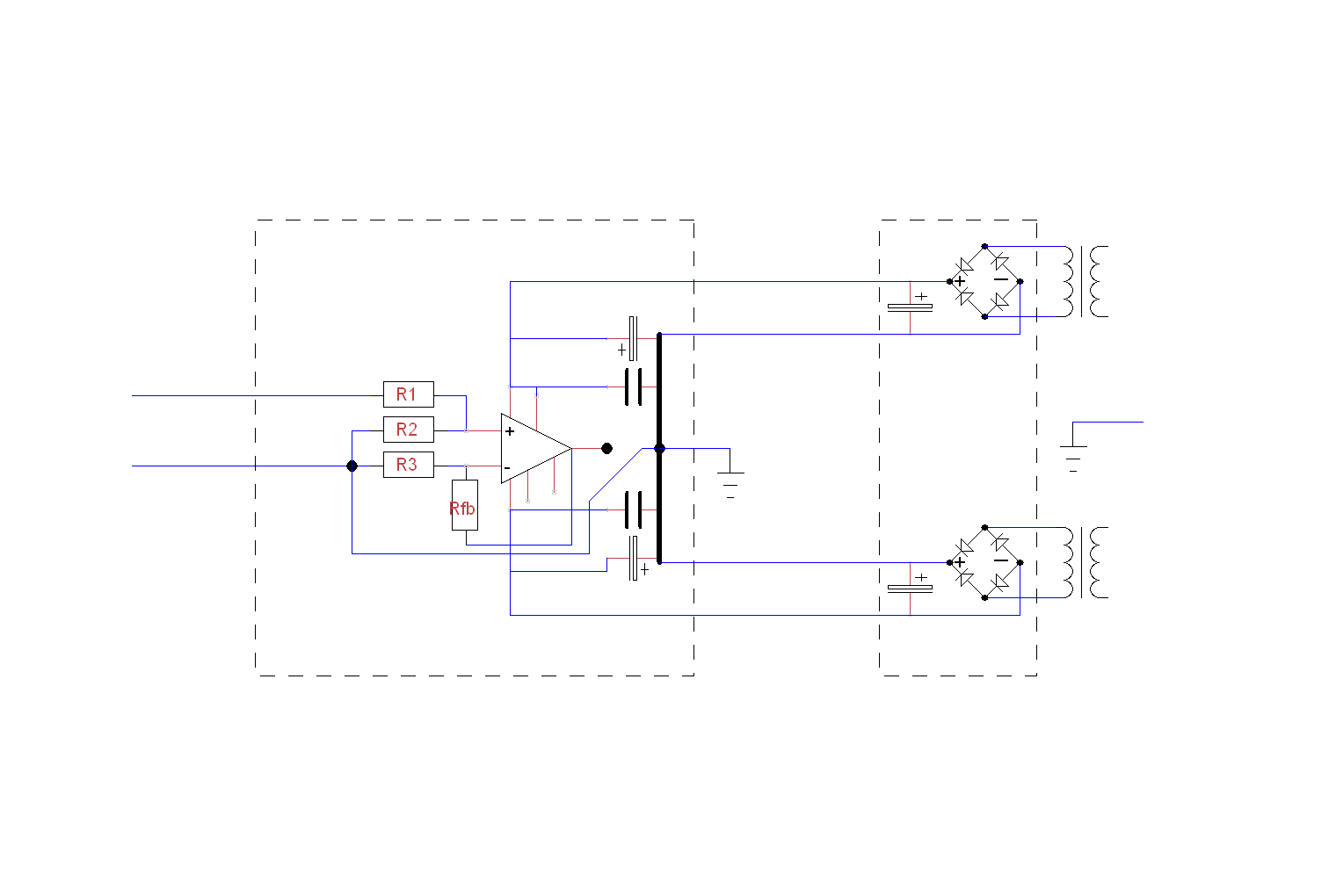

Hal,
post43 shows an arrangement that matches your description.
That is a differential input. The amp reads the difference between the Hot and the Cold and processes (amplifies) that difference
But post43 is not a balanced impedance connection.
Yes, that is the balanced amplifier configuration that I am using, except it is balanced impedance input. The ground connection has been moved to use both inputs.
The input resistors are both 1K Ohm and the feedback and ground resistors are 20K Ohm for a gain of 20.

I checked all the component placement and values and using post #43 as a parts guide, the circuit is correct. The zobel networks are installed as well.
The two film bypass caps across the 1500uF electrolytics in the schematic are not in the kit or on the pc board silk screen, even though there are two solder pads per cap that would work if mounted underneath the pc board.
Will have to try the extra components for stability in the setup.

post43 is not balanced.
The decoupling common connection is effectively at ground.
This is linked to the Cold Input.
This destroys the balanced impedance.

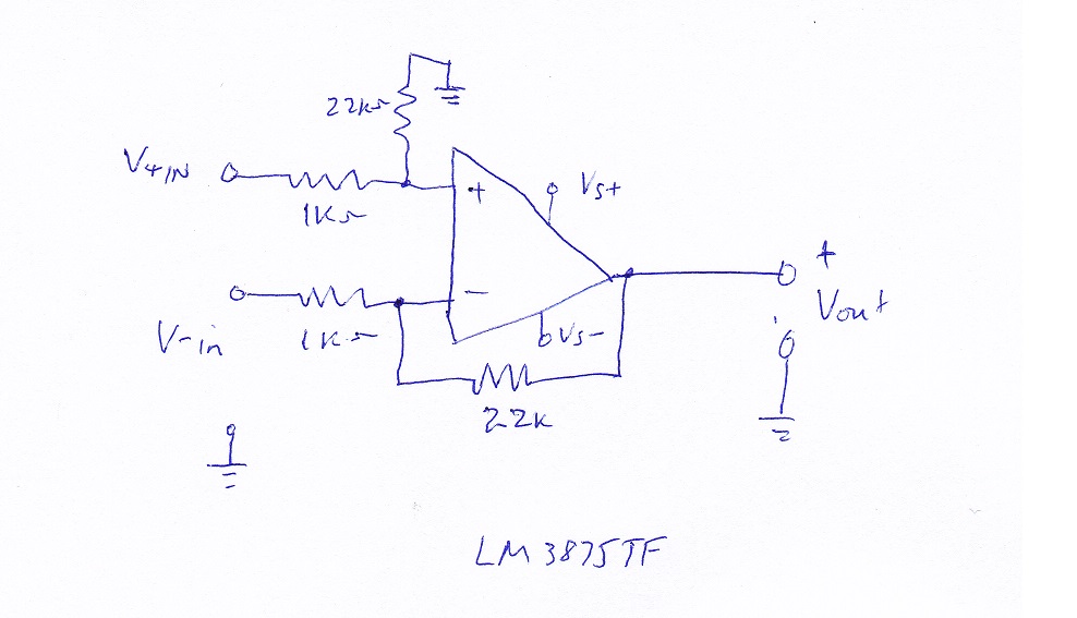

For the circuit I am using, the ground at the junction of R2 and R3 from the schematic in post #43 is removed and R2 and R3 connection separated. R2 is grounded as in the schematic, and the inputs are via R1, +In and R3, -In via 1K Ohm resistors. R2 and Rfb are both the 22K Ohm resistors from the kit. The amp gain should be 22, not 20 as I posted before.
That gives a balanced signal input connection referenced to ground to the differential input circuit.
Not sure what the balanced impedance reference means in this case. The resistance on both inputs should be 23K Ohms.
If your sch is different from post43, then show it.
Without your sch, I cannot see how you can get a balanced impedance input converting to an unbalanced output with just a differential (input) power opamp.
Via the same ground setup as in schematic in #43 for both input and output ground in a +22VDC/-22VDC supply.

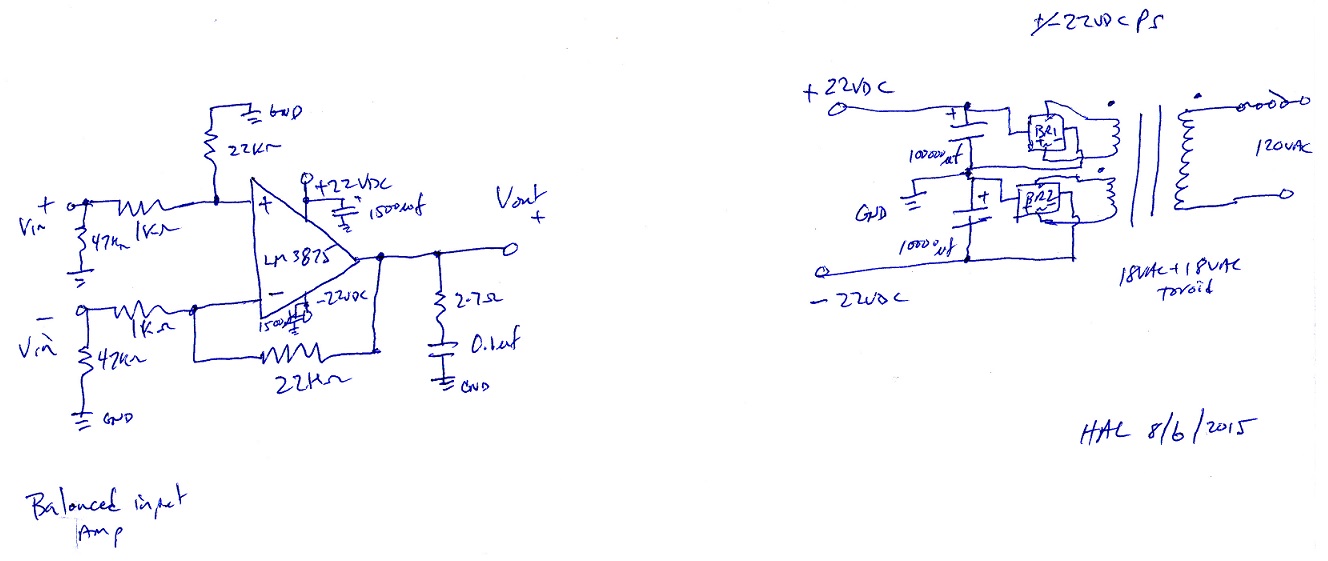

Here is the full schematic.
It is a fully balanced input differential amp, with the balanced input polarities marked.
Power supply is a dual bridge rectifier dual secondary winding dual supply for +/-22VDC input.
Very similar to any opamp circuit for going differential input to singled ended output load. Just a power opamp from the LM3875 schematic.
Did you manage to get this circuit working without the oscillation? I'm also going to experiment with differential inputs but maybe throw in a 600:600 ohm input tx.
