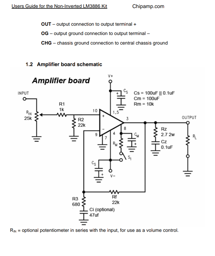

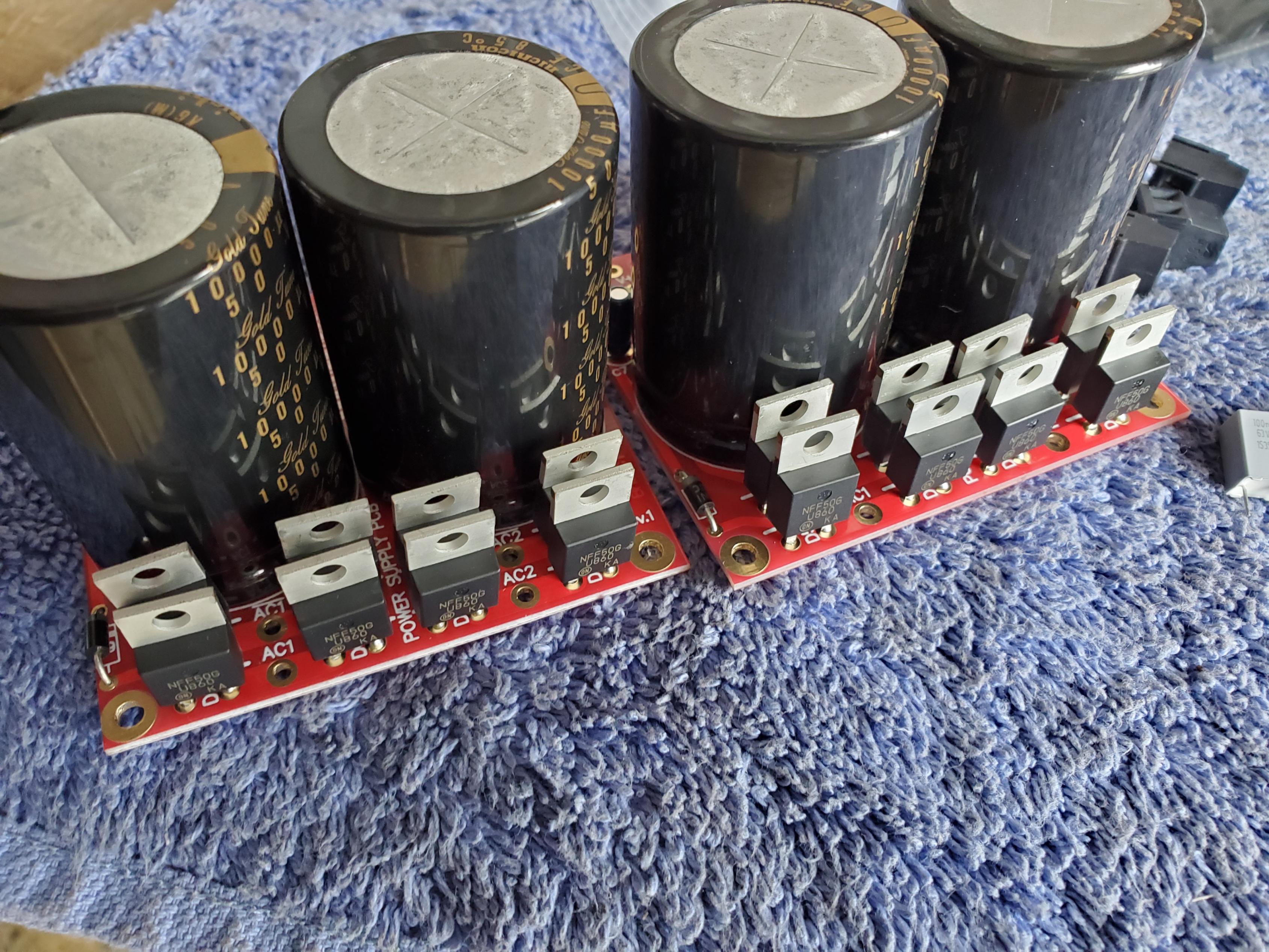

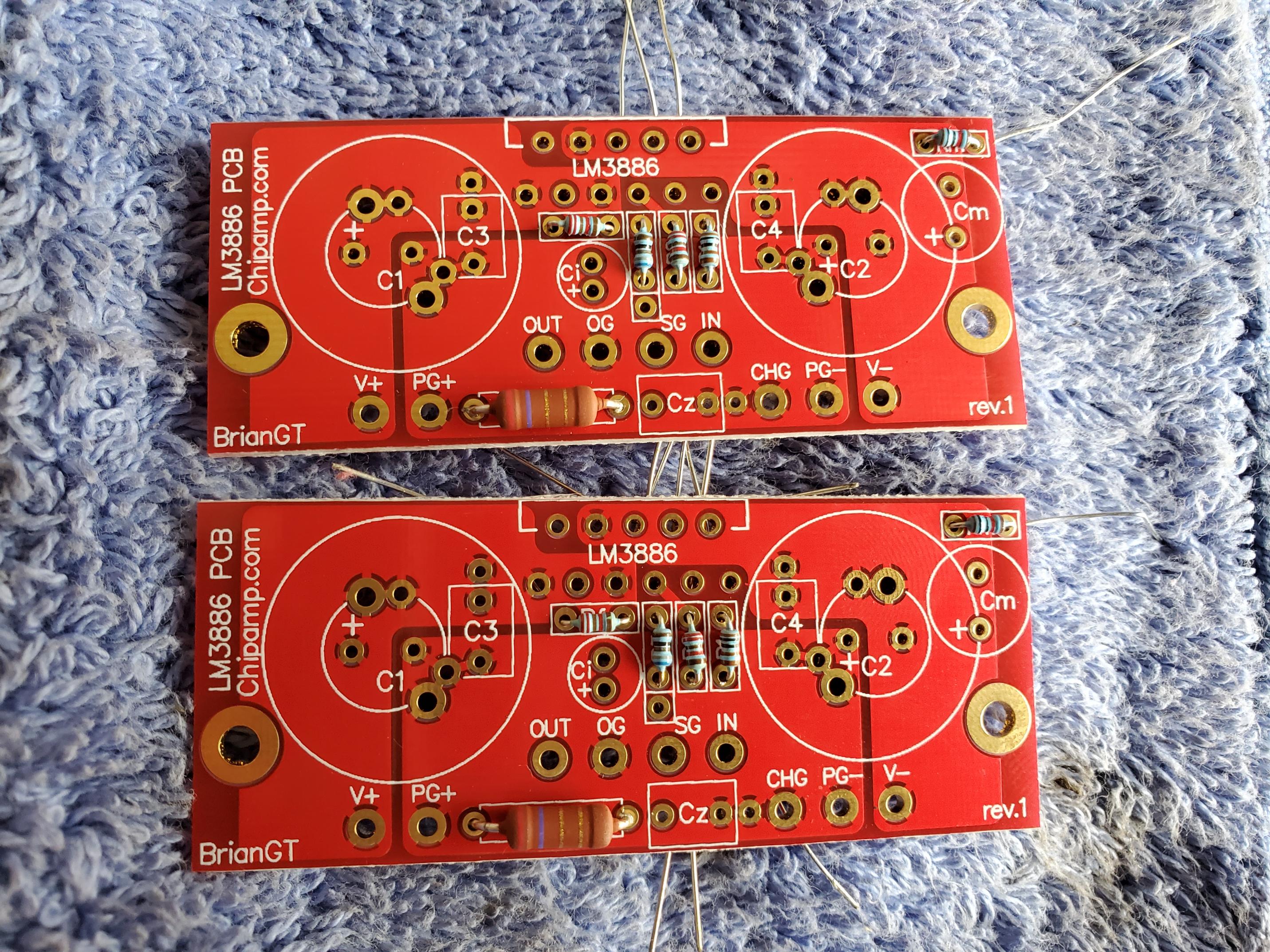

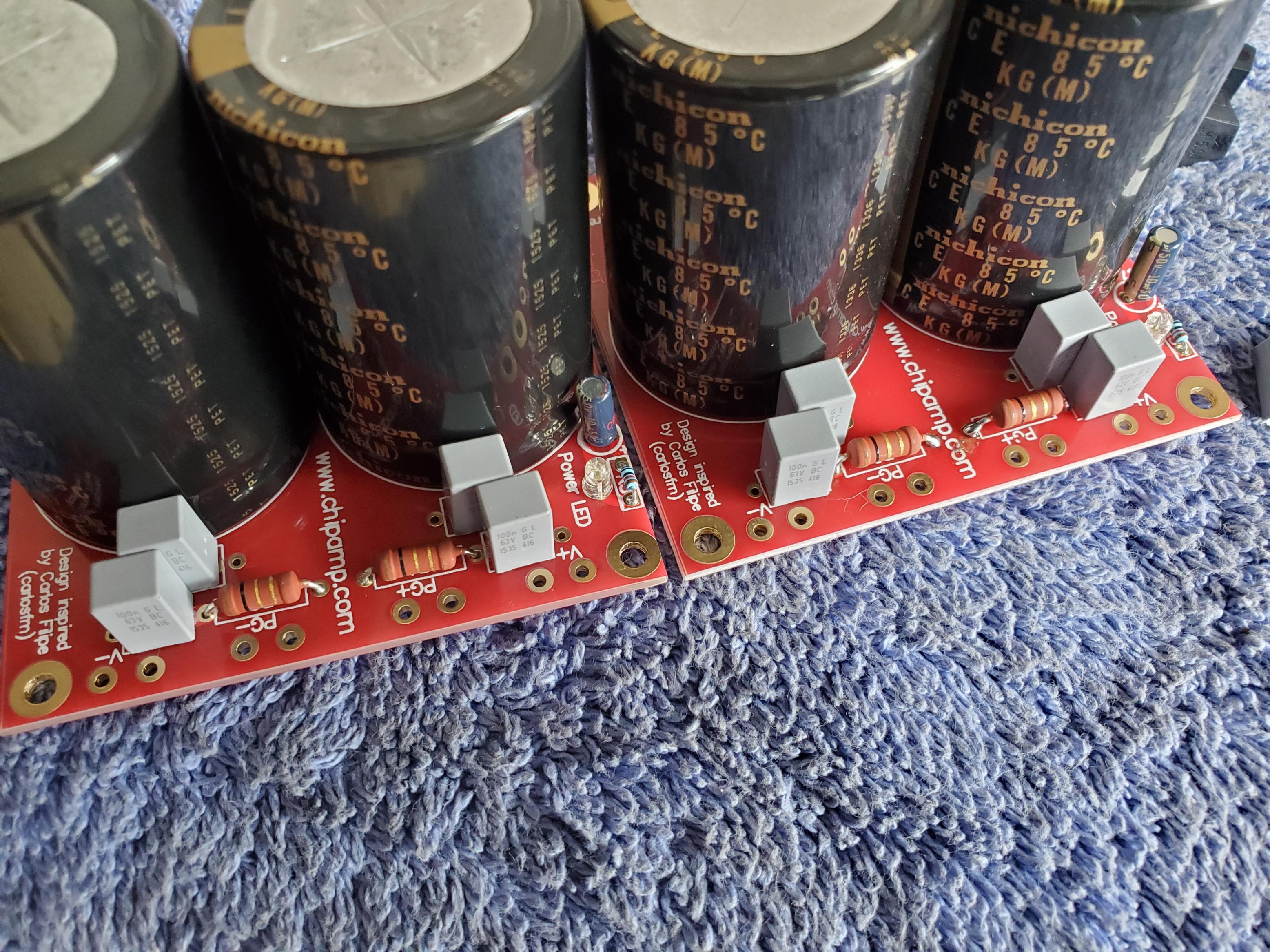

Do the boards/resistors this look right?
I couldn't see the "Rm" resistor in any pics?
Actually I went with the process of elimination on the bottom resistor on the power supply board also, but it was less resistors and they were much easier to see.
Which configuration should I use?:
Feedback capacitor or no feedback capacitor?
Why would I need lower DC offset?
I just want it to be functionally optimum.

Wow, I can see the resistors way better in my pics (especially when zoomed in) than I can with my naked eye.

Everything looks fine! For bleeder 2.2k is quite low, 4.7k-5.6k better. If you can ensure that earlier stage will never have output dc offset than & only then you can skip feedback cap. Also add a low pass RF filtering stage before non-inverting input using 1k resistor & 680pf ceramic. btw are you going to use 35-0-35v transformer? that's dangerous!! :whazzat:
Okay, so I will use the feedback cap.
I don't know what a bleeder is.
I don't know how to add that RF filtering.
I'm using a kit.

1)Check the backside of the PSU boards, upgrade those resistor(bleeder) to 4.7kohm 2watt. But you can leave that as it is.
2)A low pass filter before the non-inv input is a very good idea to filter out RF garbage(radio frequencies). Follow the attachment....solder 680pf ceramic capacitor after R1 & in parallel with R2.
3)For RM use 33kohm resistor & for CM 100uf electrolytic for larger turn on delay.

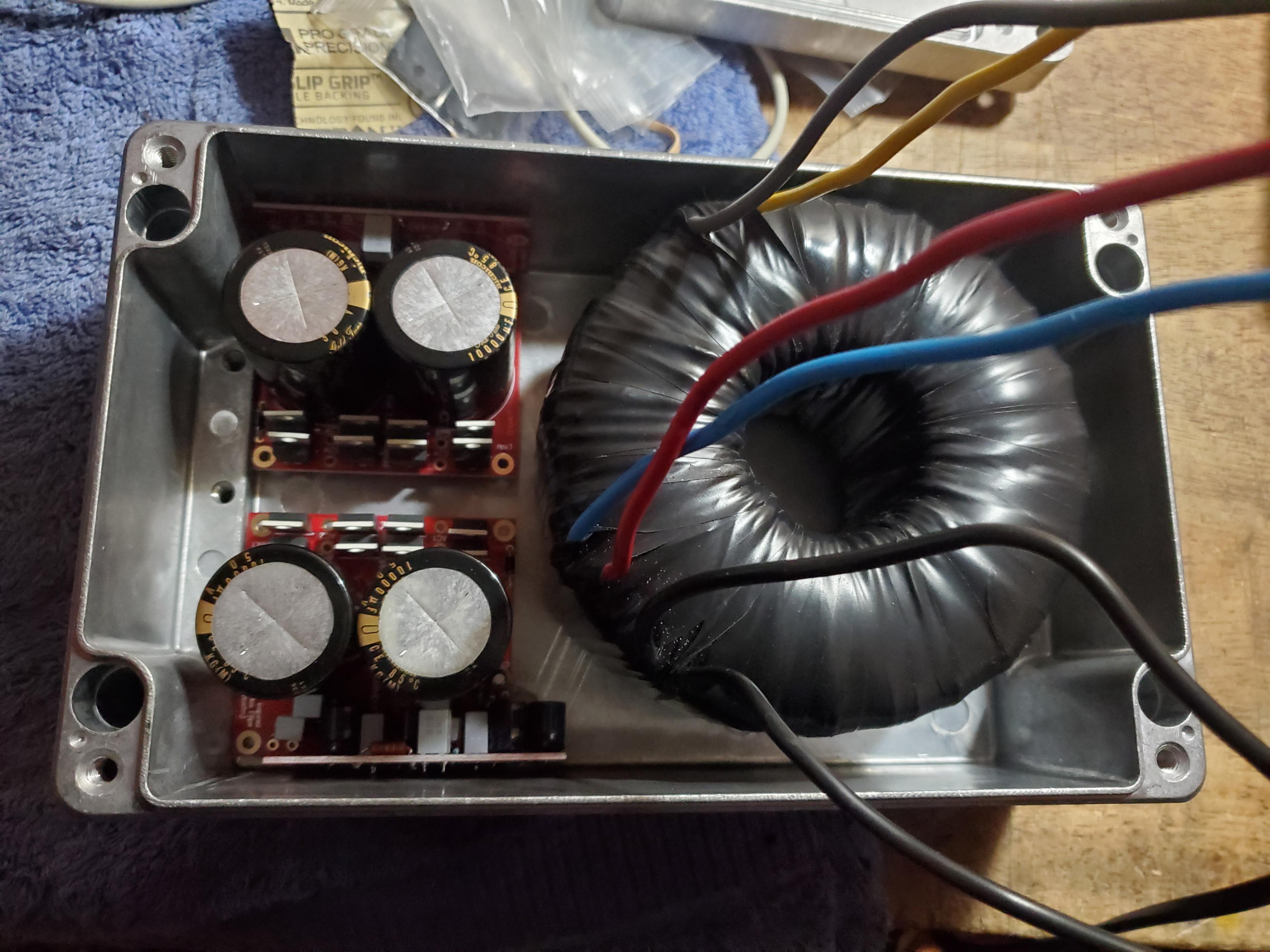

What do you mean by 35v? 17.5v-0-17.5v secondary? You need a CT or dual secondary type transformer for symmetrical PSU. For common load impedances like between 4-8ohm load the recommended transformer voltage is 22-0-22v. Btw for stereo monoblock you need two transformer & two PSU board.

1)Sorry, no more advice from me. Do whatever you wish. 2)For 8ohm nominal load impedance the recommended supply voltage is +/-35vDC & for 4ohm load +/-30vDC Max.
Thank you for the help.
From reading I got this:
35v the the boards for 8 ohm (nominal impedance I assume?)
28-28.5v is what I read for 4 ohm (nominal impedance I assume?)
But some people do 18v some do 25v.
Some one made the argument of 18v because: what good is an amp that does 68watt at 8 ohm if you cannot run 4ohm speaker on it? Which I kind of agree with. Also he said: don't strain the chip , which I also like.
The PDF states 18v-22v for the tranformer.
I have 4 ohm tweeter, 8 ohm mid and 8 ohm 10" woofer Dayton RS270S for now.
From reading on the DIY audio forum, 10-20 people said it was okay to unwind a transformer.
1-2 people said don't do it.
One guy stated something about leakage, etc. if you unwind.
