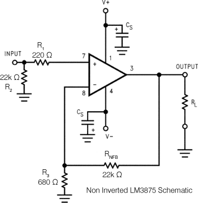

Hi everyone,
I'm having problems getting my 1st gainclone to work,
I am using the "vikash" non inverted diagram.
( I will try to attach it)
R1 =22k (pin 3 to pin 8)
R2 = 680 ohm ( pin 8)
R3 = 220 ohm ( pin 7 to sig in)
R4 = 22k (bridging + & - on sig input)
I am not using any caps on the power in to the chip, as i have a separate 25v psu, ( built for Naim hi-fi) which is suplying an allready smoothed + & - 25v dc. (going to pin 1 & pin 4)

Then I thought, connect the - 25v from "Naim" to the groundstar point of the amp, I got a thump from the speakers, and thought,
great, job sorted,
but i was wrong.
I then realized the speaker cone was extended as far as it would go. I switched it off, disconected the speakers and On closer inspection found 24v to be coming out of the speaker terminals !
I dont think that is supposed to happen,
I have stood and looked at it for hours, and can see nothing wrong.
I have even built the second one up and got the same result.
The chips are of the un-insulated type using mica pads, and sleeved washers between them and the heatsink.
I think the problem might lie in the groundstar thingy, I don't think I fully understand it, but I have the neg from the supply going to the groundstar point, for which i am using the heatsink.
The more I think about this the more wrong it seems.
I hope some kind soul could explain to a novice Gainclone virgin, where I am going wrong.
The power supply for your Gainclone must have a positive voltage rail, a negative voltage rail, and a zero volt rail. The ground points are at zero volts, NOT plus or minus 25 volts! :att'n:
Double check your wiring and as has been said above, always measure the DC output at the speaker terminals before you even connect a test speaker! 😉

Hi STobsy, to test the amp, get 8Ohms 5W resistors across the amp o/p terminals. measure and make sure the DC offset is not too high (not more than 100mV!!).
Measure to see if the tab of the chip is shorted to chassis ground for your case.
