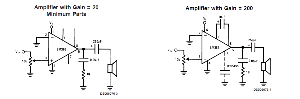

i built myself an amplifier for a speaker (4ohms, 5 watts) using LM386, according to the schematic in the datasheet (attached to post), with gain 20.the problem is that as soon as i turn it on, it oscillates.when the input pot is at the lowest level, i can just hear the music playing on the speaker (using ipod for signal into amplifier).it oscillates all the way to max volume through pot on the amplifier.also, inplace of the 0.05microfarad cap, i used a .1microfarad cap as it wasnt available.rest of the circuit is same.
i even changed the gain to 200, connecting a cap between pin 1 and 8, and then adding a bypass cap between pin 7 and ground, intrestingly, the pot, when moved by a very small amount, doesnt produce oscillations now.above the certain value, again oscillations.

It could be a layout/wiring problem. Ideally the loudspeaker wires should be twisted together, the power supply wires should be twisted together, the input signal should use screened cable, and the loudspeaker wires should be kept away from the input signal wiring.
It might also help to have a capacitor between pins 4 and 6 close to the chip, to decouple the supply rail to ground.
btw: Using 0.1uF instead of 0.05uF is fine.

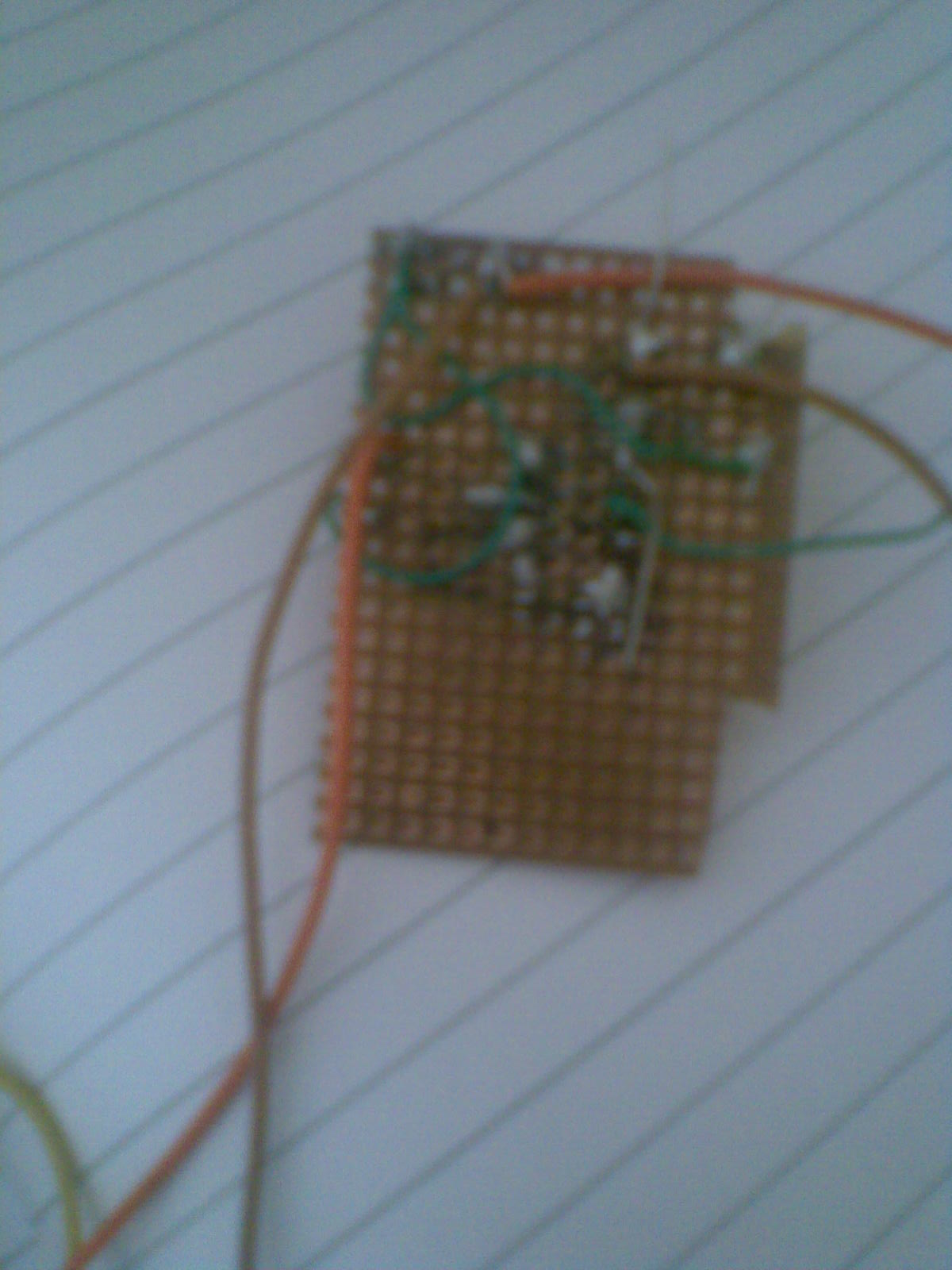

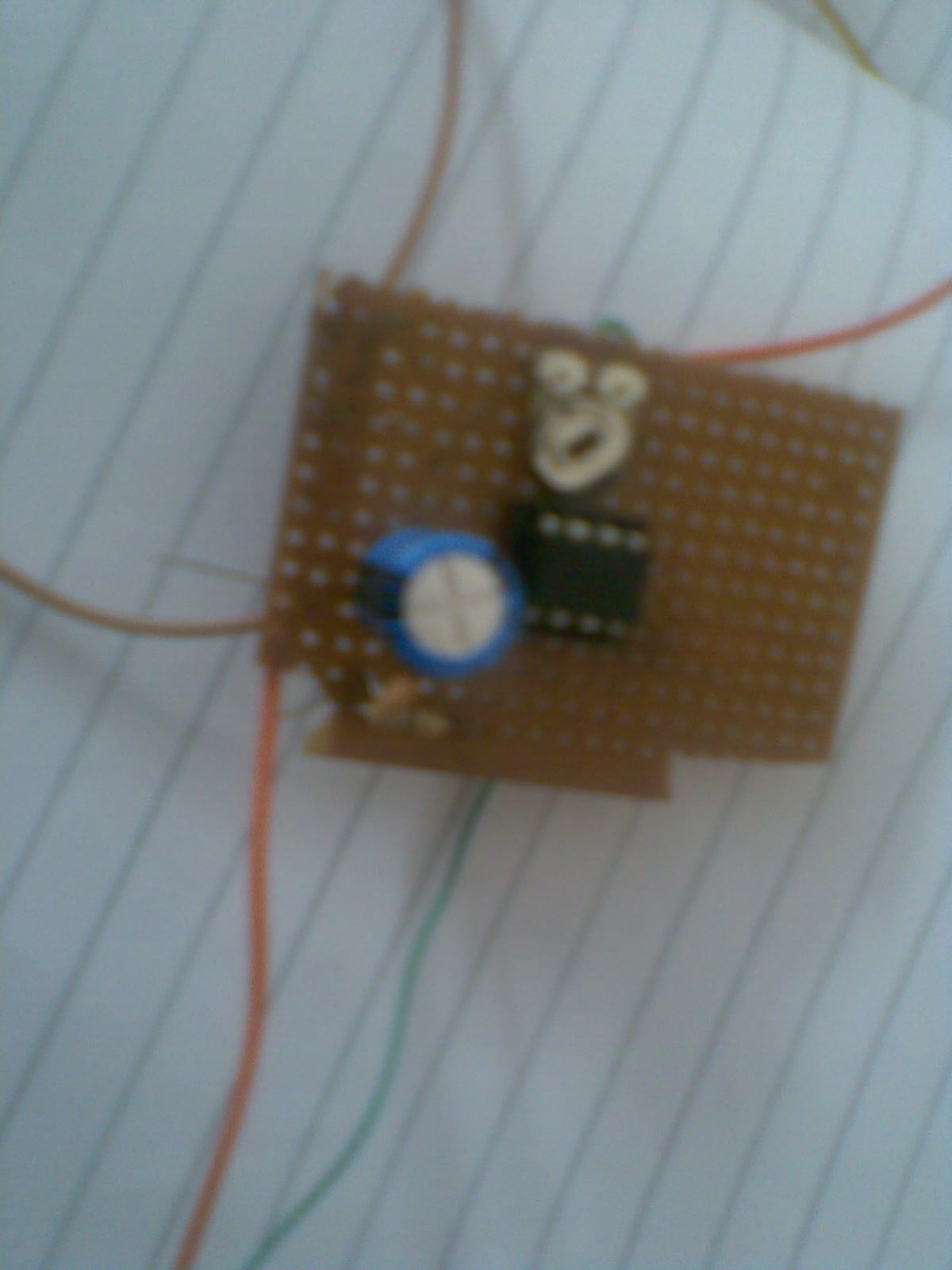

its working totally fine with the headphones (no oscillation, no distortion, awesome bass on the HD212 Pros, super-awesome), cool results, the speaker i was previously using was 4ohms 5 watts, my headphones are working cool.my layout is still crappy, but its working fine.am thinking of extending it to stereo input + output. just that there is a little noise i'd not want to have.
i've attached the pics bonsai, but the circuit's now working fine. thanks for ur support guys...

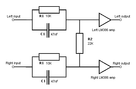

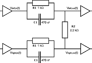

also, would a crossover work well with this lm386 setup??? schematic attached
That looks like a "blend" circuit for headphones, not a crossover. It should work fine. You could use an opamp or emitter follower on the left and LM386 on the right. Actually, if you make the resistors 10 times bigger and the capacitors 10 times smaller, you don't need anything on the left.
