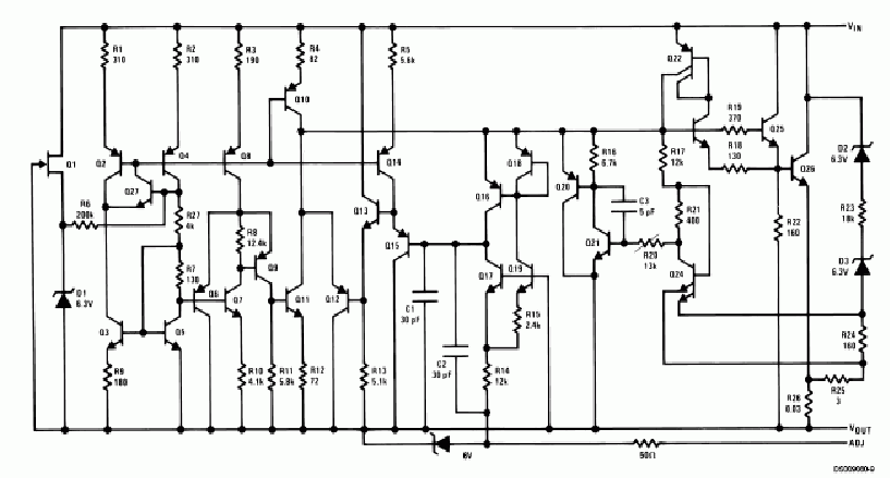

lineup said:Cant 30 VDC be made
in a more simple way,
than using 27 Transistors ?
This is the number inside LM388.
See schematic - and this is a simplified diagram!
You can say that for most linear regs.
It has 3 legs to the outside world, it's fairly cheap, very reliable, and good performance.

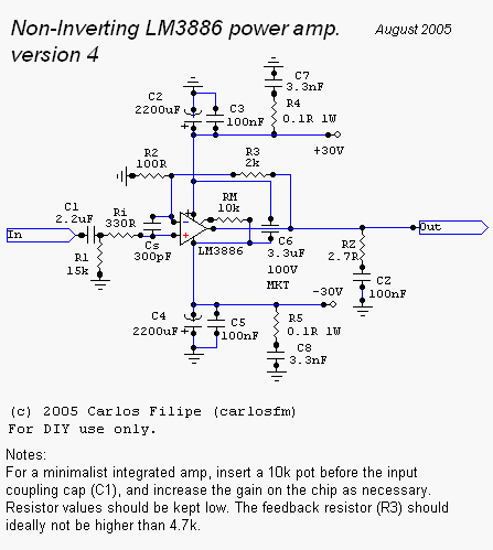

@ carlosfm
Thanks for the schematic. I've just etched a PCB for your regPSU (basing on the Eagle file kindly shared by Tobias) and I'm now trying to figure out which parts I'll have to order.

In revision 1.1, I found the 0.47R resistor and the 47nF cap in the schematic and thought (erroneously?) that these were the parts that you mentioned in the text. In revision 1.2, the schematic stayed unchanged, but the values in the text have changed. Does that mean that the parts in the schematic and the parts mentioned in the text are not identical and that I have to add another R and C on the GC board?
I must admit that I'm a bit confused as to which part goes where.
Where do I place the 3.3µF from V+ to V- pins? Which pins?

jpg said:Where do I place the 3.3µF from V+ to V- pins? Which pins?
Seems like your are watching only one part of the movie.
Here's the amp.
Yes, there are snubbers on the amp board too, and the 3.3uF film cap goes between the voltage rails (V+ to V-).
