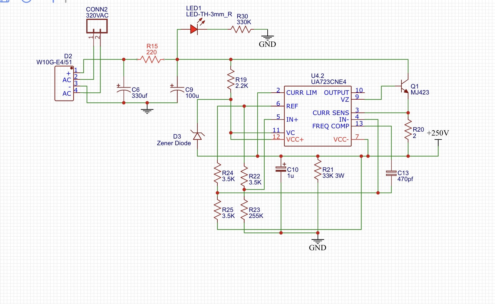

Ive used Maida setups before with the 317, they work ok, but I like this one much better, I would use a 36V zener to power the 723, if you put about 5uf cap on the voltage divider coming off the Vref, this will cut down the ripple to about a 2 microvolts, but since Im using this on a line stage, 20 microvolts is plenty quiet. I know HV TO-3's are kind of expensive, I was able to find a source for the MJ423's, I like using these packages.

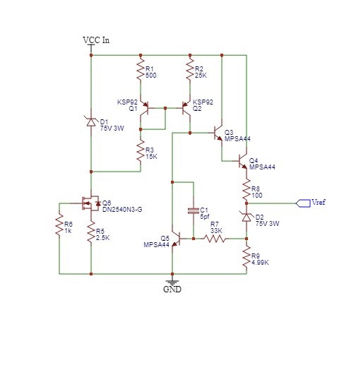

Here is my version of the VR amplifer found in the 723, this one simulates well in B2 Spice. the Vref is 75VDC. It may need some tweeking. This could be done on 1"x2" board added to an existing HV power supply, or incorporated into new design.
