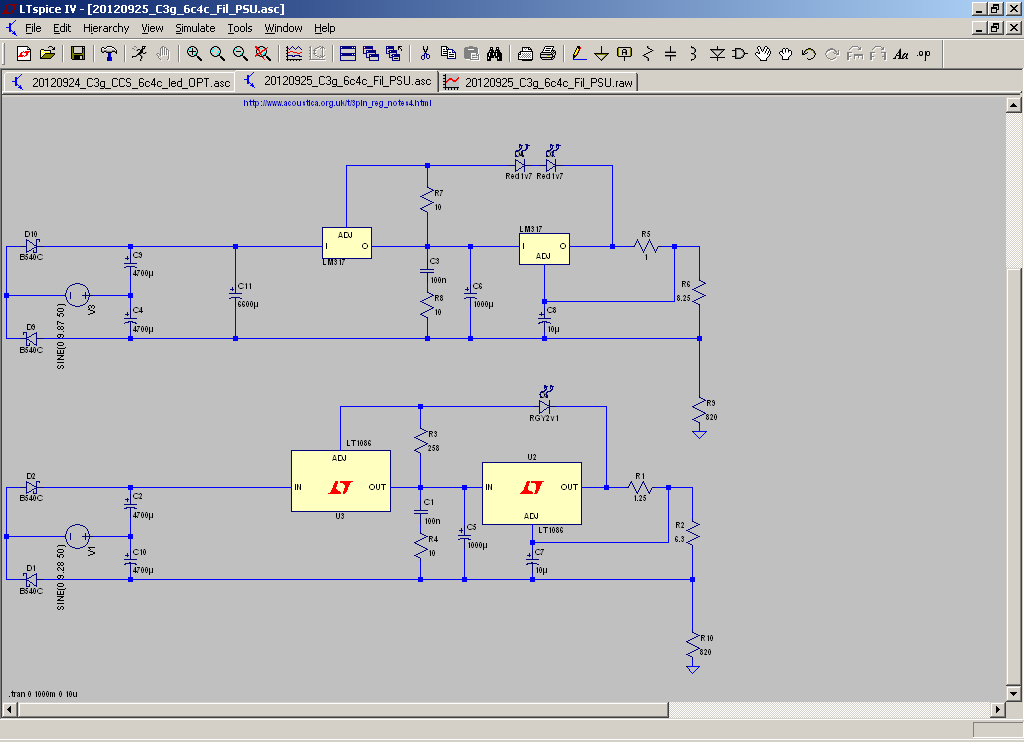

Four 10mF/25V caps added. B540 replaced with Schottky PBYR1025 in TO220 to save space - a bit hot. Vripple = 0.7mV rms @ 9.2 ohm load
Yet, there is a difference between attached schematic and tested circuit, i.e. values were measured with one LED setting reg2 voltage. Need to add another one.

Note 2 LEDs at left - seems they have different specs. Brightness and voltage drop are different, 1.9V and 1.6V.
what is your voltage drop across the regs? The LM317 performs best with at least 5V in to out difference 🙂 if you don't have 10V to drop then make the voltage drop on the second one higher, making sure to at least have more than the drop out voltage on the first one 🙂 (unless of course it doesn't matter in this configuration which I have not tried).

Voltage drop across current reg is 3.5V+1.24V across 1.22 ohm resistor+6.1V across filament equals 12.84V. So there is roughly 6V drop across TPR.

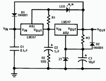

Tracking pre regulator LM317, LM337 with highly denoiser.

You may use LM317HV, LM337HV .
VD7, VD12 is a LED with 2.8 ... 3.2 Volts across.
