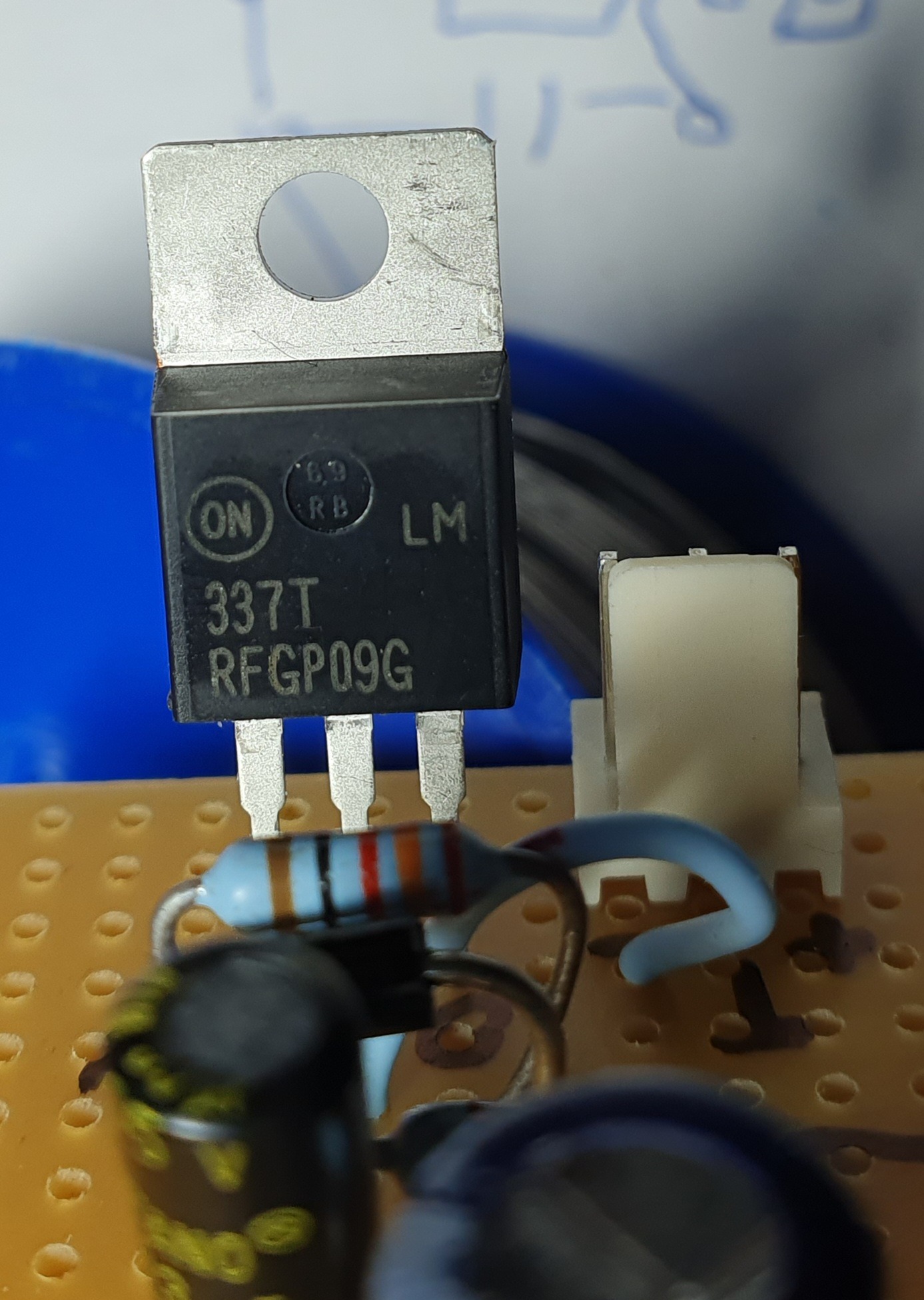

I just wired up an LM337T for regulating -15 V. Input voltage is -20 V. The adjust resistor is 240 ohms, the R1 is 2.7k. I have 100 uF at the output and 33 uF at the adjust. The issue is it does not regulate, the output voltage is more than 18 V. This is at unloaded condition, do I reduce the adjust resistor, or just add some load? How much mA?

1k8 did not help. I suspect a fake LM337.

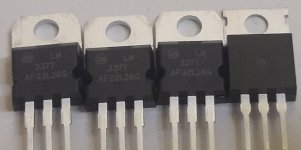

Unfortunately, I myself have come across fake LM337s recently (source: kontel.hu) 3pcs ONsemi fake, "f" (Fairchild?) Is original/works
