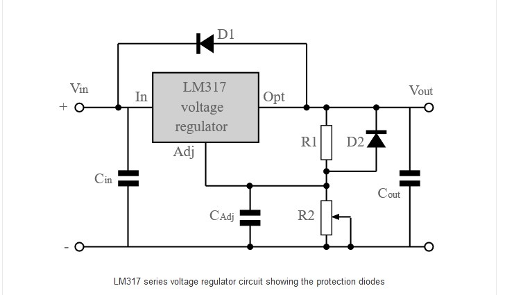

The path to the ultimate LM317 is well trodden with the VRDN, the D-Noizator, etc. Inspired by Pa's F5m I'm going
to ponder and post a minimum LM317 that has maximum performance with a minimum number of parts. Perhaps ten?

The low-parts-count implementations work great.
CRCRC the raw supply and the regulator will have barely any noise to deal with. The best improvements I've gotten have been with better passive filtration.

Diodes D1 and D2 are only needed for high input and output voltages to prevent reverse breakdown if the input or output is suddenly shorted.

Say for a preamp, or phone stage, or similar element with a low current draw you can use R=10 ohms, and your reservoir caps have an ESR around 0.1 ohms. The maximum attenuation you will get from the RC element is 40dB - a really useful amount ahead of a regulator, or for many other purposes.The low-parts-count implementations work great.

D1 and D2 are recommended to protect the regulator from the effects of stored charge in C1 and C2 at switch-off,Diodes D1 and D2 are only needed for high input and output voltages to prevent reverse breakdown if the input or output is suddenly shorted.

Not only recommended. They're likely required.D1 and D2 are recommended to protect the regulator from the effects of stored charge in C1 and C2 at switch-off,
You don't have to use C2. Its purpose in life is to reduce noise, which is nice, but not always required. If you skip C2 you can eliminate D2 as well.

LM 317 circuit with external protection diodes
When there is capacitance present in a circuit driven by a voltage regulator such as an LM317, either directly on the output of the regulator or within the circuit being driven, it is often wise to add protection diodes to prevent the capacitors from discharging through low current points into the regulator.
Protection diodes are recommended for output voltages in excess of 25 V or when high values of capacitance appear on the output of the regulator. It is often recommended that for capacitance values in excess 25 µF and when the values for CAdj exceed 10 µF).
In the circuit the diode D1 prevents the overall capacitance on the output from discharging through the IC during an input short circuit. The output capacitance consists of COut plus any capacitance in the circuit being powered. Although an input short circuit may appear unlikely, the path through any input circuitry may appear as a short circuit under some conditions.
Also the diode D2 protects against the capacitor CAdjj discharging through the IC during an output short circuit.
Finally, the combination of both diodes prevent CAdj from discharging through the IC during an input short circuit.
The diodes, D1 and D2 need not be any special form of diode - diodes such as the 1N4002 have sufficient current capability and reverse breakdown capability to provide excellent protection. 1N4002s are also very cheap and widely available.
Without C2, with a big capacitor at the input, with nothing but the LM317 loading that capacitor, with nothing forcing current into the output and without sudden short circuits at the input, you can do without the diodes. The input voltage then comes up faster at start-up and drops slower at power-down than the output voltage, so the voltage difference always has the right sign.

Even a 7812 can fail without D1 if there is a large output capacitor and the input can be shorted. How this could happen is for your risk analysis.Not only recommended. They're likely required.

Any value of CAdj in excess of a few uF will interfere with the regulator’s transient response.LM 317 circuit with external protection diodes
COut needs some ESR for stability. Tants not recommended
