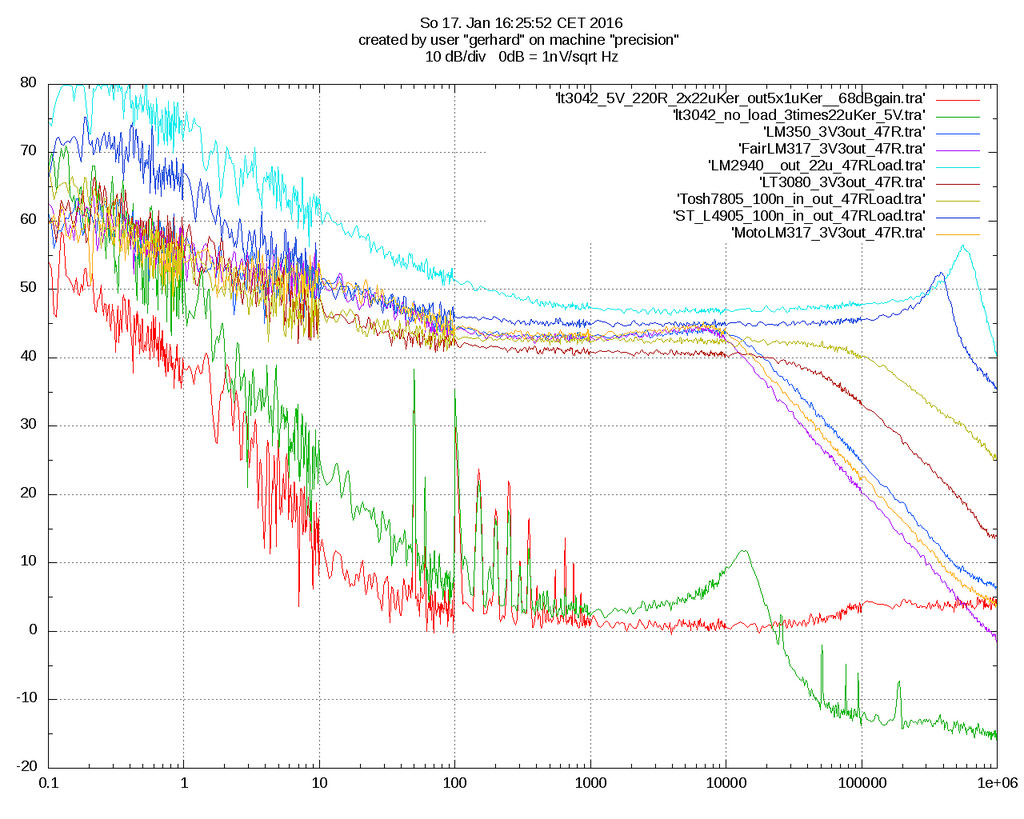

If we accept that 1k has about 4nV/sqrtHz at ~room temperature, then a 0r33 has about 0.07nV/sqrtHz
I can't get my head around the increase in noise shown in Jackinnj plots.
Oh! he has added new plots !!! Has the noise changed since last night?
That is much better in line with my own LM317/LM350 measurements.
Something like 43 dB above 1nV/rt Hz in the data sheet circuit
as proposed for each type. The noise also depends on the output voltage.
If you add a series of 0R33 and 10mF across the, say, 100mOhms
regulator output impedance, you change exactly nothing on a logarithmic
plot.
I assume that the first plot was without the ref decoupling. I wanted
to comment on it 2nite, that there was a 20 dB difference to my measurements,
but I was somehow irritated since I didn't scroll up enough.
The first set had no capacitor across the ADJ pin, the second set had 470uF Panasonic FC.
I also repeated the measurements several times and RMS'd the values -- when you measure noise you also have to pick a quiet time of day.

Clearly a huge electro part wont compare down low and is becoming useless at mid to high band audio, right?.
I disagree. Compare the inductance of a large cap with a 317.
317s and other semiconductor, high NFB chips have some serious limitations. We haven’t covered all of them in this thread. Synthetic voltage sources are very useful though: you benefit from small size and cost and you get bandwidth down to dc. Great for a mobile phone, for instance.
I think if you make some estimates or bench measurements you’ll change your view about capacitor performance vs a 317.
You are welcome to take your own measurements to see if giant electro capacitors can add significant additional ripple or noise suppression placed in parallel on the output of a LM317. You can see this at a glance if you overlay a caps impedance on the 317 output impedance chart. Remember that idea? I highly recommend it. It's not a view point, infact it's pretty well known in SMPS design circles large sized caps make for very poor bypassing or filtering! I choose to use small valued RLC filters ( using existing or added bypassing at the load end ) if I need extra filtering at higher frequencies when loop gain is decreasing. Usually not necessary in conventional AC linear supplies. Strangely this thread has circled back on itself a few times already, I suggest you to re-read Gerhard's last post, it's a good summary of the salient points I and others have made already.

Give me some numbers. What is the parasitic L of a 10mF cap and what is it for a 317?
I don't want to, really. I have burnt the input of my SNA-33 spectrum analyzer
(20 Hz to 33 GHz with 1 Hz resolution) with a completely unimportant AF measurement,
no intent to repeat that with the VNA. Those large capacitors are dangerous.
For the LM317 you can estimate it from the output capacitor value and the
frequency of the noise peak. But the capacitor Heisenbergs the regulator,
I have no idea how far one can deviate from the circuit that was used to
measure the sample.
For the capacitor, all bets are off. I put an Cornell-Dubilier 10000uF/35V
on the HP 4274A multi frequency bridge, the results were completely
different for every frequency I tried. There are resonances going on, but the
absolute numbers were quite OK. I won't connect that thing to the vector
network analyzer. But it has exactly 9000uF in real life.
