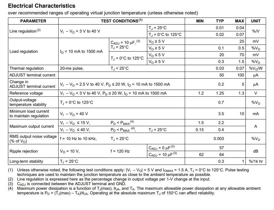

And the 19 V of the adapter is then regulated to many different voltages inside the laptop.Don't over think it. The regulation at the point of use, i.e. the laptop will be much worse than that because of the resistance of the lead, the plug/socket and the PCB print in the laptop. All those will swamp the regulation of the power supply output itself.
