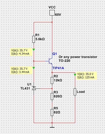

Yes I found the TL783 when looking for options. I need a +- supply though so did not look into it further but maybe it would work stacking them like one would do with batteries.Use TL783. Good till 125V.
Also you can use it as pre-reg from 60 to 38V then use TL431.
Pdis TL431 would be (38-35)*50mA = 150mW.
Pdis TL783 would be (60-38)*50mA = 1100mW.![]()

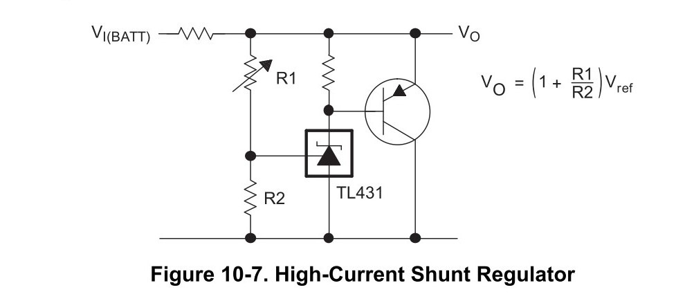

Thanks Lineup, subjectively I have always preferred a shunted supply based on the TL431. I have a few PNP 2N2905 since before that might work boosting the TL431 as per the data sheet.
Not sure I will retain the sonic signature of the TL431 though.
The idea now would be to use the 317/337 as pre regulators and then use the TL431 to decouple these and do the last few volts of regulation.
I'll do some listening and measurement tests with the 317/337 over the weekend and we'll see if I think I need to add a shunt regulator.
