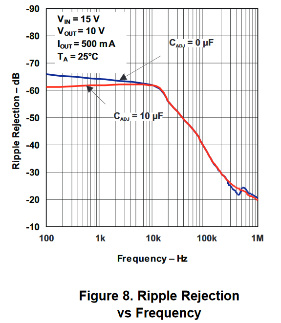

I'm also very curious about adding ADJ pin bypasses (C9, C12, C15 and C16 mentioned before), article in Acoustica omits them or maybe just forget to put them in schematic?

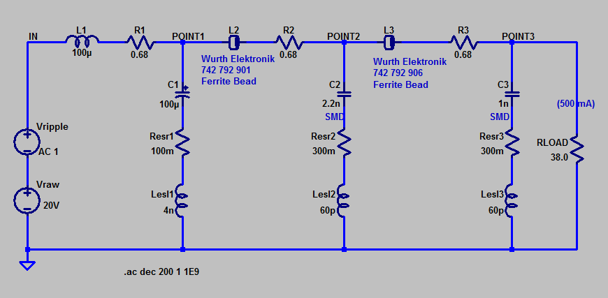

It attenuates mains-borne RF noise quite nicely in my opinion, starting at a frequency well below the knee in the LM317's rejection curve.

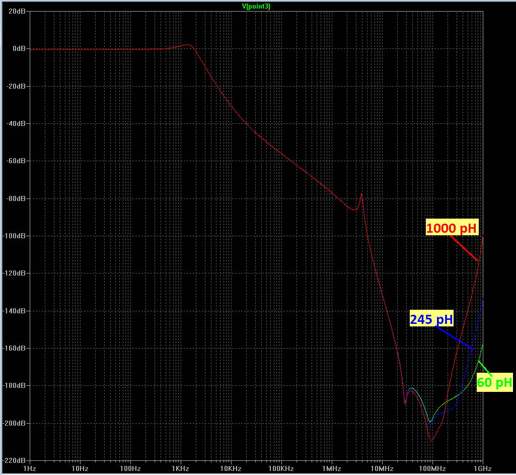

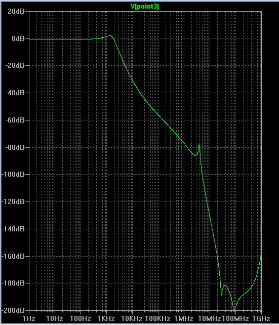

Which capacitor (2.2nF) did you find with 60pH of ESL? I went over to TDK's website and checked out an X5R 2.2nF in what I figured was the smallest possible package (0201) and its SRF is about 150MHz indicating somewhat higher than 60pH ESL.
I calculated it from a 680 pF SMD capacitor's Z-vs-f curve, then assumed a 2200pF cap would have similar inductance. Maybe I muffed the calculation.
