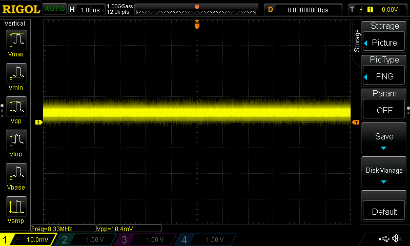

What does the scope show when the probe is directly shorted to ground (clip the ground pin on the probe).
check if the setting of the probe is set to 10k (normaly a smal switch on the probe) and the setting on the scope at the correct channel with 10x too.

This one I've checked. 10x is set correctly both on the probe and on the scope.
Here's image of what it shows when shorted. Peak to peak voltage is fluctuating from 10mV to 15mV
What's the bandwidth of the scope? >88 MHz? 🙂
I the past two places I've lived, I was able to pick up about 20 mVpp of FM radio on a 400 MHz scope with a scope probe shorted to itself. The signal is picked up by the ground lead usually.
You can try a couple of things: Twirl the ground lead around the scope probe as tightly as you can. Connect the ground clip to the probe tip. This minimizes the loop area, thus the inductive pickup of RF. If this lowers the noise level, you're dealing with inductive pickup. Do your best to minimize the loop area when you take your measurements.
Engage the bandwidth limiter on your scope. If your scope has a bandwidth of 100 MHz or higher, you'll probably have a button you can push to limit the scope bandwidth (thereby the noise bandwidth) to something more reasonable - like 20 MHz.
If none of those work, use a shorting BNC plug (or 50 Ω BNC terminator) to short the input on the scope. If this causes the noise to drop, you have an issue with the probe. If shorting the scope input does not lower the noise, the front-end of the scope is noisy.

Tried measuring in on and off state. Not much changes in on and off state and during capacitors discharge. Here are images of these two measurements. First is in on state and second is in off state.
If the plots look practically the same with supply on and off (with capacitors empty), then I wouldn't worry about it. Apparently it's some interference picked up by the supply wiring.

Marcel, I own a scope just like the one whose screen capture image is attached to post #1. Its probes (Rigol P/N RP3300) are 10X, and according to the datasheet, the probe bandwidth is DC to 350 MHz. Input resistance is 10 megohms ±2% and input capacitance is 16pF ±5pF.
Original poster "belyakove" confirmed in post #25 that both the probe and the scope vertical amplifier menu, were set to 10X.
Since 16mV was observed across a 1K resistor, and 16 mV is much greater than the theoretical prediction, we conclude that the displayed noise is greater than the actual noise. Perhaps due to excessive area in the probetip-to-ground current loop. Setting the Bandwidth Limit switch to 20 MHz would help somewhat.
