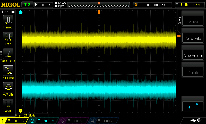

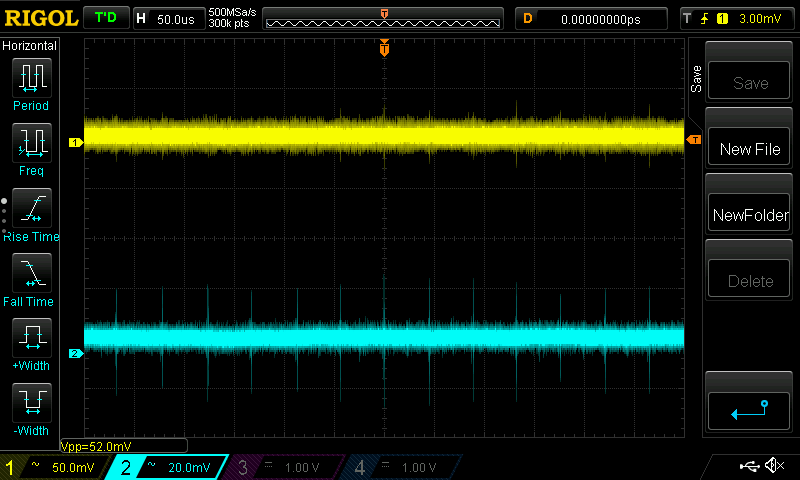

Hello. Probably my question is very newbie but I didn't find answer anywhere else. I've recently got my first oscilloscope and tried to measure output of my dual rail +/- 12V regulated power supply that I use for preamplifier that I'm building. Power supply is built on standard LM317/337 regulators. I've attached picture of what I see on oscilloscope and want to understand what it means.
As I understand I see around of 40mV of fluctuation (high frequency).
I don't really understand what it is ripple, noise or oscillation and if it's ok. Can you please help me with that?

It might be your scope probe and its ground lead. To learn more, disconnect your probe from the power supply and instead use it to measure the voltage of a 1K resistor. Ground clip goes to one end of the resistor, scope probe goes to the other end of the resistor. Leave the vertical sensitivity at 20 mV per division. If your measurement apparatus were noise-free, we'd expect to see about 80 microvolts of thermal noise from a 1K resistor. But instead if you see the same 40 millivolts, yet it's not connected to a power supply at all, then you can be confident the 40mV is not coming from the LM317/LM337 ... it's coming from your measurement setup.
Then you've found a better datasheet than I have. Anyway, does the ripple or whatever it may be disappear when you pull the mains plug of the power supply and if so, does it disappear immediately or after the reservoir caps have discharged?

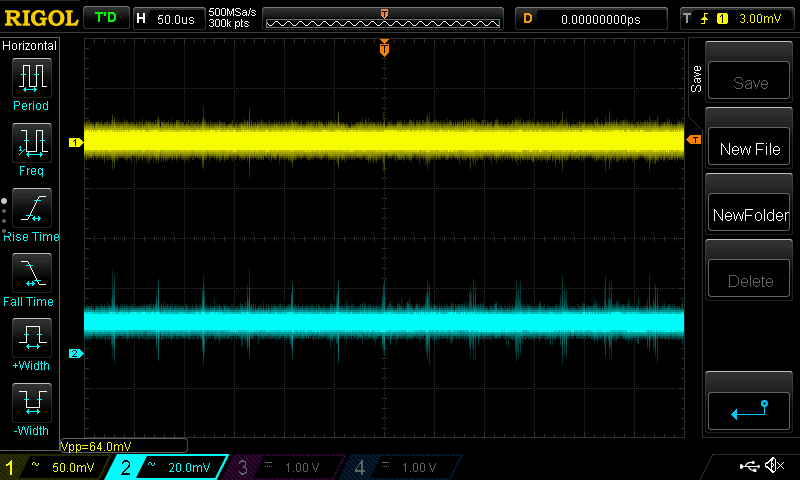

Tried measuring in on and off state. Not much changes in on and off state and during capacitors discharge. Here are images of these two measurements. First is in on state and second is in off state.

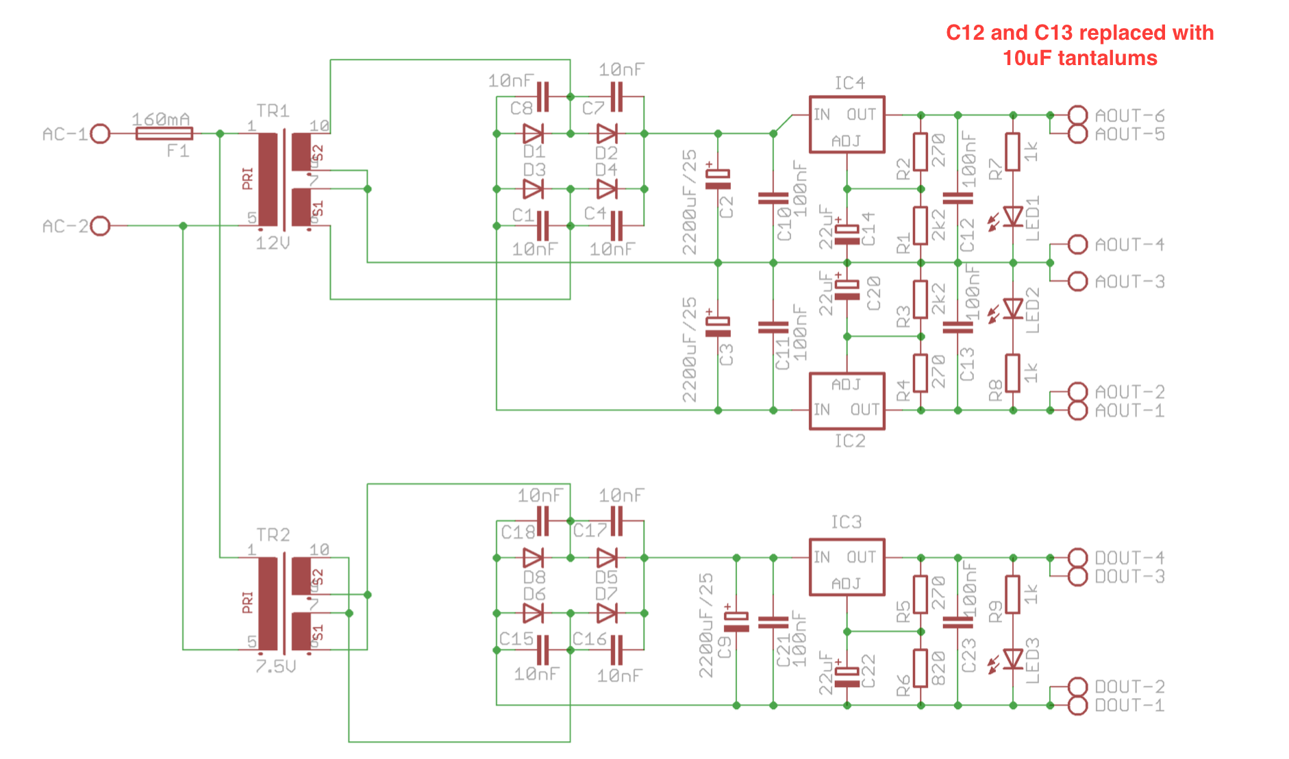

Here are the schematics. As mentioned on it, 100nF output caps were replaced with 10uF tantalum.
It is PSU producing +/- 12V and +5V for micro controller. but for now I'm measuring only 12V part

I saw a study that recommended a load for three-pin regulators of 220uF, with ~100mΩ ESR; also 220uF across the voltage adjustment resistor. This provided the best noise and ripple characteristics. Also note that the Linear Technology LT317/337 regulators have definitely better datasheet specs than the typical T.I. LM317/337s----about 16db better ripple rejection and about 10db less noise. They're more expensive---about $2.50 each, while T.I.s are 50¢; but for DIY projects where you're only using a few, it's money well spent.

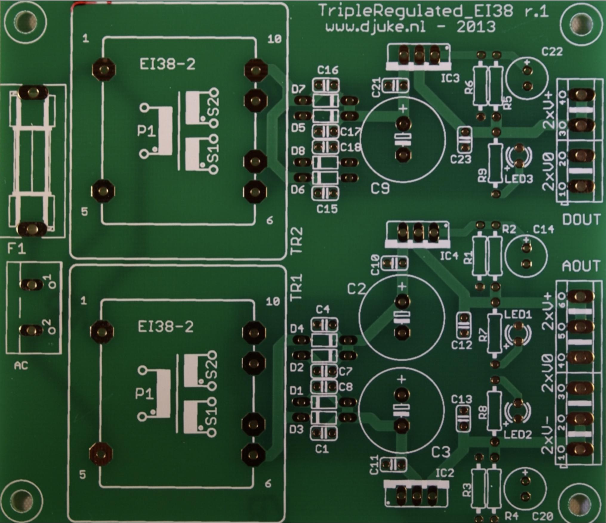

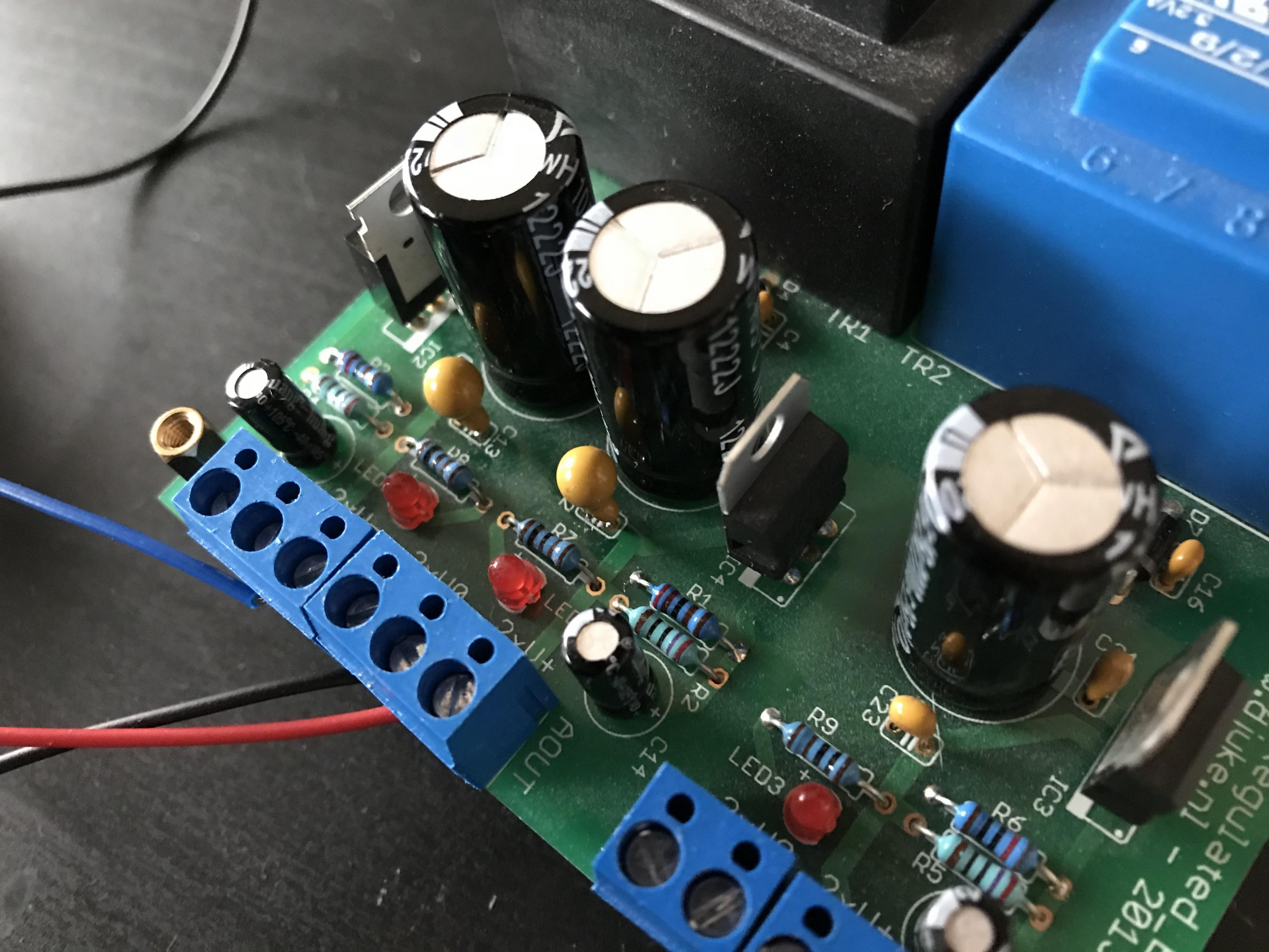

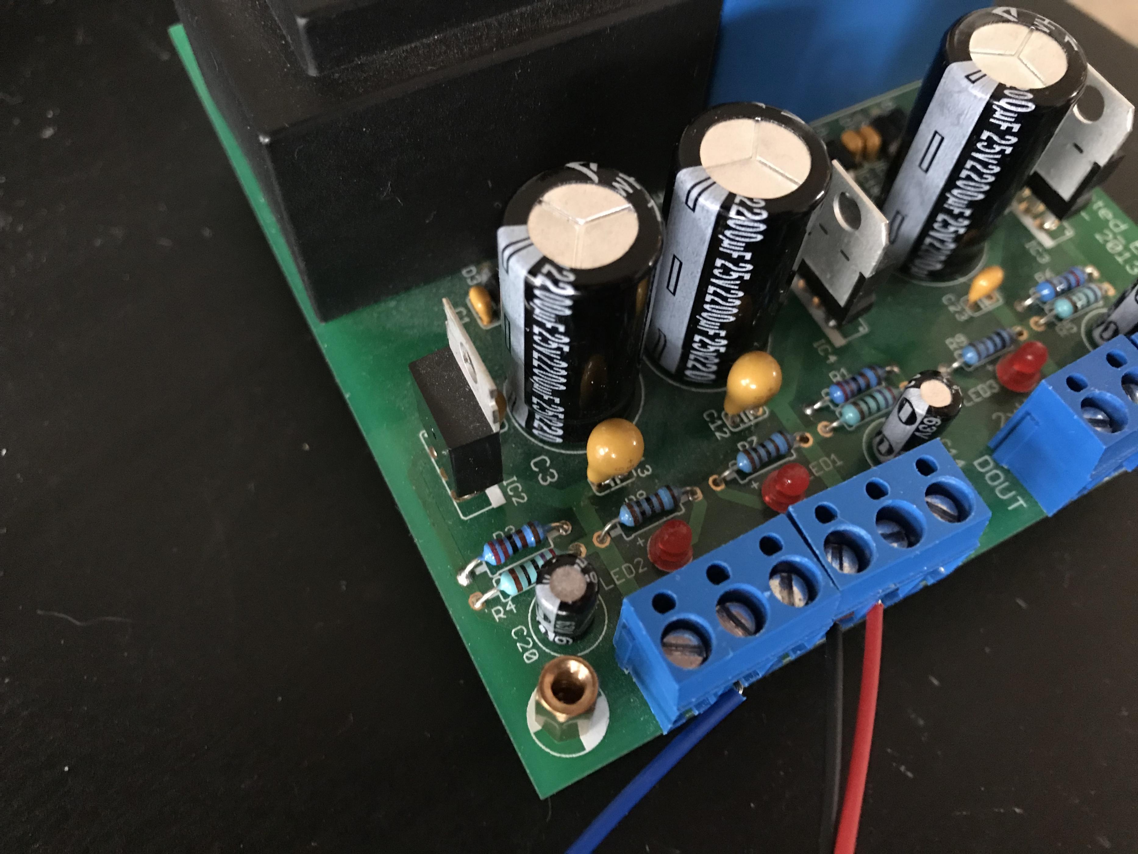

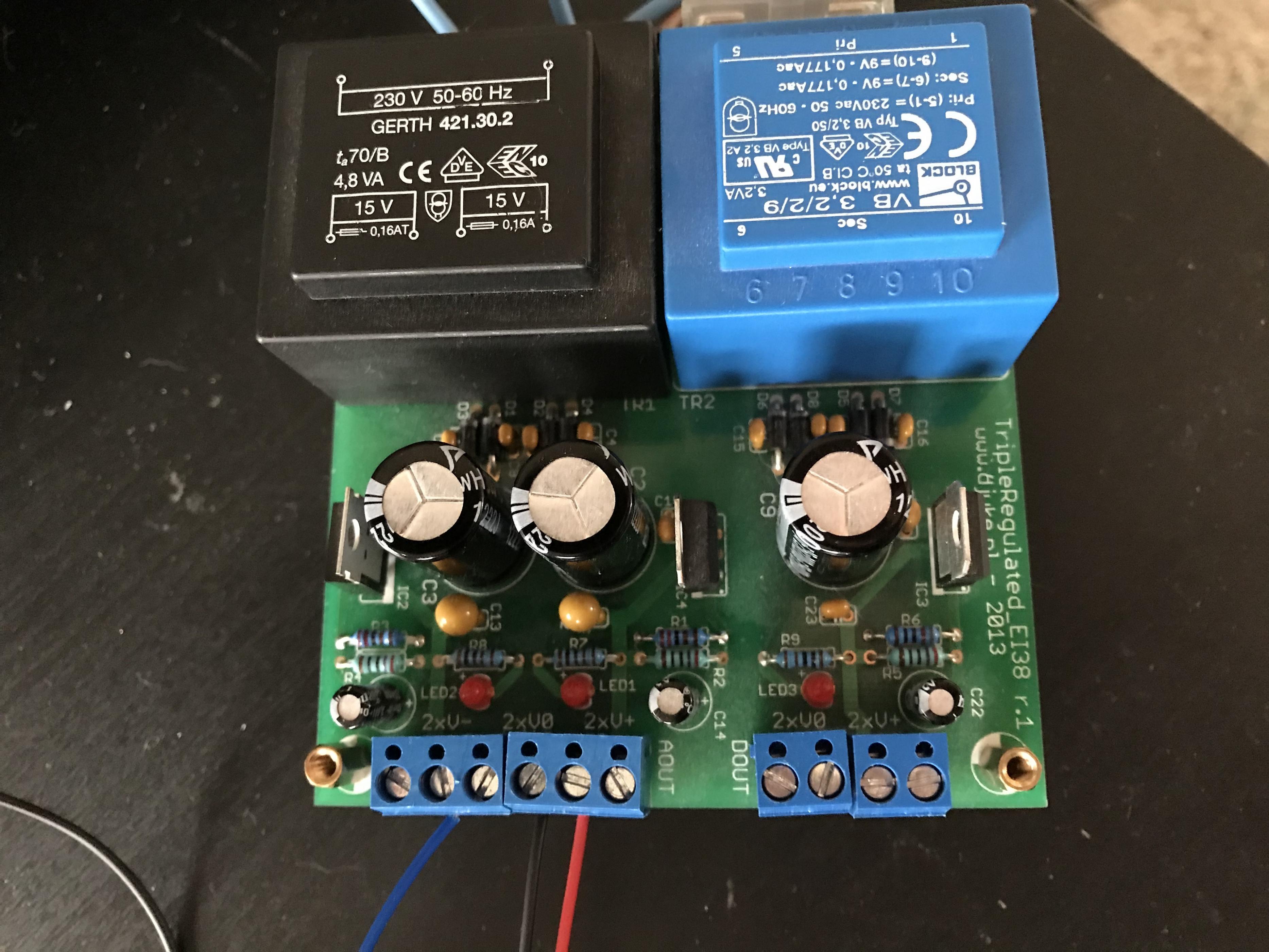

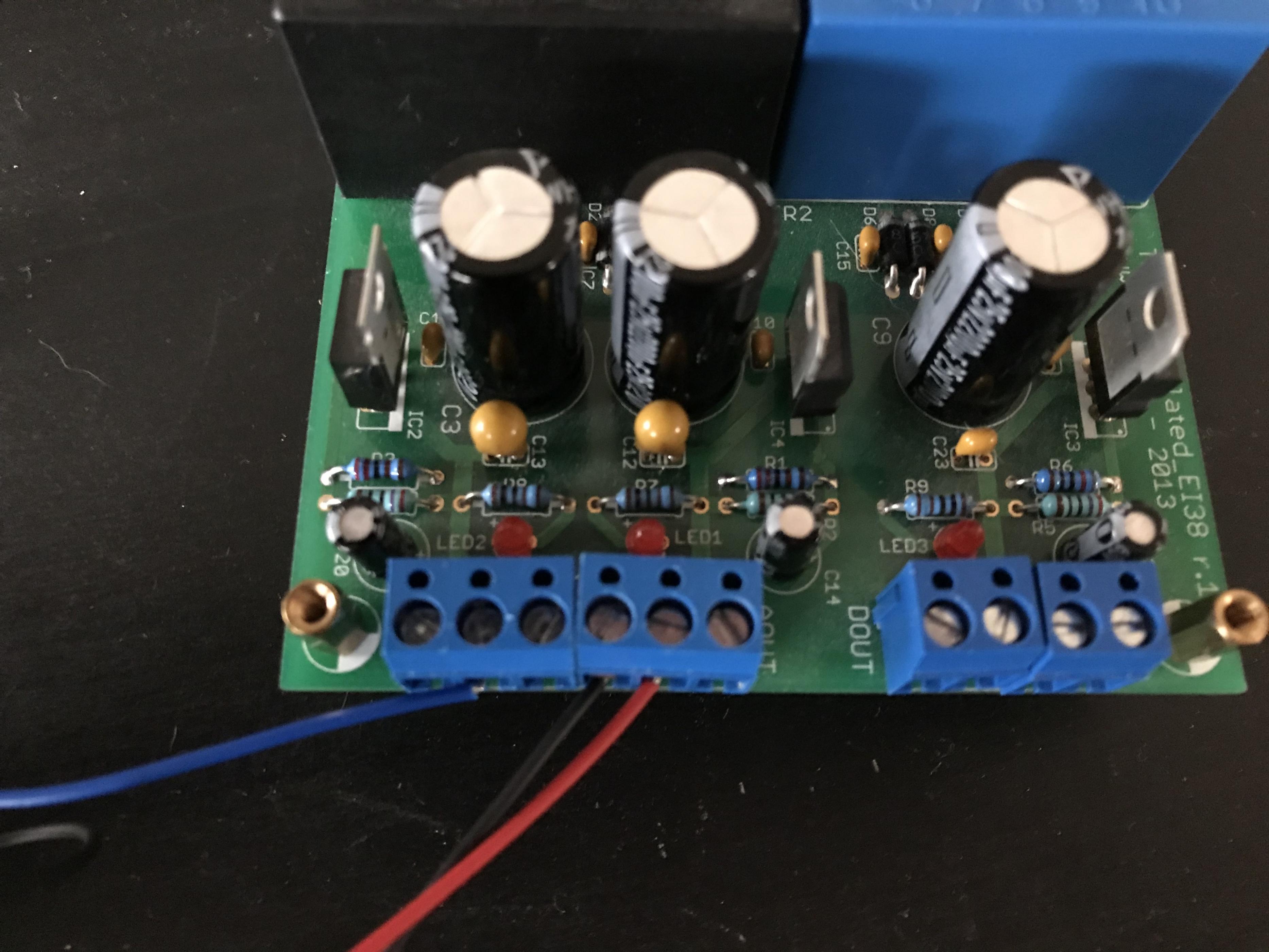

Input ceramic sits almost right on the input leg of regulator and output capacitor is around 1.5-2cm away from the output leg. Here are several photos of the PSU board.
