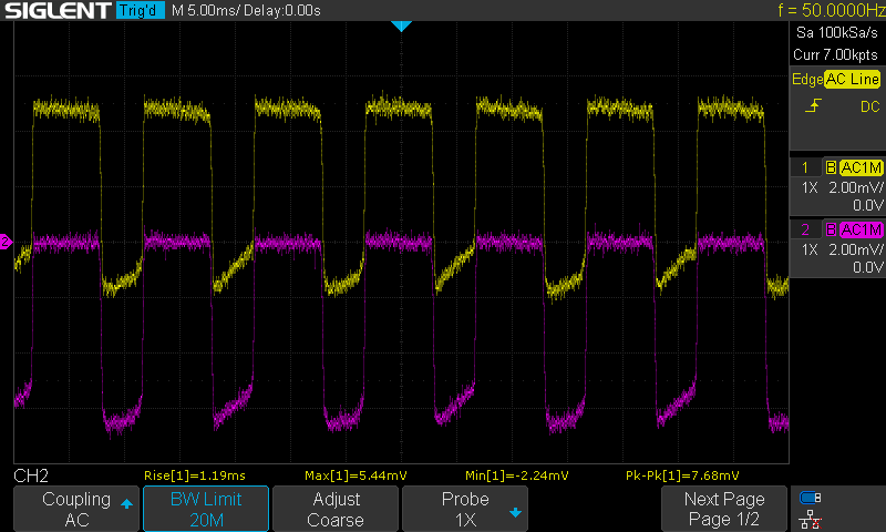

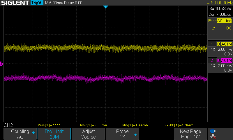

Wow, thanks a lot for your effort! Very insightful.I'm attaching here the board with changes and some pictures.
Of course the board can be improved even more.
Before I will make new boards, I want to understand the following: The first attachment shows the two rails when the main's earth is connected to the ground of the circuit.
The second one shows without the earth connection.
Is this just a sensing artifact, since the oscilloscope ground leads are also connected to main's earth?
