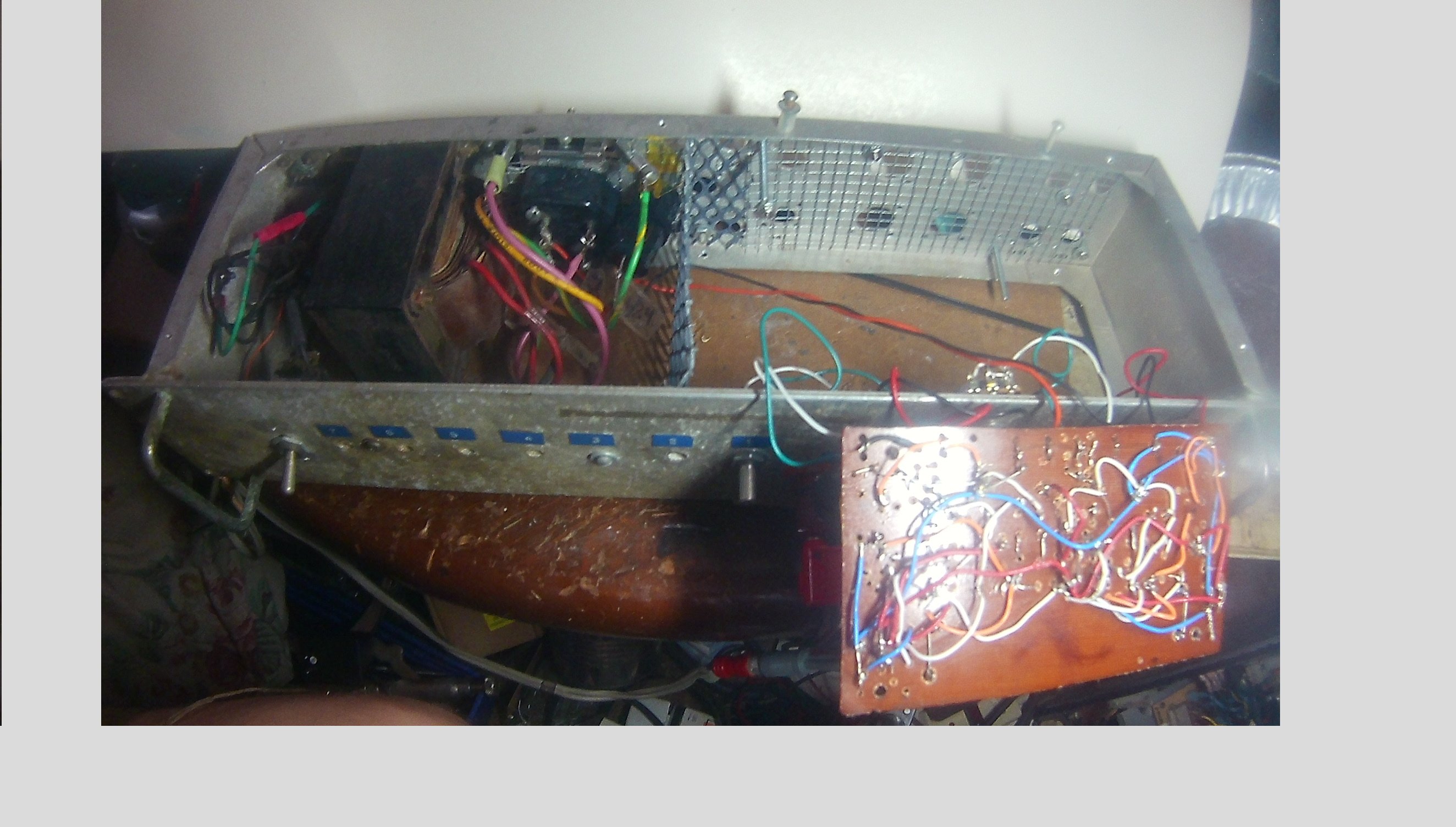

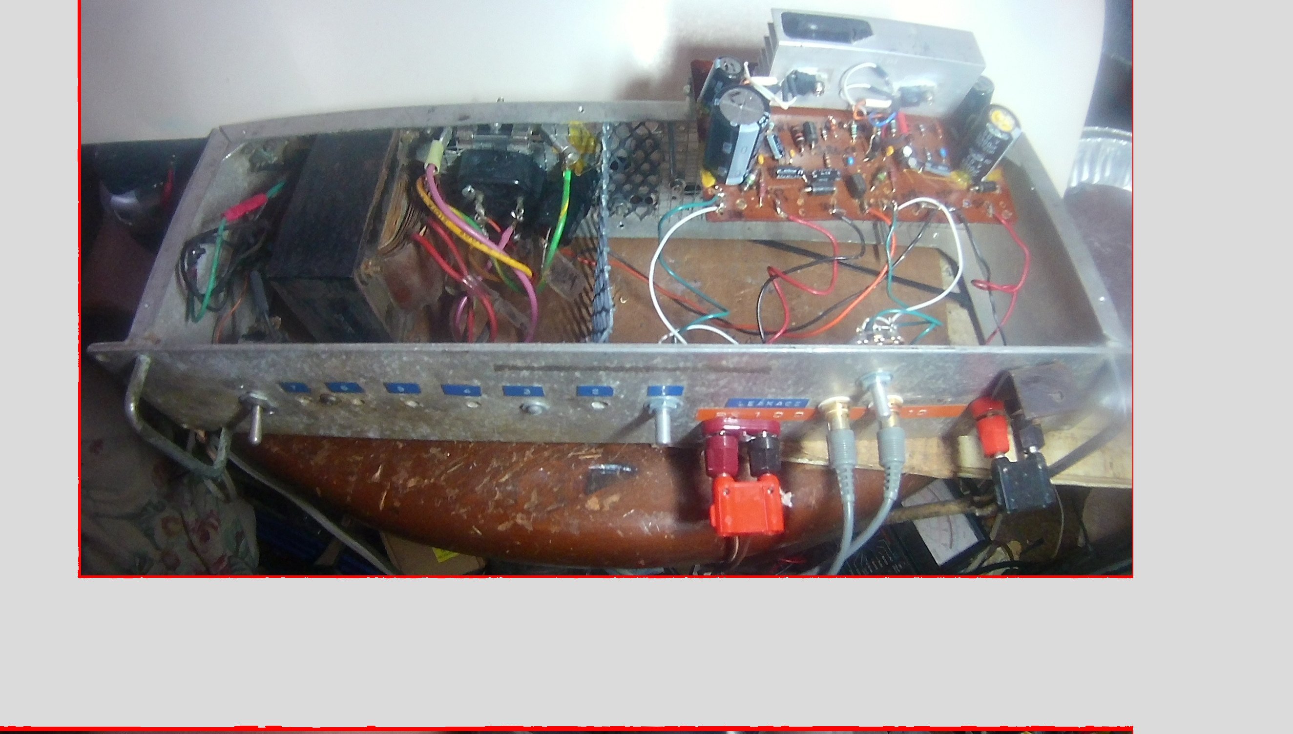

Here is my LM1875 stereo amp.
I've learned how to edit the files down from 1.4 mb to .5 so diyaudio will accept them, but haven't figured out how to crop off the greyed out blocks.
There are top & bottom grates of the same material as the bulkhead in the middle, to keep out RF. There is a MOS supressor ahead of the tranformer to cut down lightning snaps, but the internal bulkhead should help. Parallel a .01 uf 500 v disk cap of course.
Board has three mounting options, installed, components up, and wiring up. Last two are for debug. First allows the covers to be put on. Spacers on #6 screws are 1/4" pneumatic tubing cut to length. Case is tapped for mount screws and an angle bracket is on the front for wiring up mount.
Case is salvage Bud chassis from 10 channel continuity leakage tester found in trash. Goal is to make something that hunters/fishers/kids wandering through my country camp trailer will not steal. I'm not there in the fall/winter/spring. So far they have only stolen a jon-boat, a coleman lantern, and a turkey cooking pot. But they leave the door standing open so birds **** on everything. If I lock the door they would probably would just break a window out. Which would take a $120 truck rental to haul out supplies to repair.
One speaker is a 1998 Peavey 15"+horn wedge monitor 8 ohms. Other is TBD. They haven't stolen the speaker. I want to listen to good music/radio while cutting up tree limbs and the 1 watt ? FM radio isn't loud enough.
