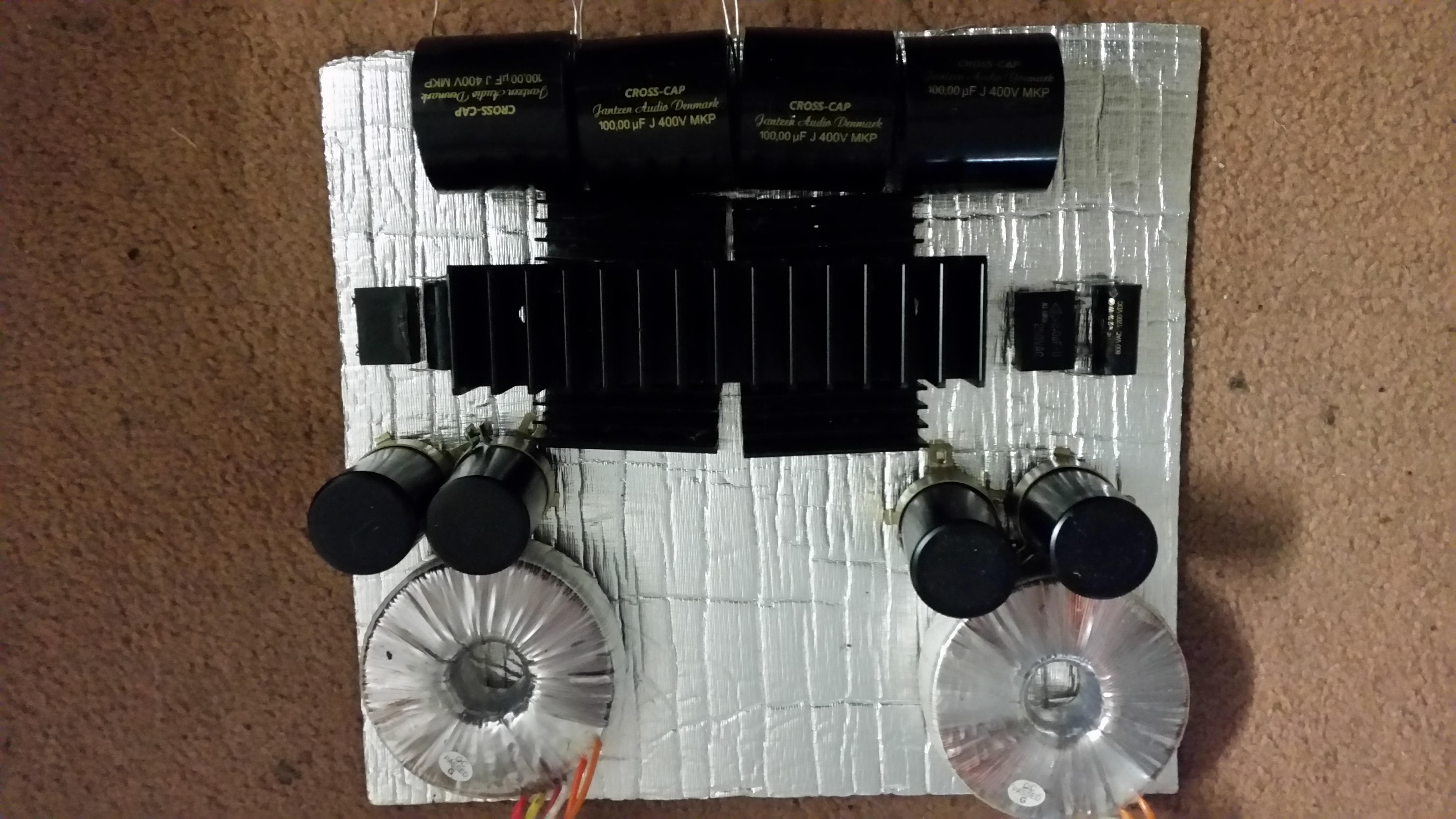

Here are the pretty pictures I failed to upload before .Woops the admin keeps saying invalid link.I will keep trying to post pics however long it takes. Like the native american indians who's raindance

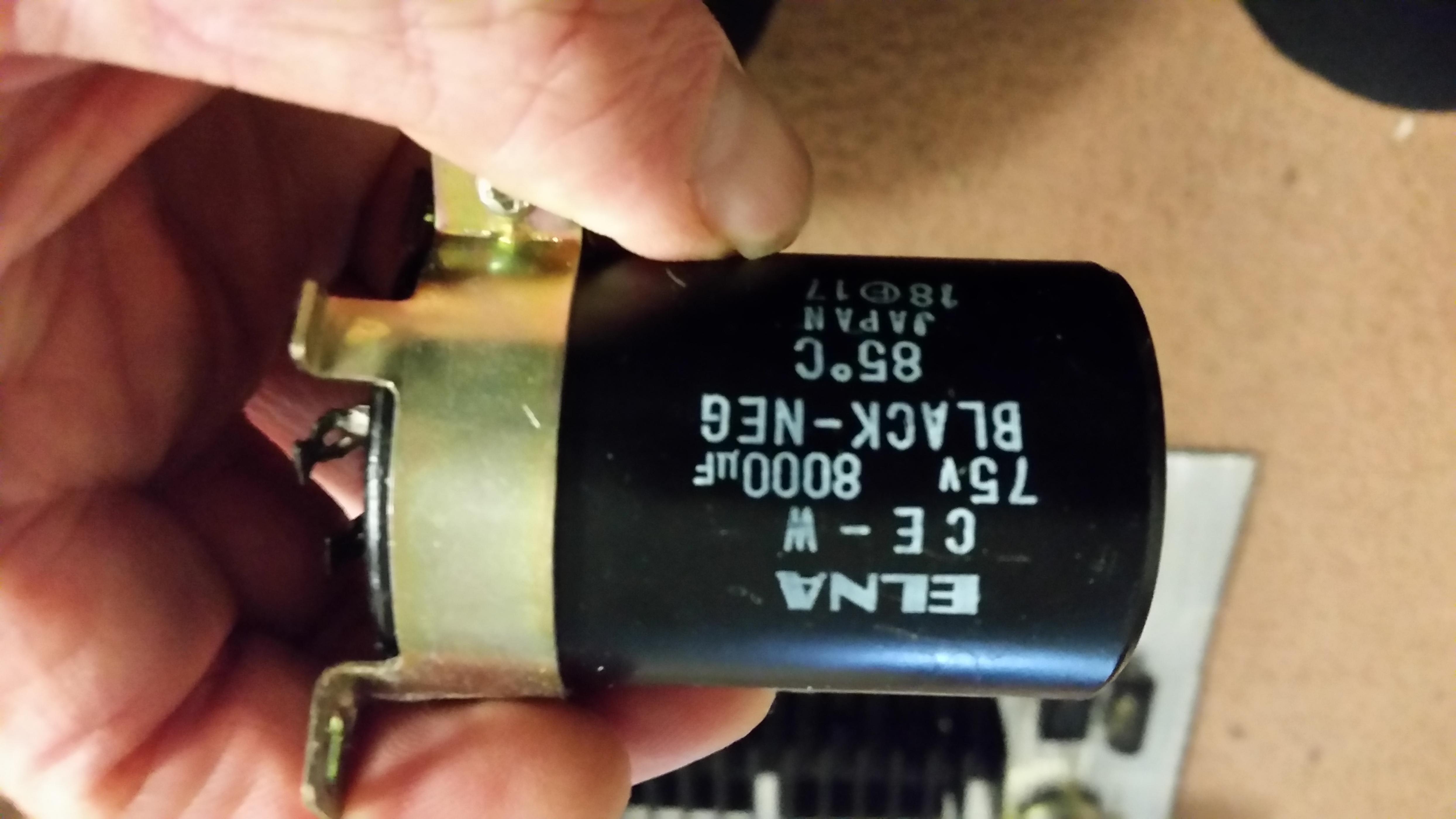

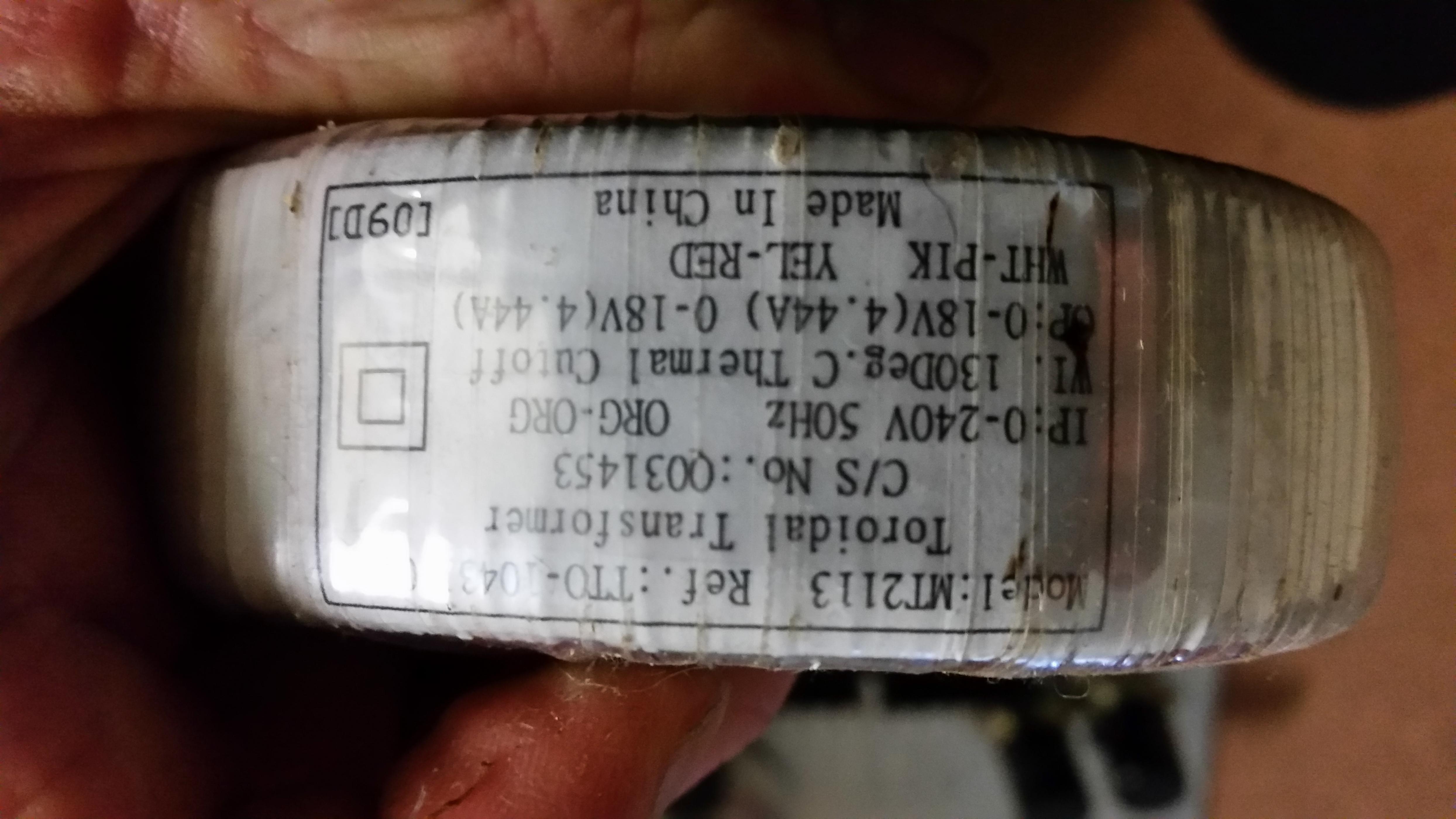

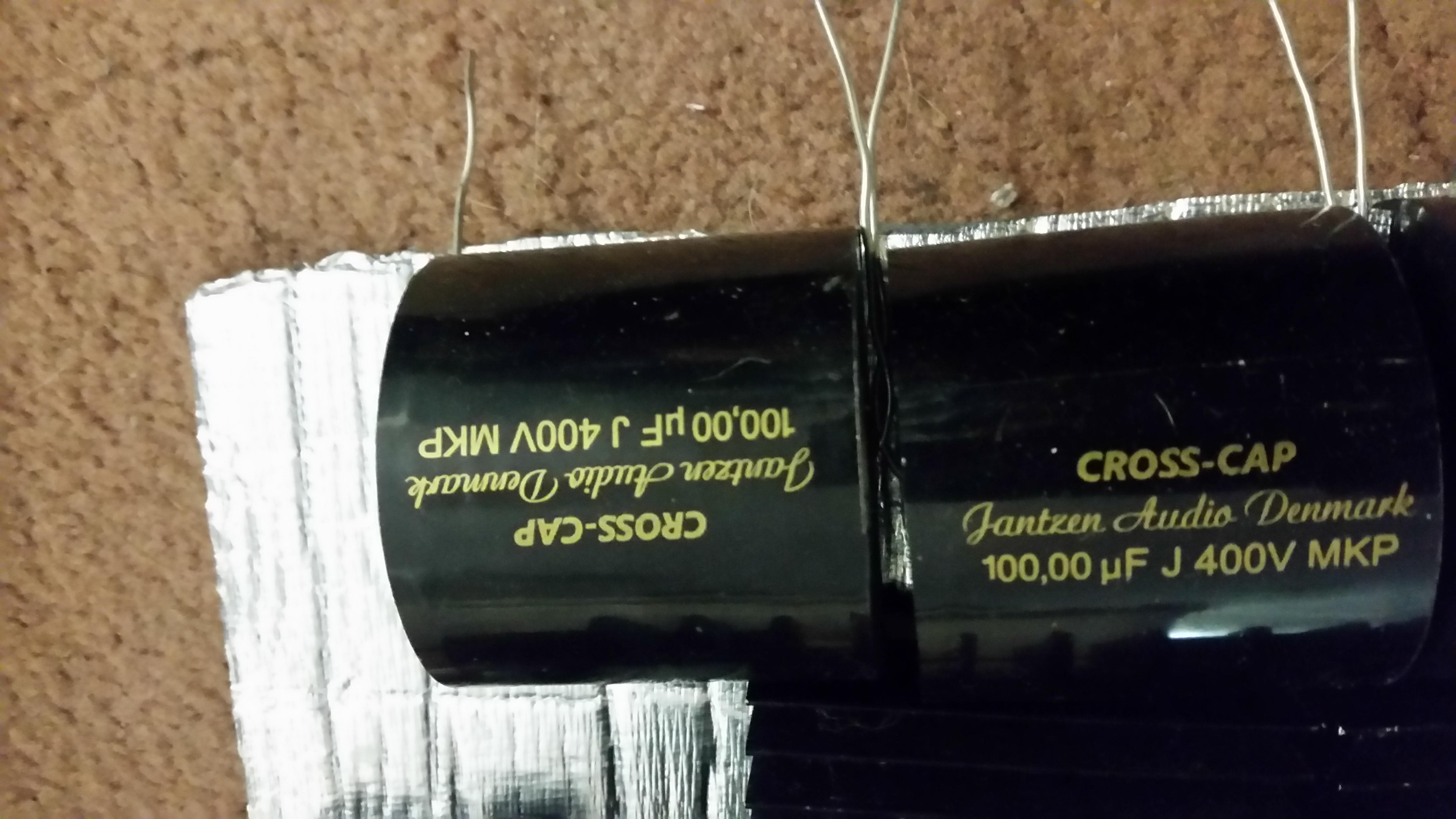

Yeah I know Tom, you don't offer a LM1875 amp. And thanks for the upload advice but this is a "security label is missing" issue. My game plan is to go active with mini DSP and use one of your amps as a reference + bass duties. The LM1875 will be on tweeter duties I have some gear on hand to build 2. 2 18-0-18v 160VA transfomers 4 100uF 400v Jantzen poly cross caps each is slightly smaller than my fist. 4 Elna NOS made in Japan 85c 8000uF 75V. 2, 2uF poly's bypassed with Mundorf gold / silver oil .33uF. Heat sinks are off a 150 wrms plate amp kindly donated by Adelaide speakers. Rod Elliot has been around a while & the project 72 looks like the best beginner project for me from a trusted no nonsense source.
After that if I don't cook myself or the amp/s then its time to get serious & build one of yours.

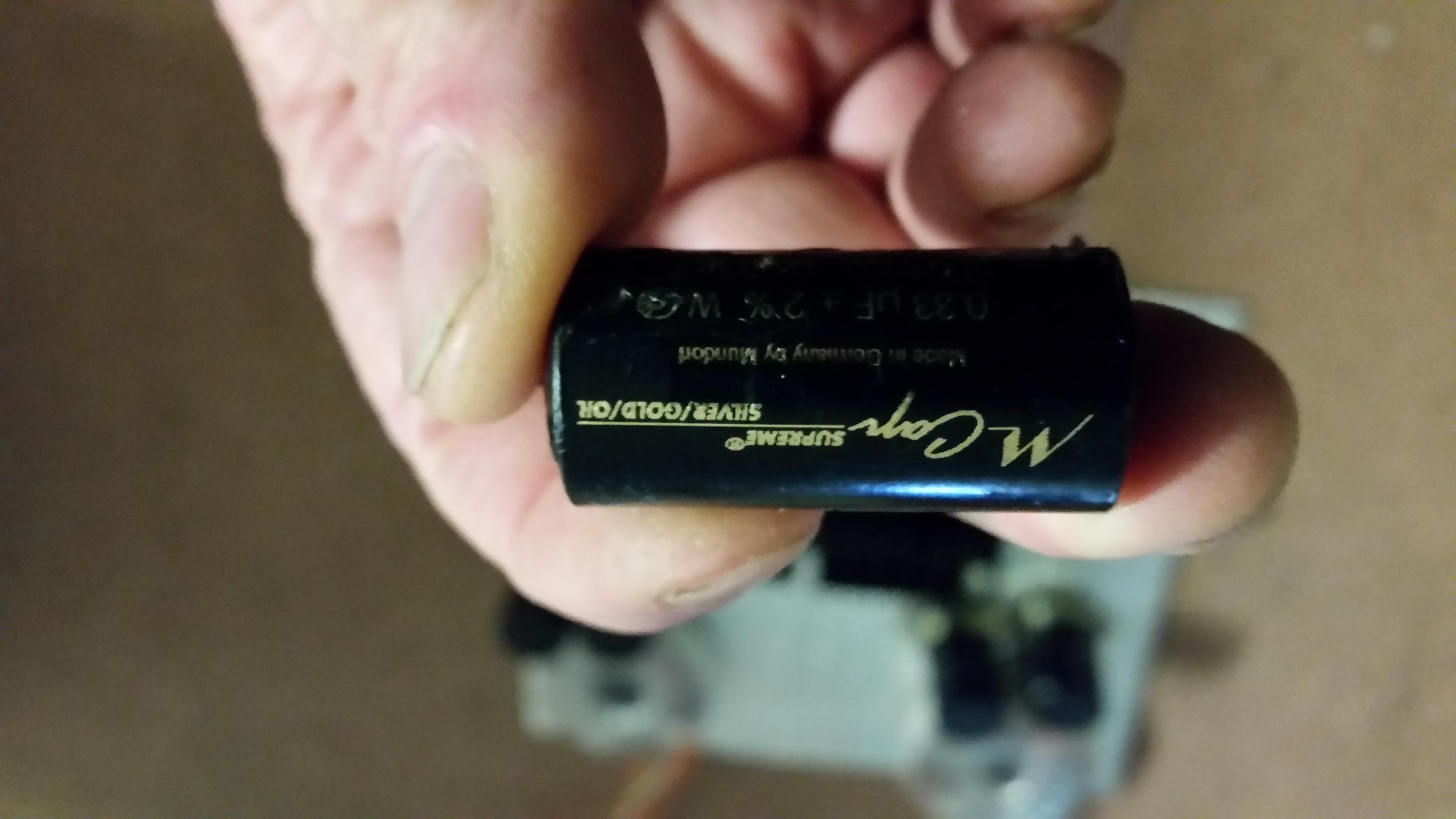

My game plan is to go active with mini DSP and use one of your amps as a reference + bass duties. The LM1875 will be on tweeter duties I have some gear on hand to build 2. 2 18-0-18v 160VA transfomers 4 100uF 400v Jantzen poly cross caps each is slightly smaller than my fist. 4 Elna NOS made in Japan 85c 8000uF 75V. 2 2uF poly's bypassed with Mundorf gold / silver oil .33uF. Heat sinks are off a 150 wrms plate amp kindly donated by Adelaide speakers.

Your transformer & capacitance values are a bit oversized for LM1875. Should work though. You need some resistors, coupler caps, fuseholder fuse or CB, switch, speaker and input terminals,

@indianajo Yup I agree but its what I have on hand & I will compare with local gain clones & see if going boutiqe on the bits makes any difference. If not it will at least look cool under the hood. Ha!
Oh you forgot to mention cases but I have some stuff on hand to make those from 2.5 mm alu sheet. A few bits & pieces to go but getting close now.
