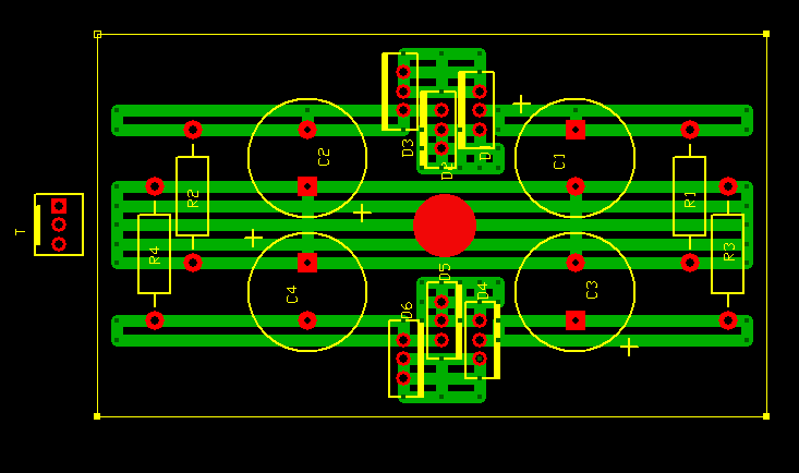

Am I using the wrong type of 100nF caps? here's a picture of my circuit. The left 220uF cap smoked.
I tried using a 22uF 16v polarized cap like the one in this this post
http://www.diyaudio.com/forums/chip-amps/120616-lm1875-pcb-use-2.html#post1474466 and it's still intact.
The PBC layout was of Silicon Chip's. The 2.2uF NP cap is a bit big.
Before the cap smoked, I heard a loud hum on the speaker.

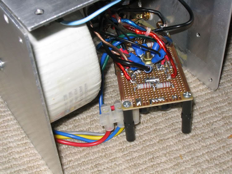

* what is the voltage rating of the smoked 220u?? the size in your pic' seems to small for a 220u/35V unit.
* where is the heatsink?
* do you direct solder the fuse? check it, it might be broken off.
The cap is 35v, and I didn't solder the fuse. I used a DIY fuse holder.The fuses are ok.
here's the pic
I think I can use two polarized caps in series ---|-)-(-|-- to make it non polar right? Just double the value, divide it by two, so it will result to the desired value. Am I correct?
here's the pic
I removed the heatsink after the test by the way.
I'm using 18-0-18 transformers that outputs 25v.

you don't need to use back to back series capacitors for the NFB DC blocker. A Polar electrolytic can and will do the job. Just make sure it is large enough to do the job adequately.
I used 220uF cap as an alternative. I replaced the blown cap with 220uF 50v. However, it still hums. And it doesn't pick anything from the input. same config as before. I just changed the caps.
What could be wrong?
