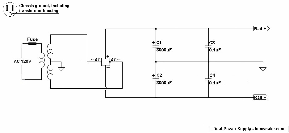

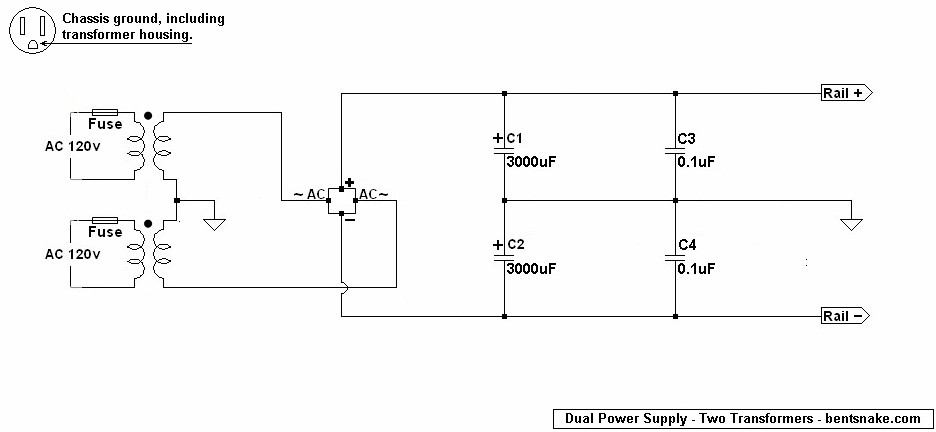

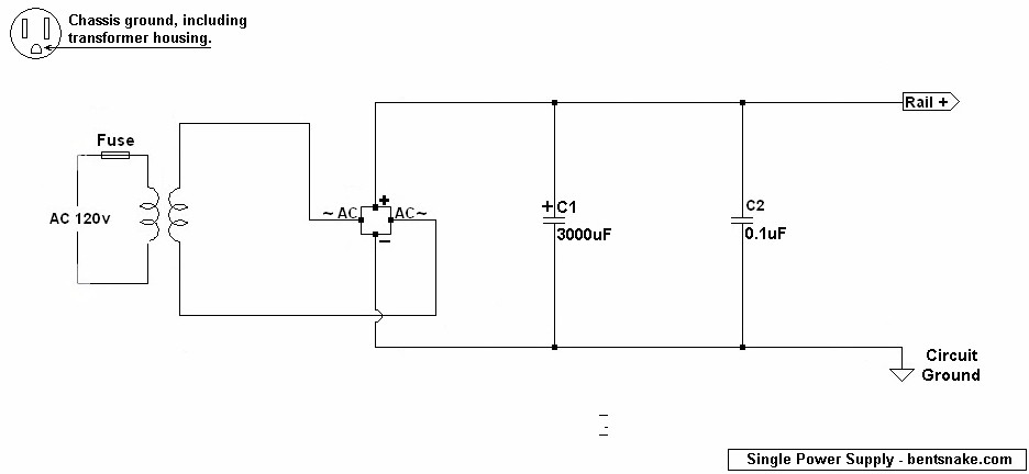

Consider, for example, an 80VA and 40VA transformer in series. The 40VA transformer is is wound with smaller gauge wire (the only real difference) good for carrying 2 amps, that would overheat if forced to carry 4 amps.
Maybe it's time for some illustrations. What the heck, it's always time for some illustrations.
Notice the similarity between the second and third circuits shown. The difference is that the secondary windings are in physically different locations, but electrically they still work the same way.

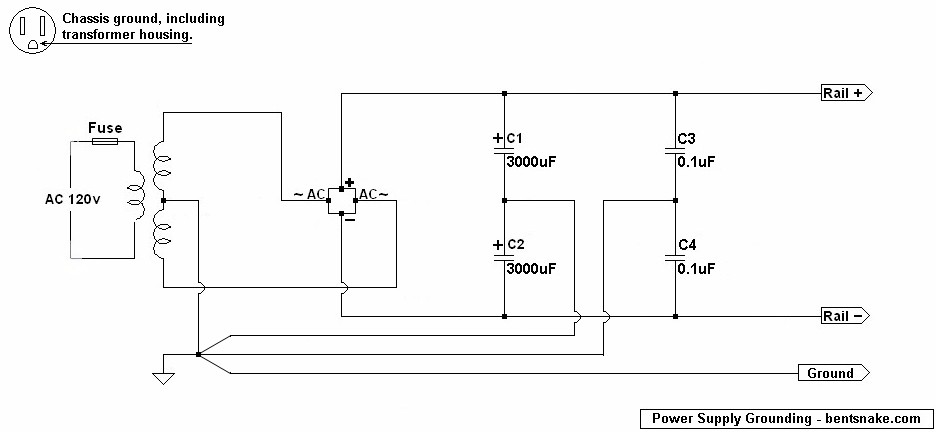

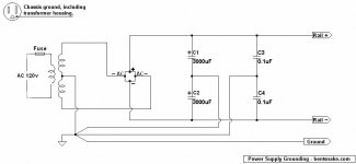

An addendum. The difference between schematic (symbolic) wiring, and the way things are wired in the real world.
The below circuit is mate to the three above. The three above show schematic wiring, the circuit below shows the preferred real-world wiring.
That is...preferred by me. Perhaps not by everybody.
Transformers in series: voltage adds, amperage remains the same.
Transformers in parallel: amperage adds, voltage remains the same.
IMPORTANT: "Transformers in parallel" is given only for explanatory purposes. Do not wire transformers in parallel. Doing so will create random eddy currents and voltages with unpredictable results.
