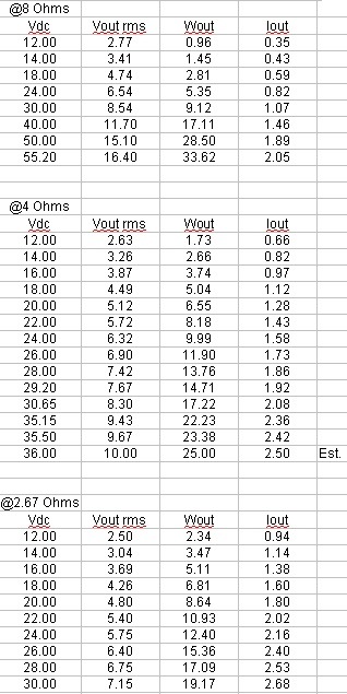

LM1875 power output measurments
The 4r0 value is -0.3dB ref 8r0, this is superb (better than excellent).
To me this indicates that the 1875 on +-12Vdc makes a very good 5W, 8ohms capable amplifier for current capability (upto 3.46Apk).
There is only one comparable supply voltage above that, 30Vdc (+-15Vdc)
8.54Vac into 8r0
7.15Vac into 2r67
The 2r67 value is -1.5dB, this is a good result (3 grades below superb).
To me this indicates that the 1875 on +-15Vac makes a good 9W, 8ohms capable amplifier for current capability (upto 4.52Apk).

For the two sets of voltages +-12Vdc and +-30Vdc the pattern follows what I expect for all amplifiers, both discrete and chip.
As one demands more current the maximum output voltage drops.
I could guess from some of the non comparable results what type of performance one might get.
As it is I have stated what I can read from the results given.
The chip performs very well @ +12Vdc and slightly less well @ +-15Vdc.
The test results as shown are what I do for every amp I build.
I expect at least good current capability as the first basic pass or fail test.
There seems no point in "tuning" a proposed amp build if it can't deliver adequate current, relative to the proposed speaker impedance.
If you look back at some of my 3886 recommendations you will see that I propose the chip as a 60W to 68W into 8ohms capable amplifier.
I also propose that same chip on lower supply rails as a potentially good build with a target maximum output of ~40W into 4ohms speaker.
This reduced maximum output is specifically aimed at limiting the output current to what the chip is capable of passing very well.
It all fits with my assertion that all these National chipamps are current crippled.

I use the relative output voltages as current demand changes.
A perfect PSU and amplifier would give 0dBV voltage change as current demand changes. -3dBV would indicate the same power into a half load impedance as into the rated load impedance. Most amplifiers give between -3dBV to -0dB. The closer to -0dBV the better the current capability.

measurments done by johnr66
