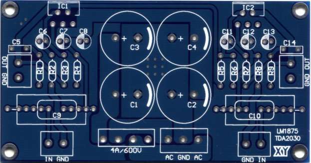

i have also bought this chinese lm1875 kit.
any comments on the pcb design?
also i want to note that my kit came with 4 fake rubycon yxa series 4700uf 35v caps.
c1, c2, c3, c4 - 4700uf 35v
c5, c14 - 0.1uf
c6, c7, c8, c11, c12, c13 - 22uf
c9, c10 - 1uf
r1 , r9 - 1r
r2, r6 - 680r
r3 - 22k
r4, r5, r7, r8 - 22k
c5, c14 - 0.1uf
c9, c10 - 1uf
r1 , r9 - 1r
r2, r6 - 680r
r3 - 22k
I, for one, would like some explanation of R5, 22k from the speaker output of one amp to the inverting input of the other amp. Half of a crossfade circuit? What the heck?

One more interesting item in this design is the NFB cap, 22uF.
This design drives the cap directly rather than through the resistor.
And then both the cap and resistor can operate normally, because this orientation has less reliance on component quality/variance, given the 680R higher efficiency into the cap, if compared with the LM1875.PDF design.
I'm trying to say that the design you've pictured has the 680R operating as a simple resistor like it should, and the attached cap NOT operating like a really bad cap.. 😉
Its the only AC coupled NFB, chipamp design that I've ever seen to address this little issue.
Whether the design works great or not, they surely deserve some Kudos! just for getting creative. 😀
I'd love to know what you think of it.

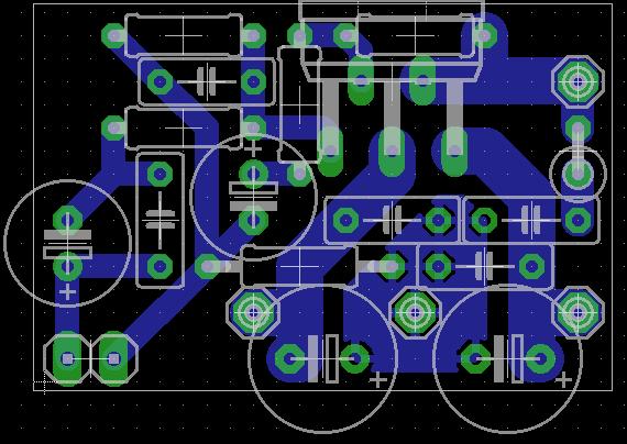

Khron said:
I've put together a (small) pcb for LM1875
Did you actually build one like this? There seem to be quite a bunch of overlapping components. Three of the electrolytic capacitors are not entirely on the PCB, which is not good for the mechanical stability.
Why are you using an electrolytic capacitor in parallel to the MKP(?) blocking capacitor?
No, i haven't built one precisely like this, but i have a pair of LM1875 amps back home with quite small pcb's (in working order, last time i checked).
The overlapping components issue shouldn't be that severe. I used a 7mm diameter 'lytic for that feedback cap in the middle, but a 47u/16V cap usually isn't much bigger than 5-6mm. A quick package change can take that all away 🙂
Regarding mechanical stability... I'm guessing these amps won't be mounted on board jackhammers, for the workers' enjoyment, and 10mm diameter caps don't weigh more than a few (tens of?) grams, so that might not be a crucial problem either.
Yeah, that's a 'lytic on the input. For less pretentious users and/or convenience, i suppose. The small film cap should take the "sting" out of the non-film :smash:
Nordic said:
I measuered the fuses, they are not worth wile takeing out I think, you gain a handful of mm at best.
I tried a few layout, each have their own issues, like mounting holes etc...
This one seems to be the best, good routing, can accommodate a number of diffirent caps by drilling hole in inline trace... and on input cap you can choose between two points for connecting one of the leads, by cutting through the other trace with a blade.
i has finally make this pcb yesterday (home made) but i wondering one thing!!
i find mistake of capacitor polarity (220uF/35V) at nordic layout
it's right? cmiiw?
thx for this information!!
btw that is my first homemade 1875 pcb:
finally this is pcb layout based nordic layout (some modiy for fit with 2,2uf caps)
thanks so much to nordic!!
Originally posted by Greg Erskine
quote:
Originally posted by danielwritesbac
Center pin of LM1875 is -v
OMG! I just got quoted by a guru. I'm smiling like the cheshire cat. 😀
Wow. Thanks man!
P.S. It seems that the computer software that Nordic used, had partially obscured the polarity markings for V+ and V- power inlet terminals, which is what led to the error. This could have happened to anyone if using that software. This reminds me. I need to go buy a new automatic pencil. 😉
