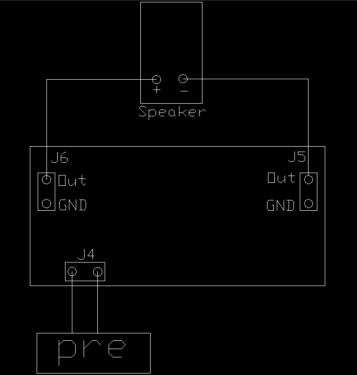

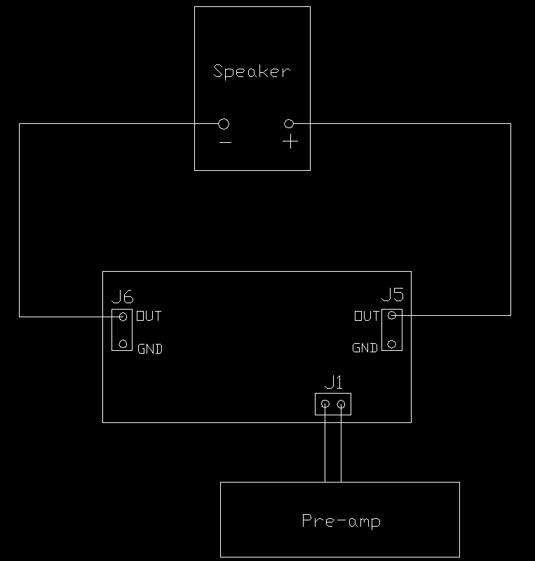

Finally after assembly all the parts, it is working now. After burning in more than a week, now I wish to try the BTL mode. I have soldered the 22k BTL resistor (refer to picture attach). With usual connection I found out one side plays louder than another (The BTL printed side play louder). In BTL I should only hearing 1 side of sound, right?
By right, how do I connect it? Usual connection are 2 inputs and 2 outputs for speaker. Which one I should connect only?

The BTL configuration is mono, thus, your hear only one channel from stereo OR you combine the two stereo inputs in a single mono signal. A single stereo channel may sound strange because parts of the music is "missing".
A mono signal has got all the music sounds but in a single channel, like in the old days. You combine the two stereo channels into a single mono channel by using two 10K resistors. You connect one end of the first 10K resistor to the left stereo output line and one end of the second 10K resistor to the right stereo output line. The other ends of the two resistors you connect together and this is your mono signal line. This principle is called resistive summing.

You are right, part of the music is missing.
Let say I am running in BTL mode, then how is the wiring configuration?
Let say speaker output Left and Right channel, how do I wired up?
Also signal input? Do I still need to input Left and Right Channel or only connect one side only?
Configured as BLT, the board only powers one speaker. Connect the speaker to J5 out and J6 out. Grounds J5 and J6 are left unconnected. Connect the input to J1.
Like this?
My mistake, input connects to J4 and switch the speaker terminals around.
BLT
Like this?

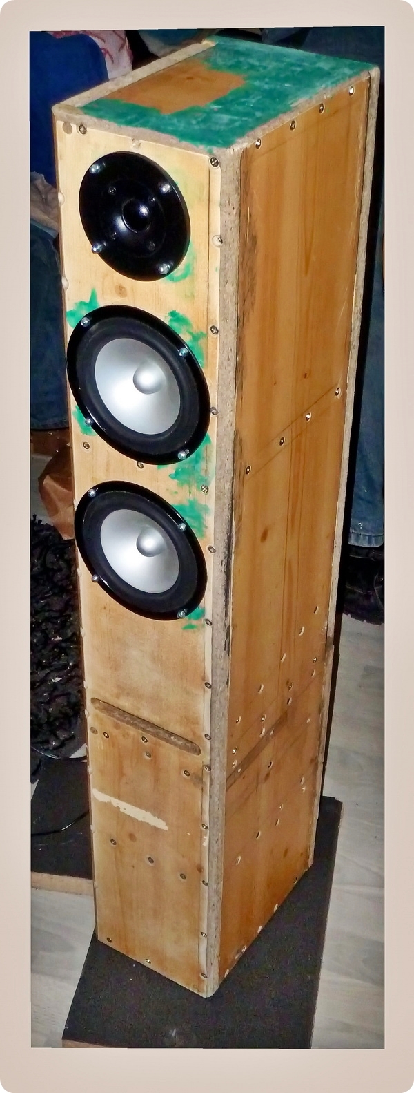

I put this in my 1st diy speaker. 3x LM1875 on one pcb. I'm still @ work with grinding & painting, but I tested it a few days ago and I'm very happy with the sound. Can't wait to get both speakers done and running.
best regards J
