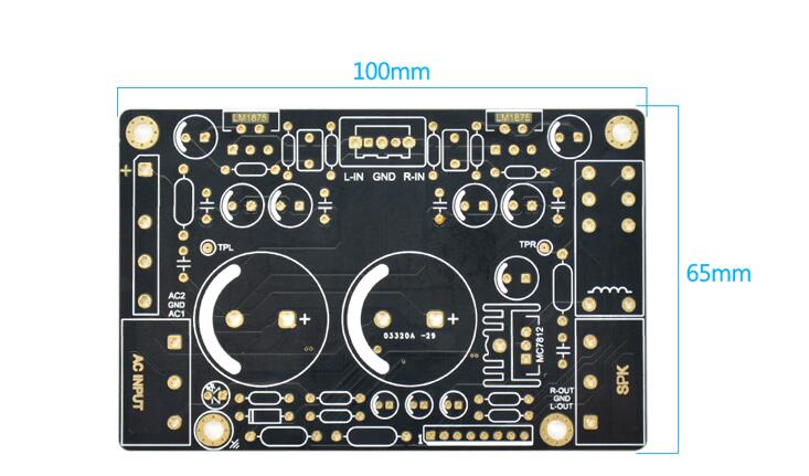

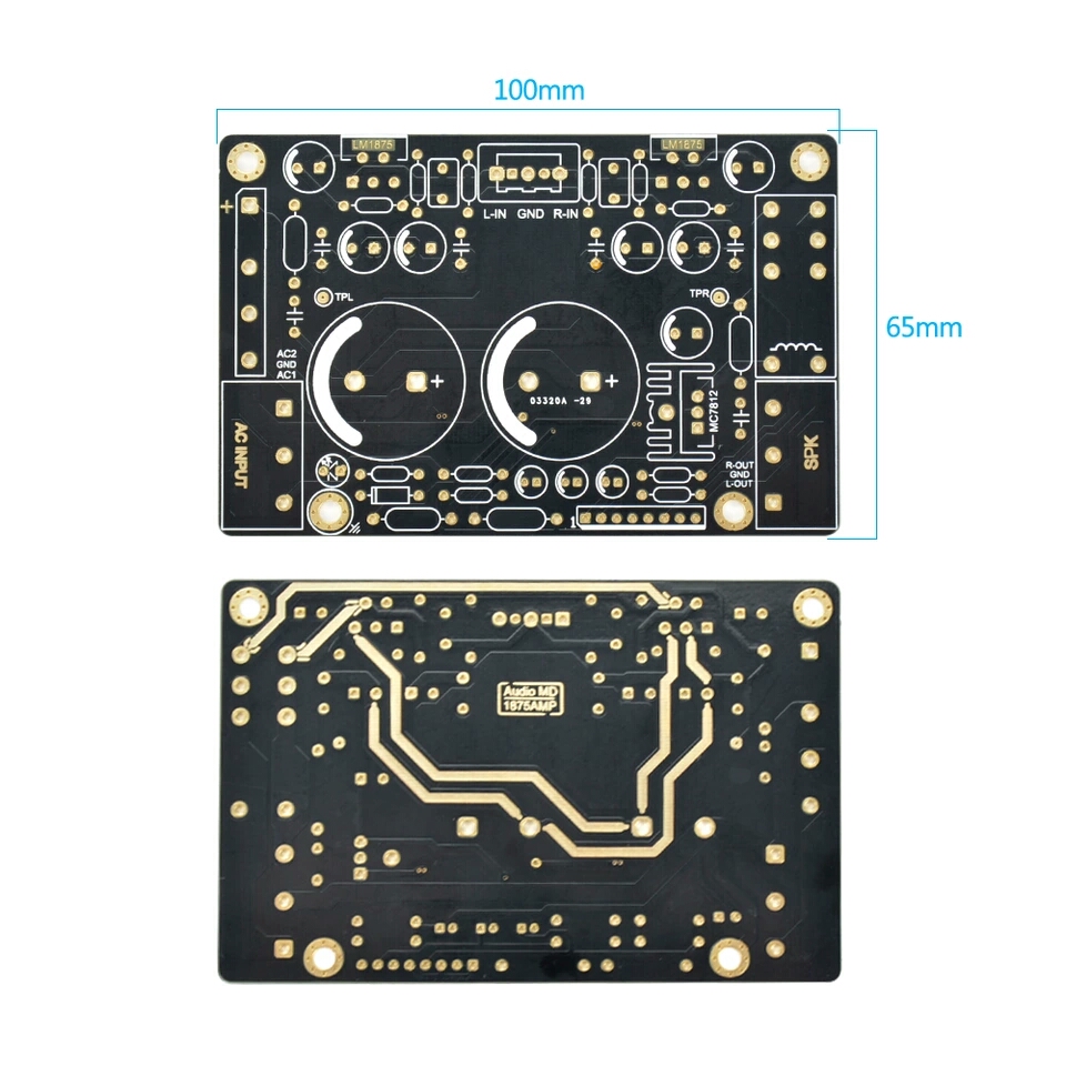

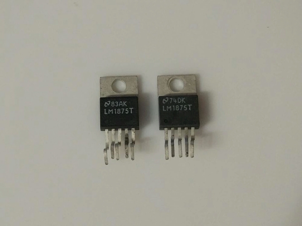

The 7812 regulator might be for supplying 12V to relay. As the UPC1237 works above 25V DC. If possible scan & upload both sides of PCB. Beware of fake LM1875.
Availlyrics, thanks for the input. This is the picture of pcb. Yes, one of the main concern is about the ingenuity of the IC. If they turn out to be fake, I have to order directly from TI. As you probably know, it is very difficult to find a genuine ic here in my country.
I couldn't find any schematic that could resemble this pcb. No 1 Mohm resistor across input. Gain settings set at 24x looks like. If any one has any input regarding this board, please mention. Thanks.

Absolutely an attractive price. But, notice what is written on the PCB:
"LM1875T TDA2030A¨. My understanding of this printing is that it is either an LM1875T or a TD2030A. LM1875T corresponds somewhat to a TDA2050, not to a TDA2030A.
So, you risk receiving a TDA2030A which is inferior. OK, the price is really low.
