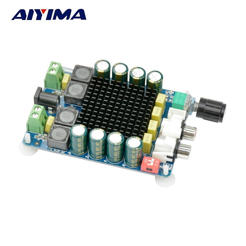

I have already orderd following TDA7498 Board. But I am not sure it will reach me or not.
Aiyima TDA7498 Amplifiers Digital Stereo Power Audio Amplifier Board 2X100W Amplificador Dual Channel Speaker Impedance 8 ohms-in Amplifier from Consumer Electronics on Aliexpress.com | Alibaba Group
Now I am planning to get the following LM1875 board. Any one have any experience with it? Or does it have any major problem?
Free Shipping!!! CG / LM1875 lower distortion and more resistant to listen / amplifier board /Electronic Component-in Integrated Circuits from Electronic Components & Supplies on Aliexpress.com | Alibaba Group
I want 20-30w clean power. Which of those boards will be better? If you have any other suggestions, please mention it. Thanks.

My a priori expectation would be that the LM1875 will win moderately because it has a THD of 0.015% while the TDA7498 0.1%. You are explicit about "clean sound" and class AB normally has a better THD in the mid- and high range. TDA7498 is a well performing chip and may offer better bass punch.

I received two Aiyama tda7498's yesterday. I connected one of them on a cheap smps 240W 24V power supply and a pear of two way speakers I just finished. The sound is very easy and effortless. Very good detail and a massive bass. Good stereo image and focus as well, so I'm quite confident. Astonishing how much value for a couple of euro's. I intend to use them for a 2 or 3 way active system. Hopefully they keep playing (I had a failing Sure amplifier earlier).

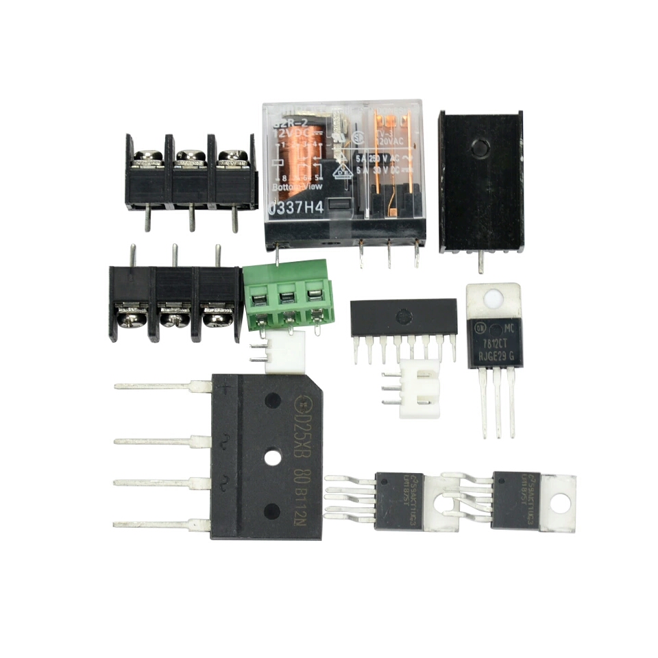

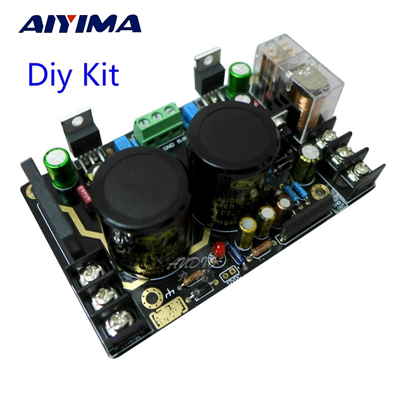

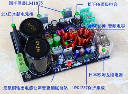

The board has one MC 7812CT regulator. See attached images.
Following is an updated board according to them. It also has that regulator.

I am very happy that you are pleased with your TDA7498. Yes, it is amazing how much you get for very little money. I know you have two defect SURE amplifiers.
I have bought more than 20 class D amplifiers from the cheapest suppliers and they all work (one I haven't tested yet because the onboard power supply is designed such that the supply range is narrow and does not fit my current power supplies). You have been particularly unfortunate with your Sure amplifiers.
Be aware that a class D amplifier may be destroyed by not operating with a loudspeaker load (or a similar dummy load). This is not an issue for class AB amplifiers.
Aiyima Classic LM1875 20W+20W Audio Power Amplifier Board With Speaker Protection Warm Sound Bile Fever Circuit DIY KITS-in Amplifier from Consumer Electronics on Aliexpress.com | Alibaba Group
The 12V regulator is probably for the speaker protection circuit. Now you need the right transformer.

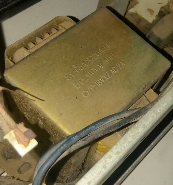

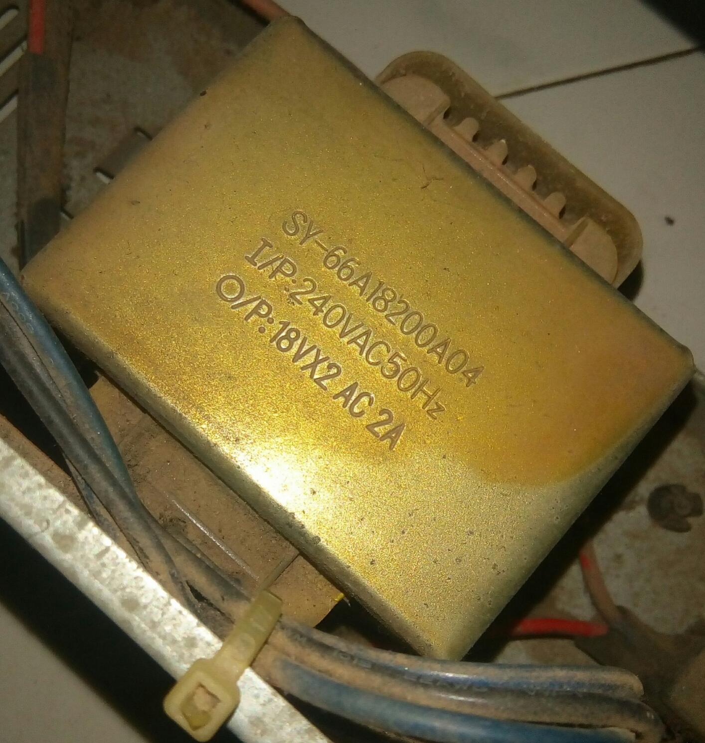

I have a dual rail 18V 2A transformer laying around. Though it's not a toroidal one. I'll buy one if needed.
Edit: Multimeter shows 20v. I think it will be ok.

a small EI transformer rated @ dual 18Vac 2Aac will have a much higher regulation than you are measuring.I have a dual rail 18V 2A transformer laying around. Though it's not a toroidal one. I'll buy one if needed.
Expect regulation around the 20% value. This will give an output voltage of:
Vout = Mains voltage / Rated primary voltage * rated secondary voltage * (1+regulation)
If you feed in a mains voltage that equals the rated primary voltage the output is likely to be around 18*1.20 = 21.6Vac
If you feed in mains at maximum tolerance, the secondary voltage will be higher.
Yes, 22v ac for sure. Yes, The transformer is a small ei one. Probably I have to replace it once everything else are sorted out.
