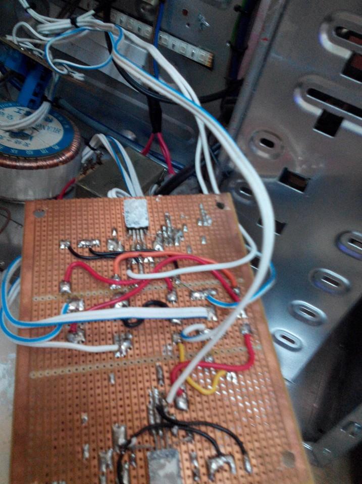

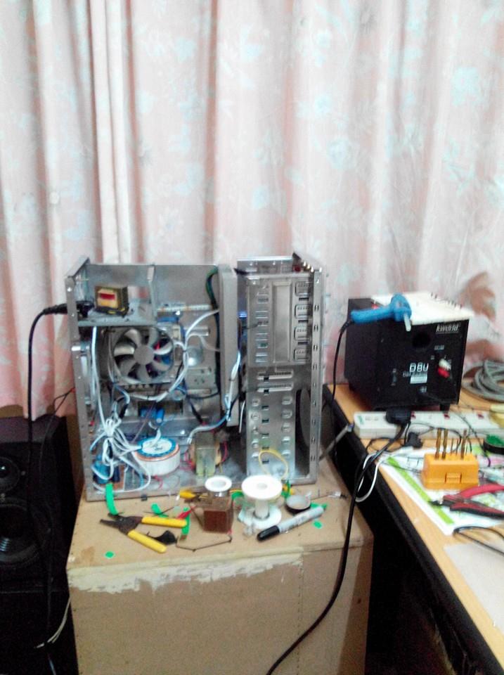

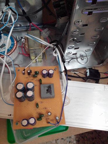

Perhaps if i am constructing the amplifier using stripboard and that is the cause for parasitic impedances? gotta strip it down from the chassis and check everything again ... the IC is mounted below the board lied down onto a heatsink as shown in the picture ... ignore the LEFT module (that is TDA8950 for subwoofer duty) That slim long and wide heatsink is the LM1875 board ...
things get stripped off ... back and from out from the chassis ... i didnt see anything amiss or obivious ... what do i need to look out for? The LM1875 is soldered in such a way that it mounts flat against the heatsink ...
UPDATE: problem solved ... !!!! 😀😀😀
Thank you Fast Eddie ... you were right that the intermittent hissing problem came from the fine solder debris along the PCB tracks near the inverting and noninverting (pin1 and 2) ... clean them up and now it is running perfect ... thanks ...

BTW Fast Eddie ... for the strip board version of the LM1875 ... is there a more compact way to build this gainclone amplifier? at times i still find that no doubt this is my favourite amplifier module but it takes up way too much space ...
I've seen boards for sale for 1875, 3886, etc. Chipamp.com has them but I heard they're having problems delivering etc.
You could make it a lot smaller on that veroboard too. You can cut and grind the copper strips to suit your layout. In fact, I wouldn't leave long unused strips attached to the input. You're just asking for parasitic interference.
You can make your own board too, and you can buy everything you need from Digikey and even Radio Shack. Digikey has a lot of PCB stencils and if you look you might find one for a TO220-5 package.
Your circuit would probably work better on a small board too. Feedback resistors should be right next to the chip, not way out there. That goes double for bypass capacitors. Layout counts and can have a large effect on circuit performance and operation.
