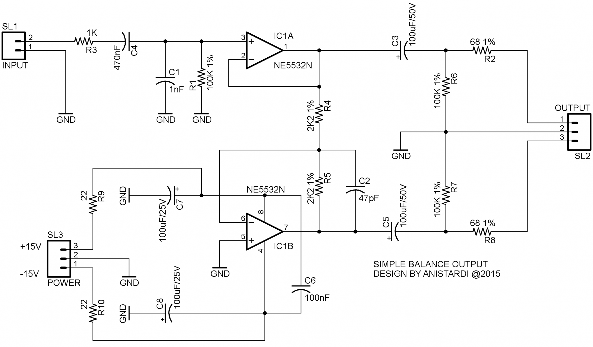

still clueless Member Joined 2022 2022-07-04 8:49 pm #21 2022-07-04 8:49 pm #21 But first he needs unbalanced to balanced. Attachments simple-balance-output.png 810 KB · Views: 95 adason music soothes the savage beast Joined 2004 edsaudiopages.blogspot.com Paid Member 2022-07-04 10:52 pm #22 2022-07-04 10:52 pm #22 Why? He stated few times he has balanced out from sound card. still clueless Member Joined 2022 2022-07-04 11:10 pm #23 2022-07-04 11:10 pm #23 my fault. no need for unbalanced to balanced. JMFahey Member Joined 2009 2022-07-05 3:38 am #24 2022-07-05 3:38 am #24 Of course, LM1875 input is unbalanced. So if your sound card also has an unbalanced output (I bet it does) just join them uing RCAs and shielded but unbalanced wire, nothing further needed, not even a buffer or preamp. Prev 1 2 First Prev 2 of 2 Go to page Go You must log in or register to reply here. Share: Facebook X (Twitter) LinkedIn Reddit Pinterest Tumblr WhatsApp Email Link
