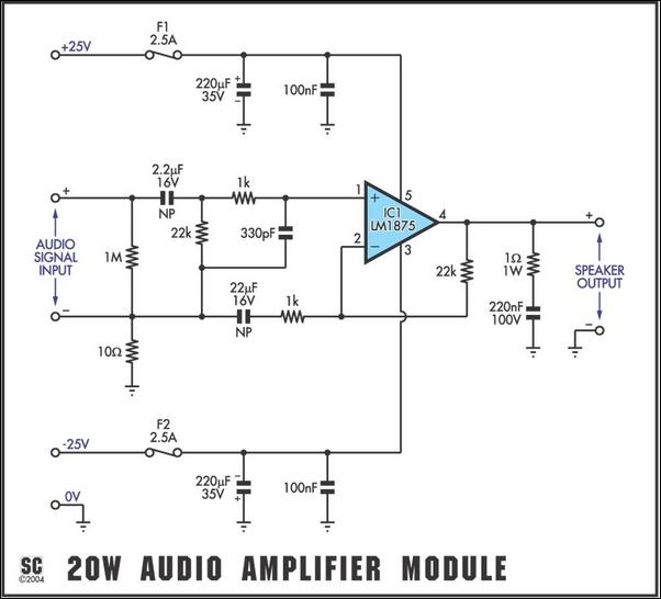

That depends on the user, it is important to set the gain properly. Anyway i already advised capacitor coupled amplifier for tweeter section.
And how can i lower the gain of lm1875? And how works the capacitor coupling?That depends on the user, it is important to set the gain properly. Anyway i already advised capacitor coupled amplifier for tweeter section.
Okey, thanks 😉A potentiometer in front of it is the simplest solution.
i am making lm1875 bi-amp
If i lower the gain using patentiometer will it also reduce power consumption?A potentiometer in front of it is the simplest solution.
The power consumption of a typical linear, class AB amplifier (i.e. no other features or functions included) is proportional to the power output + its DC bias or idle current losses, through the resistive heating and EMR or radiation losses of components, wiring, PCB traces and (assuming there is one) the power transformer itself. So-o-o-o, when the volume is reduced, so is the power consumption, until the idle current or bias threshold alone is reached, when there is no signal to amplify at all. That's the minimum power consumption level of the amplifier.
