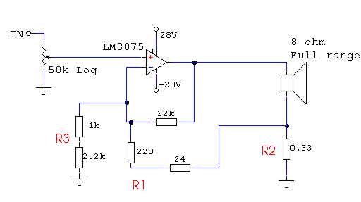

Well, here is my version of mix-mode amp. I think it will drive Fostex speakers just fine. You can tune it with R1, R2 and R3 for your needs.
Don't forget-R2 is dissipating some power, so calculate the wattage you'll need.
Changing the resistors you can set the sound you like.For example-changing
R3 from 4,7k to 1k and the mids and hights
starts to approach ordinary GC sound.
You must try for yourself and find the right combination.
I've tried different values for the resistors and found the
best results with values:
R1=220 to 330 ohm
R2=0.22 to 0.33ohm
R3=1k to 4.7k

thanks...
Thanks for the feedback.
Are you suggesting that a fostex would need some dampning, instead of using a 'pure' current source? Or are you fine tuning the sound in general with that network?
Have you noticed any stability issues doing this?

I had no problem with stability. Like I said, you can adjust the sound to your leaking. This amp suppose to go well with fullrange drivers with lightweight membranes helping them in the bottom region. Check Pass Labs site - there should be an article about amps driving fullrange drivers.
Of course, ordinary loudspeakers might sound bloomy with such amp because of the damping factor.

This would be a true transconductance amp, Zout=infinity. It requires stabilization means, to counter the inductive effect of the voice coil. You must make the speaker load look resistive for HF, and you must obey the minimum gain requirement for the chip (or use noise gain compensation for lower gains).
Details see:
http://apex.cirrus.com/en/pubs/appNote/Apex_AN13U_C.pdf

I read that Pass article and that's exacly why I'm doing it - an elegant way to eq a full range driver, regardless of the other benefits. Ideally I would use a copy of his F2 (single ended, zero feedback) but since this will be an active design, I don't want to have to deal with the power and dissipation requirements.
The other direction I was thinking about going was to use a class-D amp, but for me that would require using a t-amp or something similar. I would have to use a series resistance in that case and it's seem pointless to me to use a high efficiency amp and then burn up power in a resistor.
One point I forgot to mention:
Some drivers do exhibit chaotic behaviour when driven with a true current source:
http://ip565bfb2a.direct-adsl.nl/articles/timphany/paper_aes117th_jr.pdf
I don't know if high efficiency fullrange drivers are prone to this.
Therefore, I may suggest that you follow Igla's way of driving, which seems to be quite similar to a proposal from Rod Elliott:
http://sound.westhost.com/project56.htm
I have been using this for chipamp-based guitar amps -- set to about 4 ohms Zout -- and it worked fine (guitar speakers hate low-Z drive).
