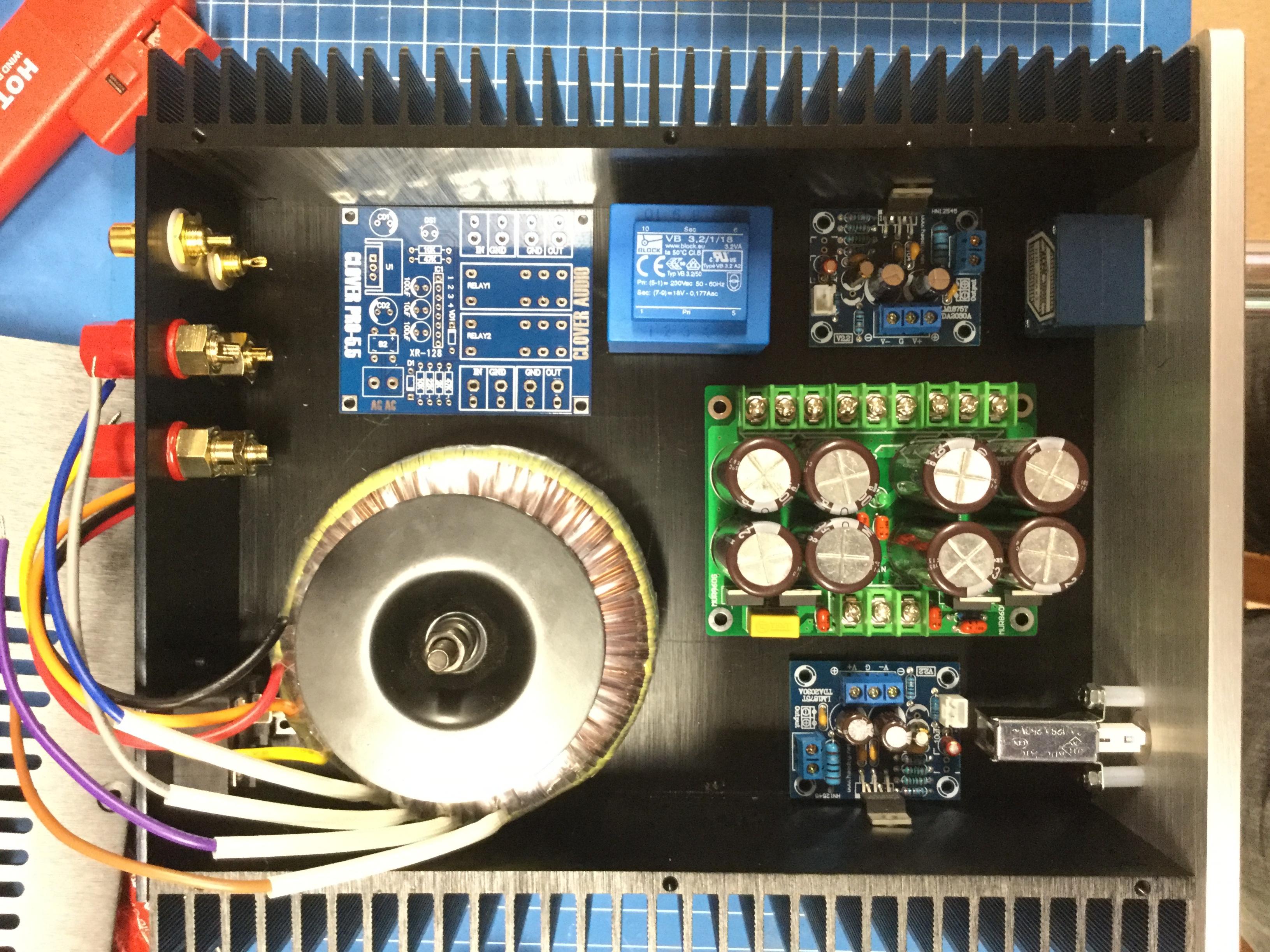

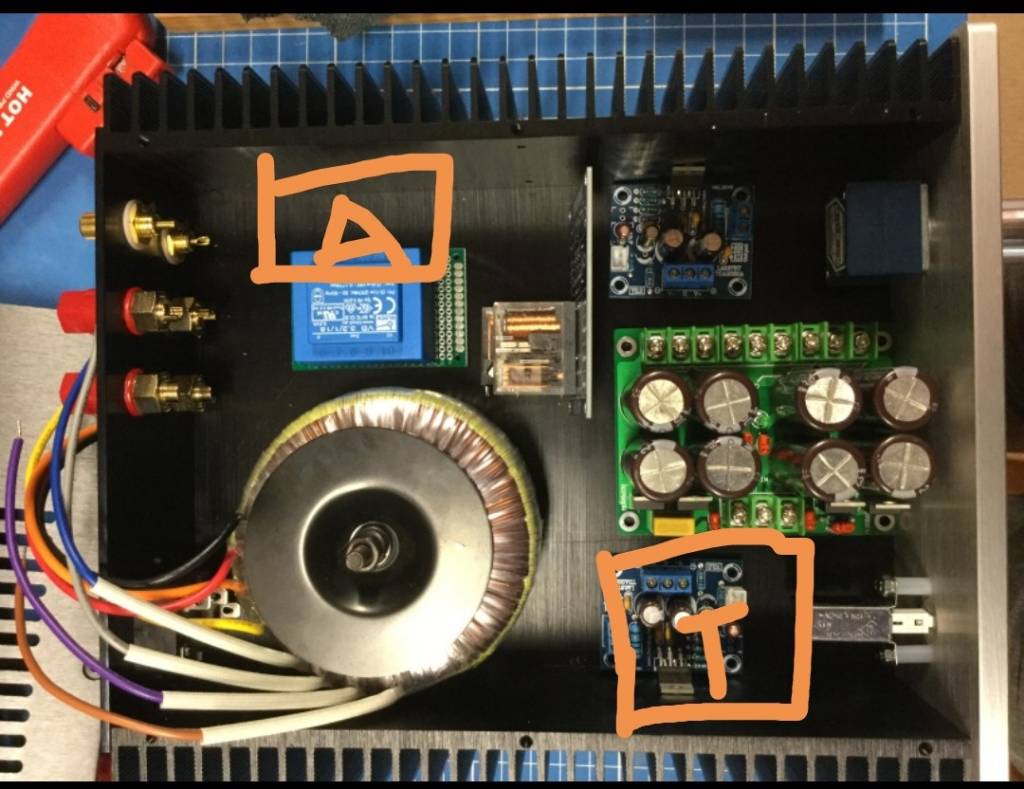

I have been gathering parts for a stereo amp build and am at the construction stage. This is my second diy amp, using two LM1875 boards.
I wanted a compact unit to go with my DIY bookshelf speakers.
Can I get some advice on component layout, what do I need, what don’t I need, can it all be squeezed in?
Here is a picture of the parts in the case.
Components:
Toroidal 120VA
DC power supply board
2 x LM1875 amplifier boards
Preamp board for iPhone (if needed) and separate transformer (blue)
Speaker protection board (not yet assembled) and separate AC transformer (blue)
Anodized aluminium case with side heat sinks from Ali-express
Copper sheet to make a shielding can for the transformer if needed
It is very tight with all components used and I am not sure how to best arrange it.
Can the power supply board go vertically on the right heat sink, or is it too big (wide)?
Don't bother about the copper, it won't magnetically shield the transformer.
Can you swap the RCAs with the rightmost binding posts? They're very close to the toroid.
Will the lid clear the transformer bolt? You don't want that to touch the top (shorted turn).

Thanks for the comments.
Unfortunately the PS PCB is just too wide to go vertically.
Now you point it out, not sure why I got copper, do I need to shield the transformer?
Yea I can switch the RCA over.
I will have to trim the bolt when the toroid is installed.

It's gonna be tight in there. Forget the copper, though.
There may be no room for proper steel shield similar to this:
https://www.ebay.com/i/251787507844?chn=ps
Make certain that the bolt and large mounting washer cannot touch anything.
Alright, ditching the magnetic shielding idea
RCAs moved over.

Volume control goes between the preamp and the power amp.
Twisted pairs carry the signals in/out of the volume control.
I'd run tightly twisted wire pairs straight along the RCA side of the heat sink,
and then over to the preamp. Many prefer shielded cables, though.
They'd be much more difficult to work with for this.

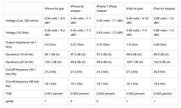

Does this information from Apple's Lightning Headphone Adapter: Analog or Digital? | InnerFidelity say that it is about 0.5v for the iphones?
Not sure how to apply 5x gain to this, is it dB or a voltage multiplier?
Looks like that's close enough to 0.75V that I'd lose the preamp.

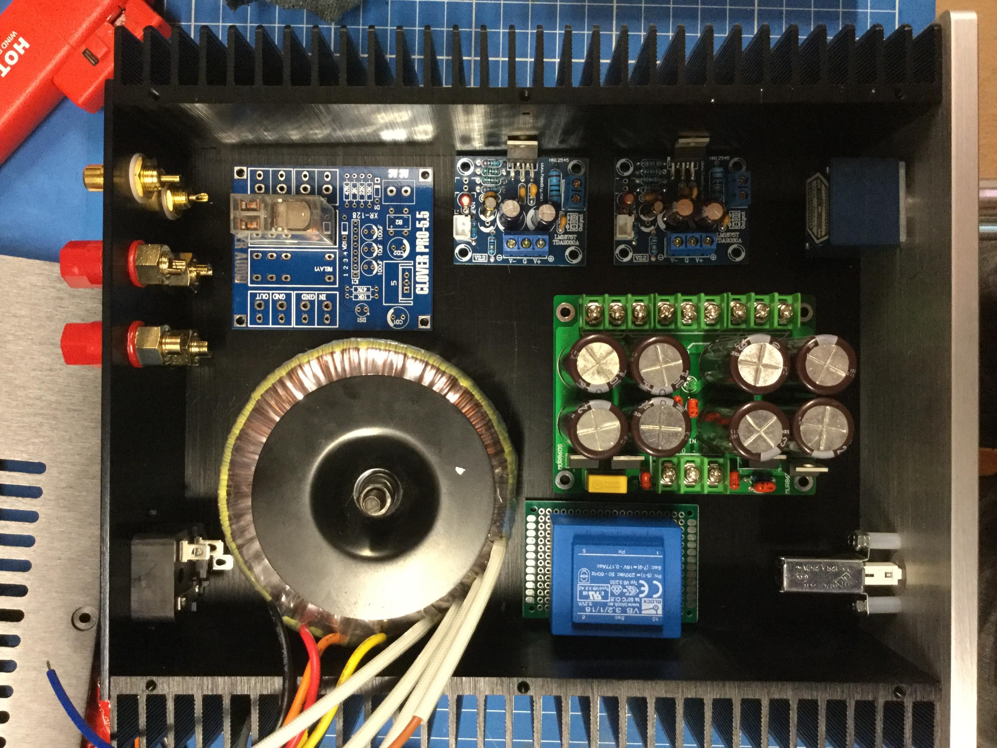

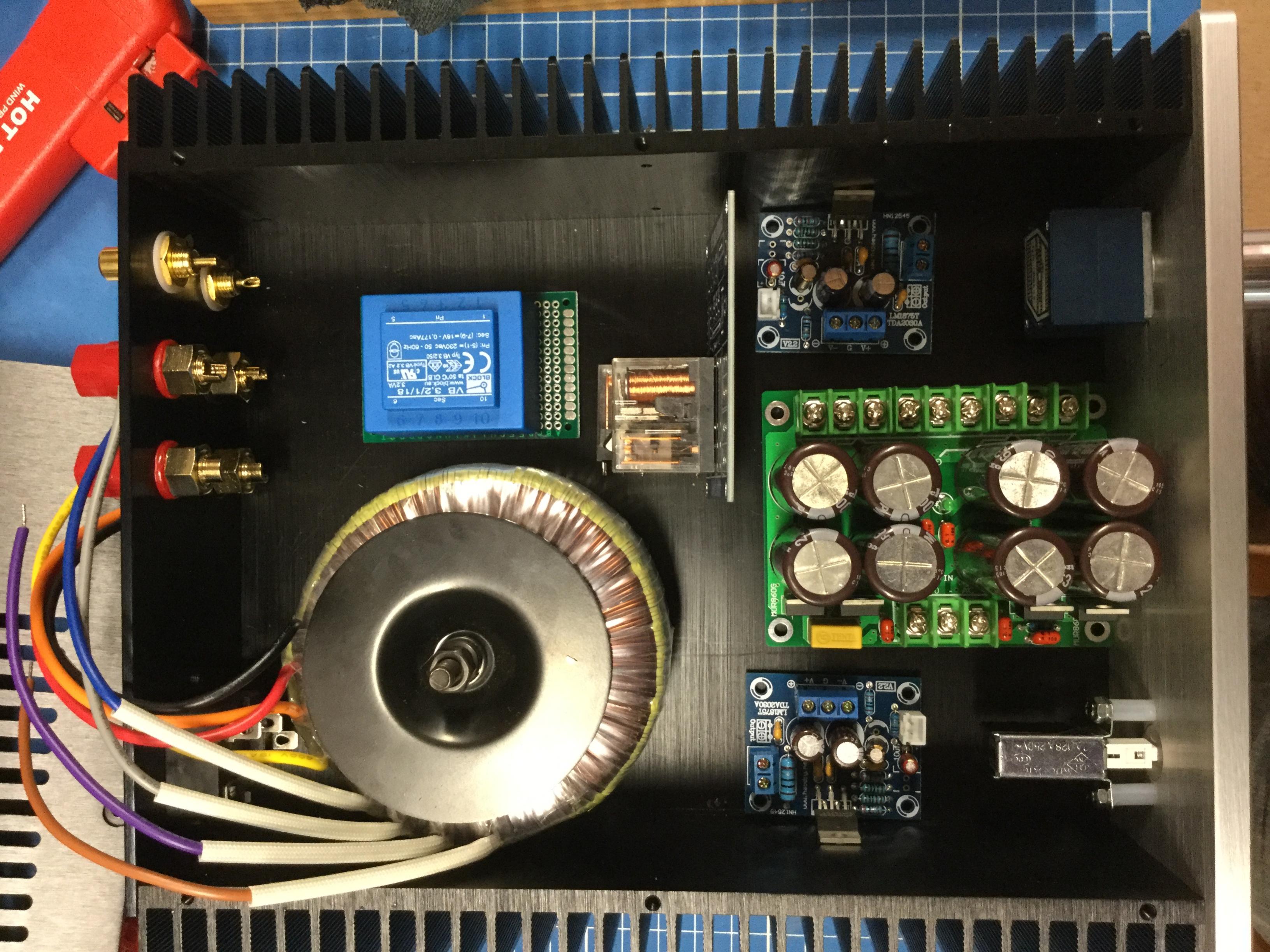

Eliminating the preamp circuit created a bit more space and I have rearranged it.

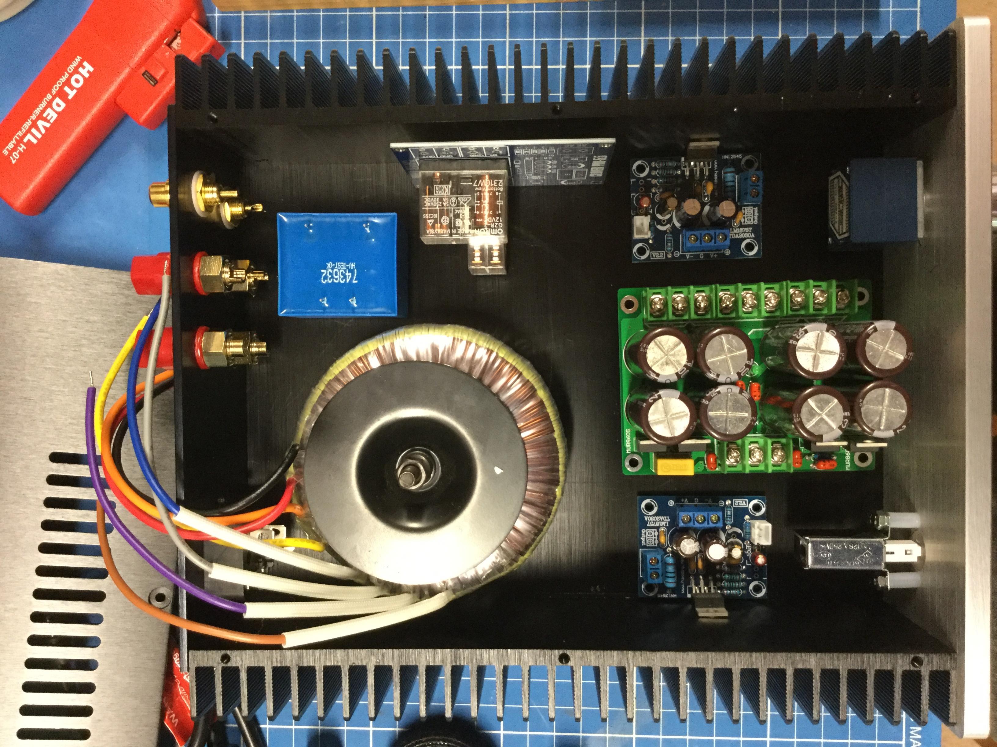

Can the protection board go vertical? If so I would move it's transformer into it's place as it's a but close to your amp board
Thanks for the suggestion. Picture attached.
Not really sure how to mount the small transformer : maybe glue it upside down or put it on a pcb and mount is properly?
Anything to consider when running wires to the front on-off switch?
You'll probably want it further from your inputs or you'll pick up the mains hum there. Perhaps turn the speaker protection other way so it can clear those big relays.
If it's just for you and you know not to throw it around, glue or strong double sided tape should be okay. Definitely heatshrink (double even) the connections so there's no mains voltage exposed. If you're a belt and suspenders type then you could make up a bracket or something and screw it down, or loop a cable tie around it. A PCB would be tidier of course.

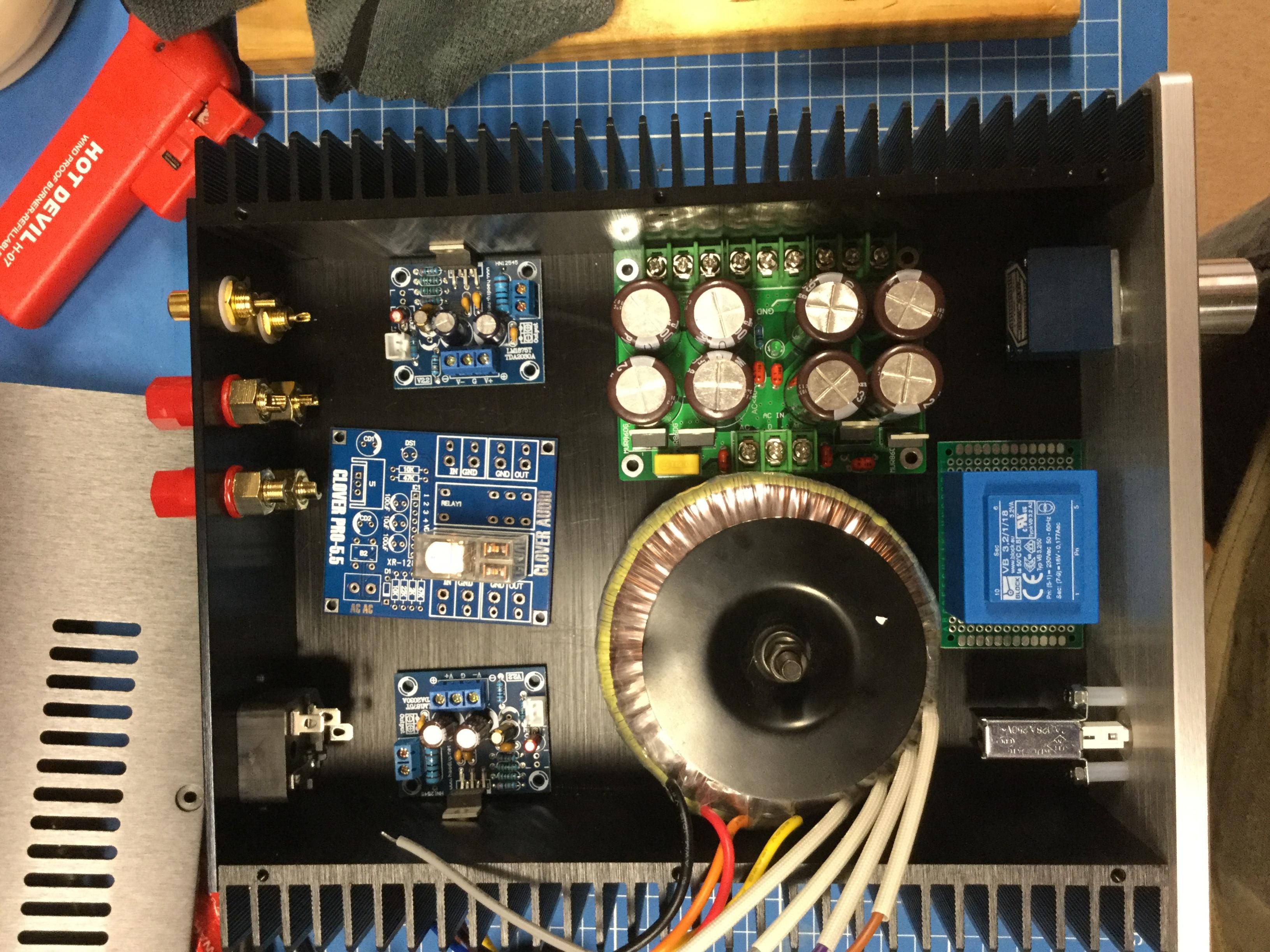

why not moving the transformers and all PS stuff front and make a shaft extension for you alps and keep all signal Stuf close to the input output?
Do you think these small amps could share one heatsink? If you kept all the power supply components in one side (the bottom in these images) you could keep AC well away from the signal path. Just a thought. something like below
