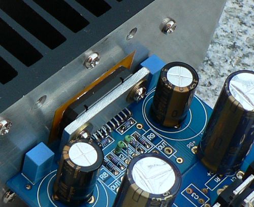

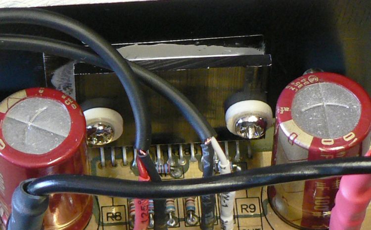

Had a similar issue with the LM4780 and found that the edge of the mounting holes had some conductive metal protruding so mounting screw would touch and short. This was found with running a DMM around the holes and back plate.
That can be solved by using insulating bushes on the screws in conjunction with some heatshrink on the screw thread in this area. The other issue is it's only a part mounting hole so the screw doesn't sit flat without a thick washer. I ended up using a tie bar that clamps over the chip and keeps the screws square. I also used heatshrink on the screw thread for this method.
The material that Peter supplies for insulation is Kapton I think and on later builds I just used silicone insulators cut to shape. You can buy it in small sheets.
Toms suggestion seems the best here, unless you buy a set of Mica and cut to size (may be cheaper than silpads)
Buy some heatshrink tubing say 5mm diameter and use.this on the heating mounting screws to insulate them from the metal tab which protrudes into the mounting holes.
Don't forget the siliconE grease on each side of the insulator (I use Corning and ut works well)
Job done.
I like the idea of a small clamping bar over the chip. Thanks for that.

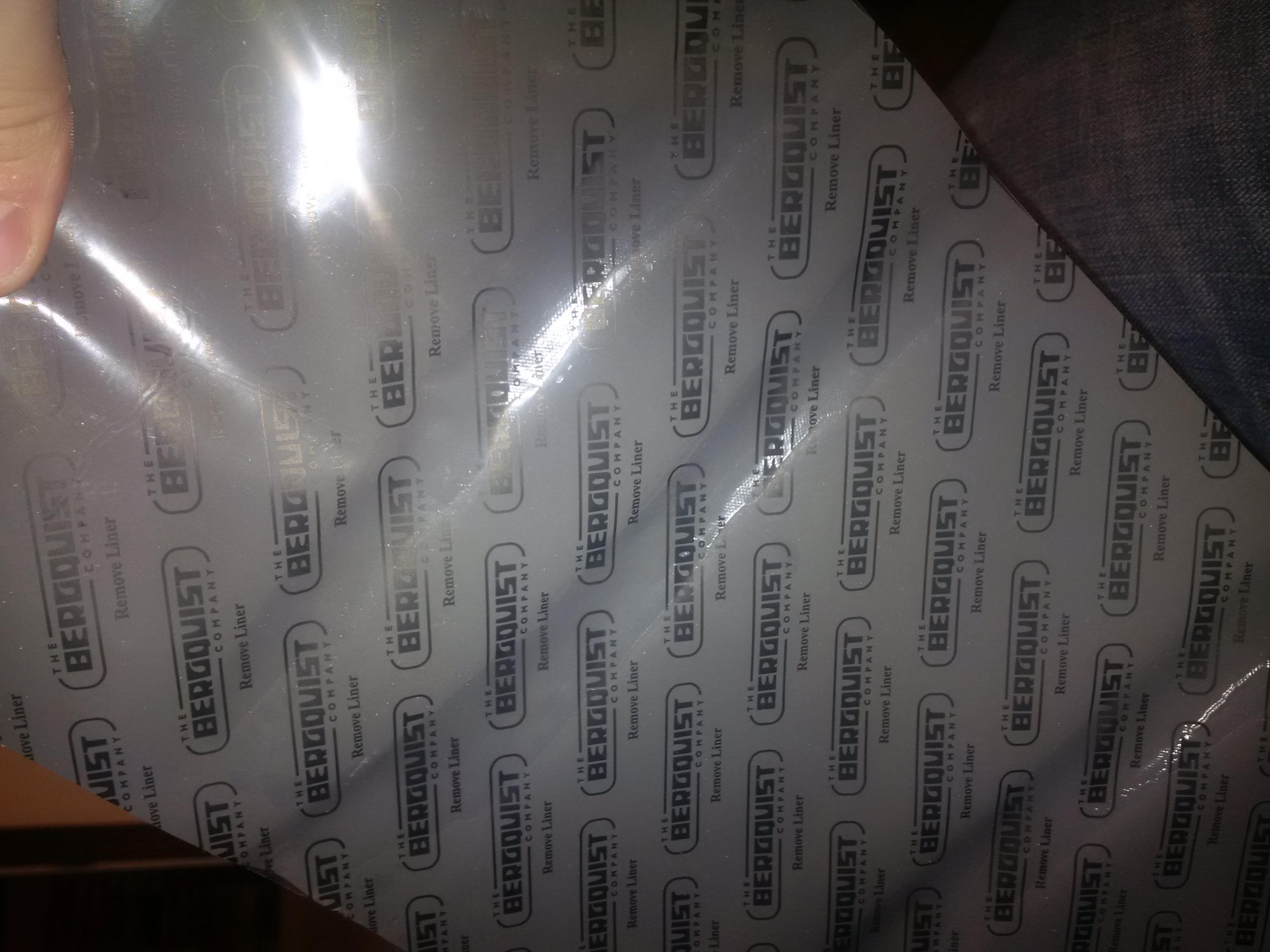

As for the thermal pad, you'll never believe it, but when I made my first amp, I ordered a Hammond box from digikey and instead of the lid, they sent what I now have come to realize is a giant 8x 16" sheet of a2000 silicon fiberglass thermal pad!
That's a pretty nice trade. The A2000 sheet is considerably more expensive than the Hammond lid.
Make sure to read Bergquist's instructions on how to use the stuff. You can find the instructions on their website. Some thermal pads have protective foils that you need to remove before you use it.
