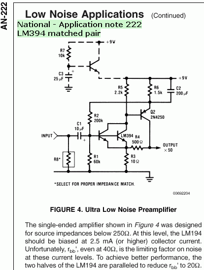

Here is the Schematic of this Super Low noise Amplifier
An ideal application for this amplifier is as a head pre-amp
for moving-coil phono cartridges. These cartridges have very
low output impedance (< 50 Ohm at low frequencies) and have
a full-output signal below 1 mV. Obviously, the preamp used
for such a low signal level must have superb noise proper-ties.
The amplifier shown has a total RMS input noise of
0.11 uV in a 20 kHz bandwidth, yielding a signal-to-noise
ratio of 70 dB when used with a 40 Ohm source impedance at a
0.5 mV signal level.

peranders said:
Halo, this amp was cool 15 years ago. LM394 has low noise but there are better types now. Even an opamp is better, if we talk noise.
MAT02/02 and "Thats" are better.
That was what I thought.
Still how many transistors are there in an OPamp?
And there is nothing to stop us from using MATxx
in the same configuration. Not that I can see.
And we could learn something from most different configurations.
