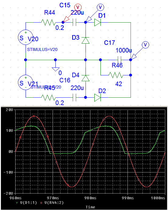

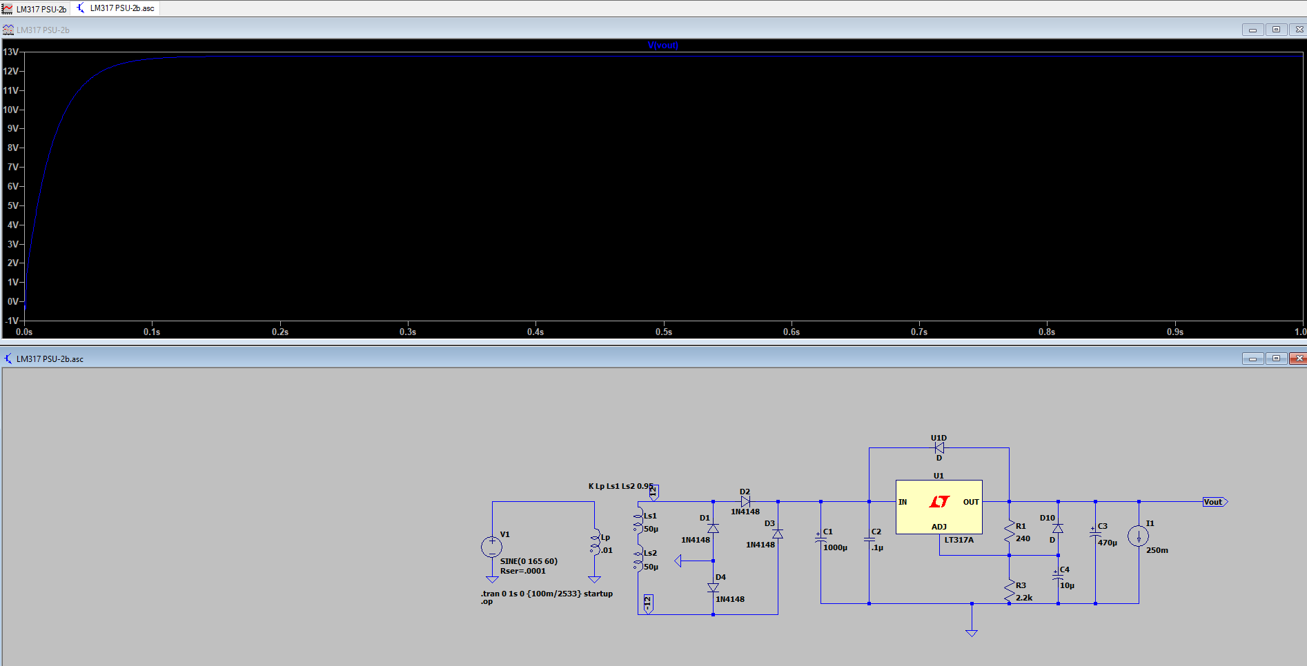

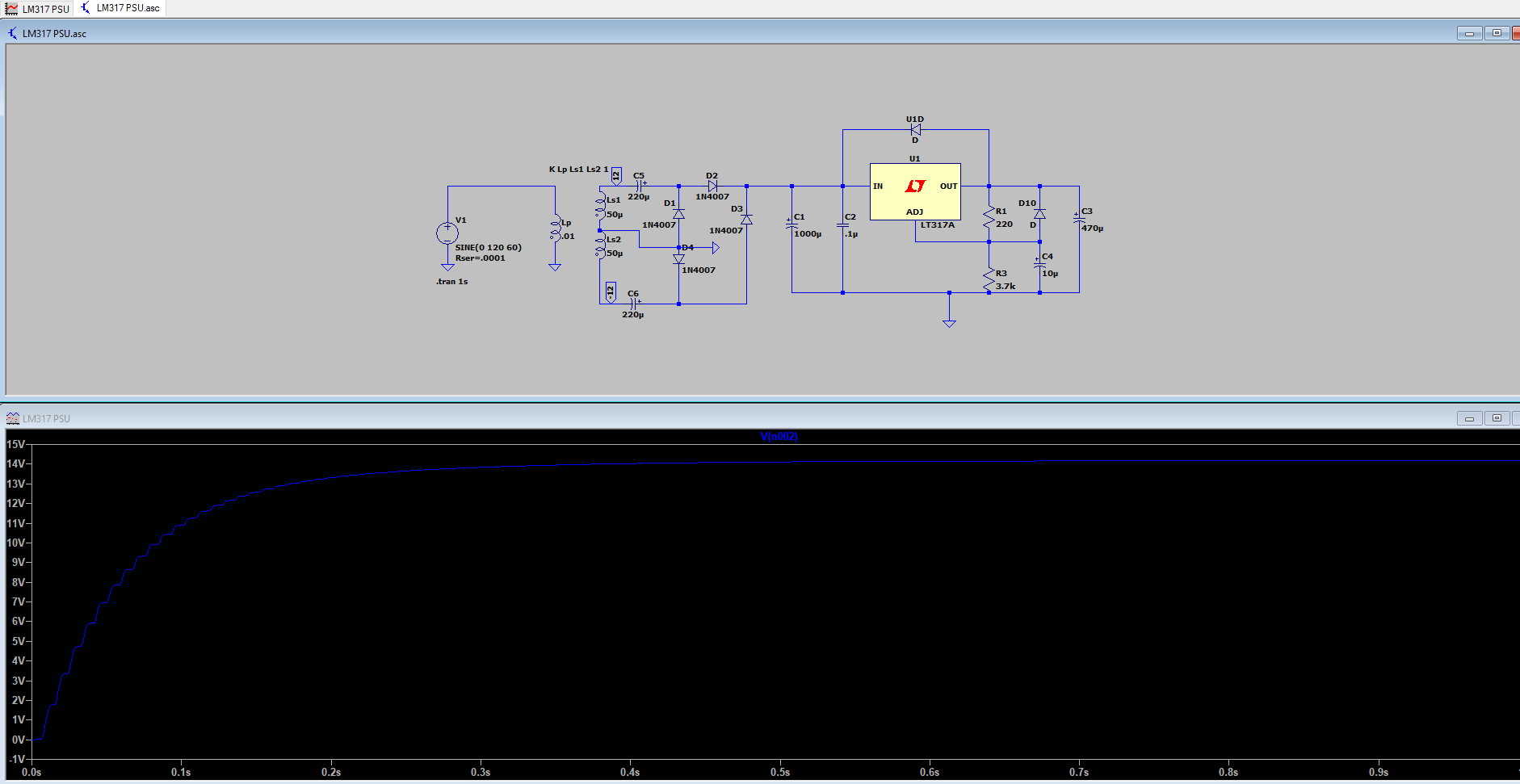

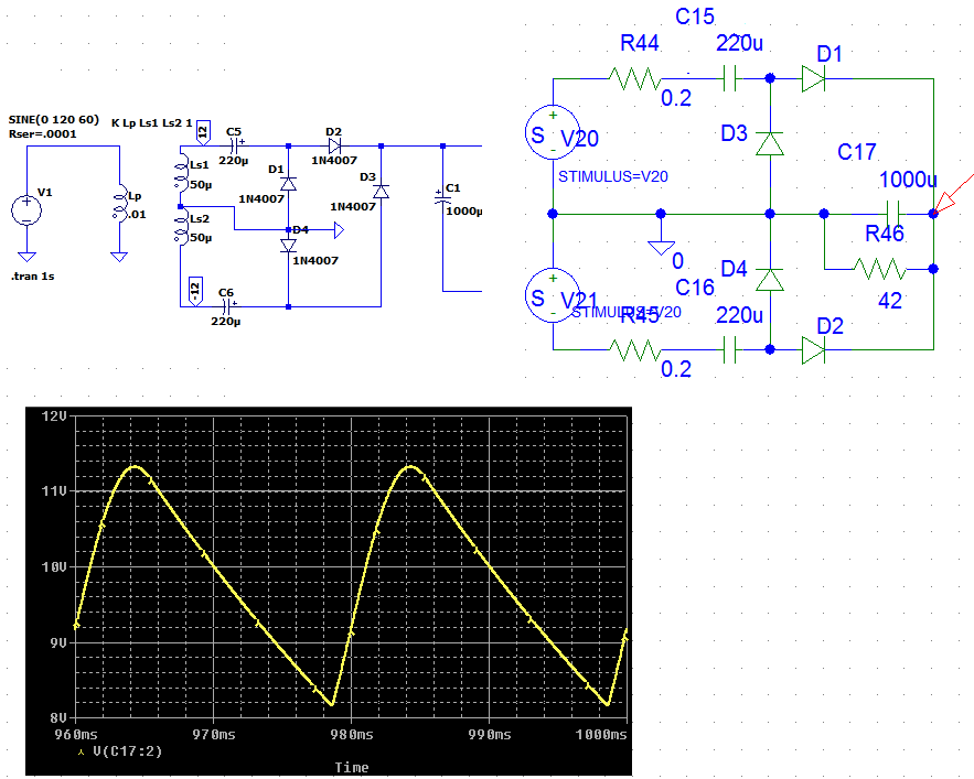

I'm not LT Spice-expert enough to know what the simulator will think of your "12V" and "-12V" labels on the transformer secondary leads, but the resulting story it tells may not be what you think.
If super-silence is what you seek, I'd also recommend replacing the 0,01 uF caps across the MURS120's. Mark's Quasimodo and Cheapo-modo projects on this site are long-running, well-supported, and work great! It'd be worth borrowing an o'scope to do it, if you need to.
Regards

That was just me being lazy and calling out what I wanted the DC value to be. Upon checking my DC voltage out of the PSU it indeed was regulated down to 12.6VDC.
