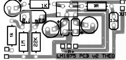

Hi Andrew,
Thanks for your posts. I have learned some things from them, already.
But, are you saying that it is OK to combine the input section's ground, and the decoupling cap's ground, and the speaker/Zobel's ground, at the local star point, and then have only one ground-return conductor from there to the main star ground point at the power supply?
My suggestions were aimed at using three separate ground-return paths: for the input section's ground reference, for the speaker/Zobel ground-return current, and for the decoupling caps' ground-return currents, each going all the way back to the main star ground point at the power supply (i.e. not meeting at any local star point). Do you think that that is unnecessary?
Sorry completely missunderstood your point thanks for clarifying it. Yes this path is shared and it is not good. Which is why I suggested the PSU should be on the same PCB. However if it is fairly close and if thick wire is used the problem can be minimised for LF large current signals.
Fast transients are likely to flow in the loop with the local decoupling rather than back to the main storgage caps which should solve stability problems. But whatever way you look at it there is a shared path.
I guess I handn't considered a wired star back to the PSU due to the extra complexity but this could be a good solution. I normally just put the PSU on the same PCB so you can define the current paths. I guess this is why AndrewT suggested the resistor to lift the input stage from the return currents.

Hi, Maybee I'm not looking at the right layout but the one shown in post 12 seems to have exactly the same problem in that the path back to the PSU caps that apear to be on another PCB is shared. Did you mean post 1 which shows a seperated path for the input stage, but has other problems.
I think that the post 12 layout has a bit of a problem with the position of the feedback resistor right over the high current power supply feed to the amp. You will probably get away with it but there is definately a risk of parasitic feedback here.

gfiandy said:Hi, Maybee I'm not looking at the right layout but the one shown in post 12 seems to have exactly the same problem in that the path back to the PSU caps that apear to be on another PCB is shared. Did you mean post 1 which shows a seperated path for the input stage, but has other problems.

Hi Andrew,
There are three diagrams in the image linked from Post #12.
The two smaller ones, on the left, are only the amplifier portion, without the power supply.
The taller PCB pattern, filling the right half of that image, is for both the amplifier and the power supply. That is the one to which I was referring.
The photo, in Post #13, shows the finished result, for two channels.
I see your point about the feedback resistor. But that could easily be moved to a somewhat-better location, I guess.
By the way: That layout was not created by me.

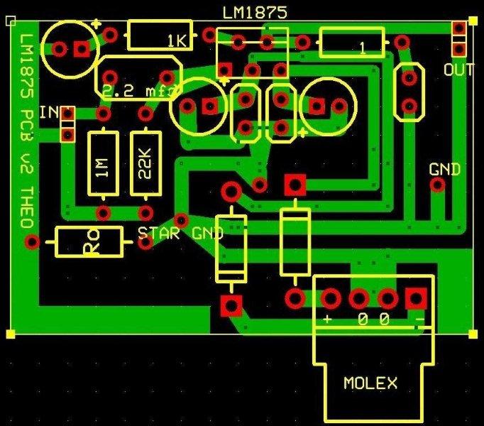

now I have modified my PCB with all of your decisions. I have added two diodes and a MOLEX connector for better flexibility.

The diodes you have used will Form a half wave rectifier. You should look up a bridge rectifier which use four diodes and use this solution as it increases efficiency and reduces ripple.
Also you will need much larger smoothing caps to reduce ripple on the supply. I would suggest 4700uF at least. If you are going to run 5 amps from one supply you will need much larger smoothing caps.

Can I place the large filter caps anywhere inside the board?

Hi paswa and others,
I recently finished a LM1875 amp, based on Elliots Project #72 (I think that's what your using too paswa?)
In the thread that you're mentioning Tom I got a lot of feedback from you (and others) and finally came up with this solution:
(See this thread).
It features 3 separate ground return paths; input ground, power ground and speaker/zobel ground. I think Tom would have liked to see the local electrolytics caps even closer to the chip, but still, this solution works really well ( I have rectifyier and 3300uF per rail on another PCB).
At the moment all three ground paths are connected together at the central star ground, but it is nice to have the freedom to reroute them if necessary.
