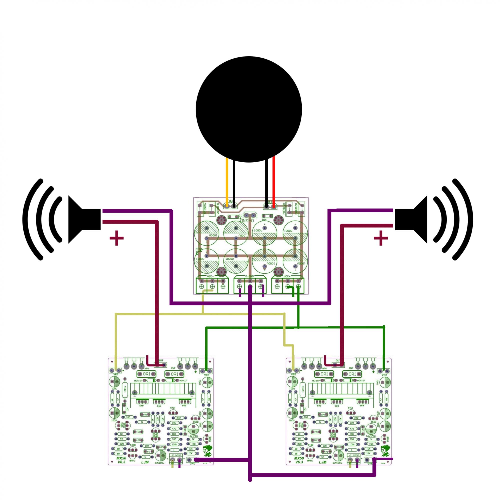

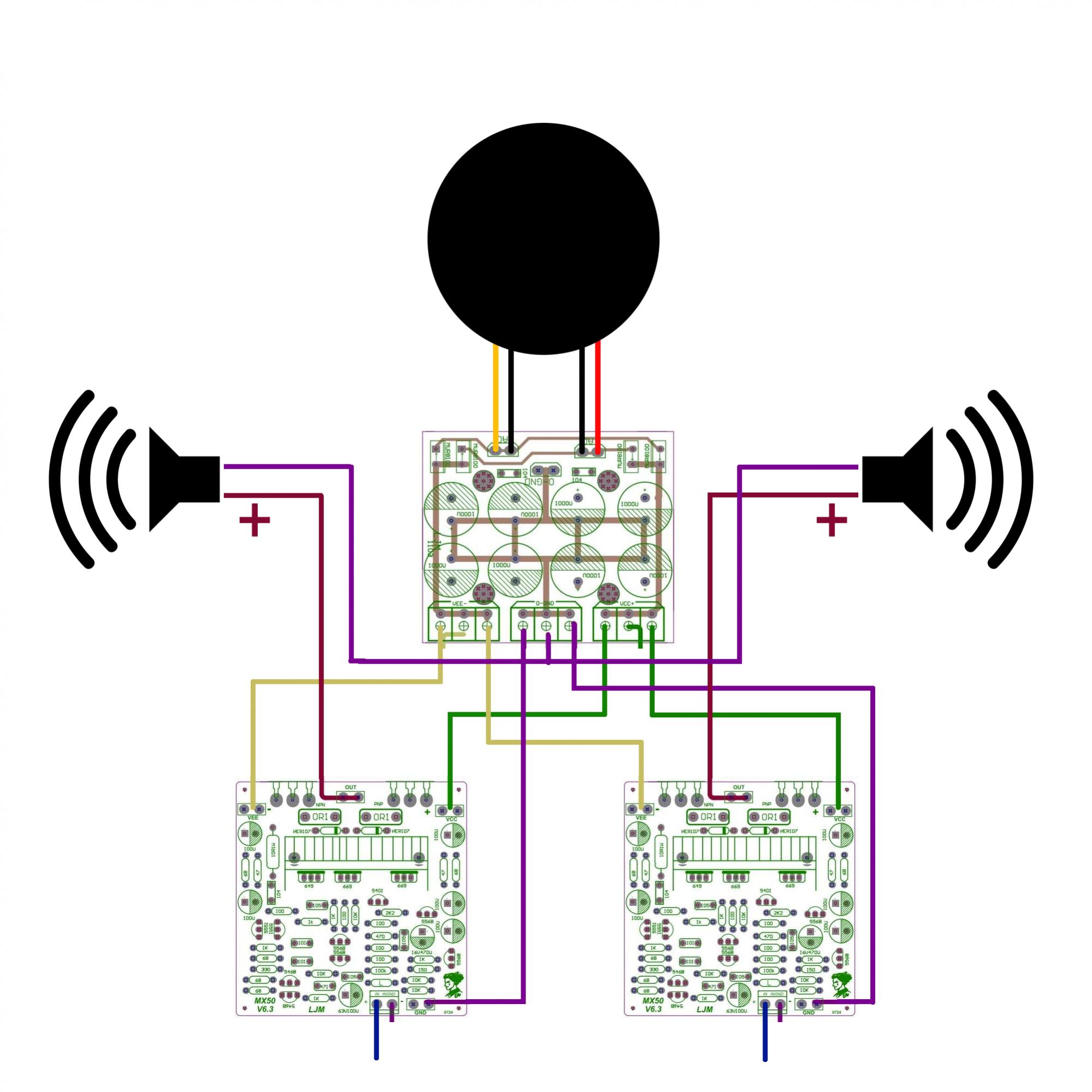

I am a little confused about how to wire
- PSU ground
- speaker ground
- signal ground
- mains earth
Is it a typical star ground?
Which one of these would be the correct way?

From an electrical point of view I see no differences between the schemas. In version 1 you connect the cables at the blocks and in the second one you split the cables later on. Both schemas will work, use the one that suits/looks best.
Regars
Kpax
Dakku,
You'd better select ONE point (on your enclosure) and call that "ground". Next, you connect the PSU, the amps and the speakers directly to that point, no exceptions!
The audio inputs ought to be connected to the "ground" from the terminals.
Don't make the mistake, using shielded cable for the inputsignal, to connect the shielding to the earth on the amp (only on the terminals) because that will create a ground-loop causing mysterious humming...

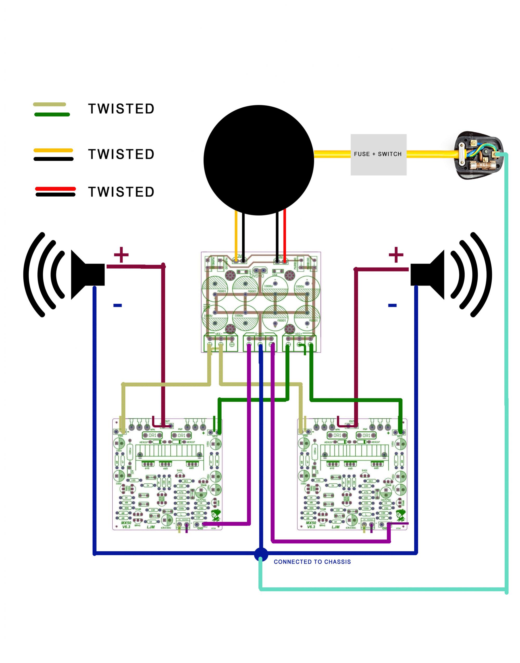

looking at the two diagrams in post1, I can see the speaker Returns are connected to the 3 terminal Ground on the PSU.
This makes this 3 terminal output, the Main Audio Ground (MAG).
All parts of the circuit that need a ground referenced voltage MUST be connected to this same terminal.
Alternatively:
Move the speaker returns from the PSU board and thus MOVE the MAG to a more conventient location that better suits all the twisted cable pairs that are omitted from the diagrams.
Every connection from Source to Receiver is a cable pair. For best interference attenuation each of these cable pairs should be twisted or coax. I don't like coax for internal wiring. I use twisted pairs everywhere (except when it's a twisted triplet).
Here are two examples:
the transformer has two wires connecting to the PSU board (it actually has two pairs).
The Transformer is the Source, The PSU is the Receiver.
Connect the Source to the Receiver with a twisted pair, repeat for the other two wires.
The speaker is connected to the amplifier with two wires.
The amplifier is the Source the speaker is the Receiver.
Connect the amplifier to the speaker with a twisted pair.
This DEMANDS that the speaker return wire must go back to the amplifier, NOT to the PSU.
No.
The Mains PE wire must be permanently and mechanically fixed to the Chassis.
It should NOT be taken to the MAG.
You have separated the speaker return wire from the speaker flow wire. twisted pair.
The PSU to Amp triplet (+, -, 0) must also be twisted. You have omitted the 0 wire from your legend.
