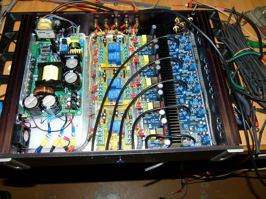

I'm a very happy owner of the L15d's and you can buy them as a kit or assembled. I must say I was quite happy with the quality of the components I received from Zoe-tsang ( especially the PCB , TOP quality ! ).I did some modding , but the basic kit ( and I assume the build ones too) sounded very good !

I'm working on the design for an 11-ch amp, all in 1U case.
I've been considering between two competing layout/wiring strategies, one of which is what you seem to have used.
That is to keep maximum separation between signal input and speaker output wiring.
The possible concern with that is crosstalk between the closely bundled wires for each channel; did you consider that at all?

Thanks Noah ,
I did consider the crosstalk when I was building the amp . I used shielded cable for the inputs , so there's minimal crosstalk there . The speaker and power cables are parallel , so there will be some crosstalk , but the amp is mainly used for (digital) TV and bluray movies in Dolby digital 5.1 .

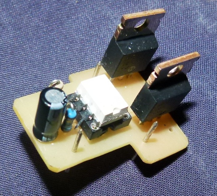

The PSRR of the L15D is pretty good , so I don't think the power wires give much crosstalk either .I am planning to do some mods in the coming weeks , ( changing all the relays to Mosfet dropins) and will measure the crosstalk and let you know .
I use the amp in stereo mode as well with my huge vintage Vinyl collection and the separation and instrument placement are very detailed , so it shouldn’t be too bad .
I was planning to place the speaker wiring in 6 mm grounded aluminium tubes , but wait for the crosstalk results first .

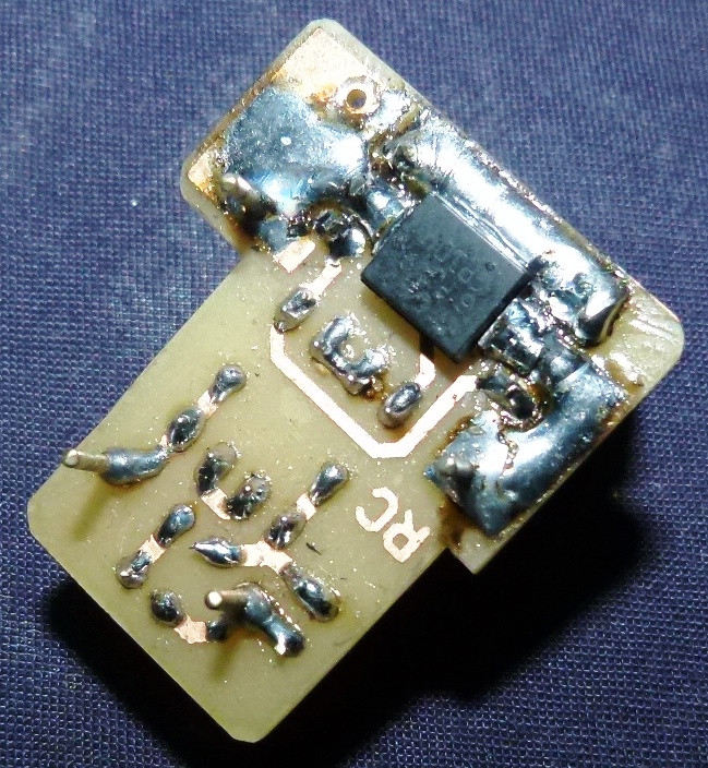

  • SongleSSR.pdf
    SongleSSR.pdf
I had the same thought about running the wires through tubes, but I'm thinking just making them twisted pairs would be good enough.
About solid state relays, I've always been reluctant to trust that the fine details make it through untouched.
