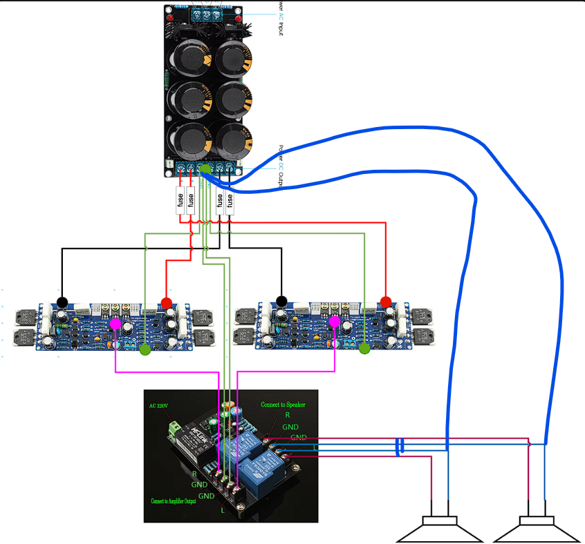

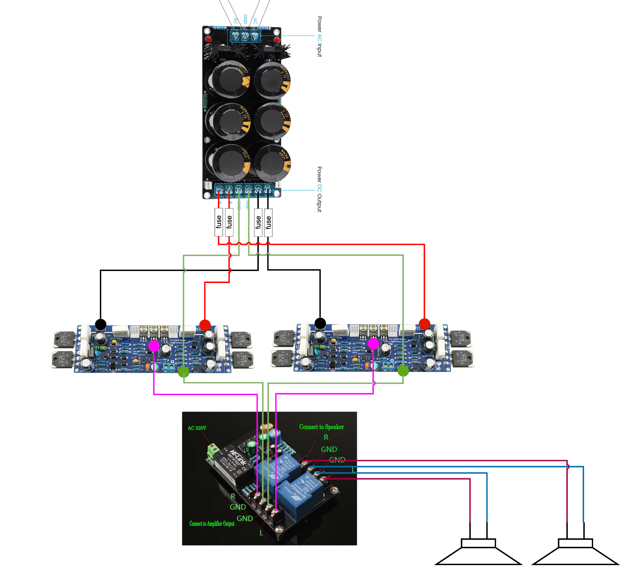

Hey folks, after watchin a number of videos from mr @michael beeny I pulled the trigger on L12-2 and received version 4.2 of this board.
I am a little confused about how things are supposed to be grounded. Can someone please help me check if the following wiring scheme is correct?
Option 1:
  • connect the speaker protect grnd to amps
  • connect amp grounds to PSU

Hi dakku: I would take the "negative" loudspeaker connections back to the main PSU negative. The protection board only requires the negative side of the speaker to be used as a reference sensor relative to the "positive" LS side. The wire can be quite thin as there will be no current flow. The relays then just interrupt the LS positive side which is all you need.
