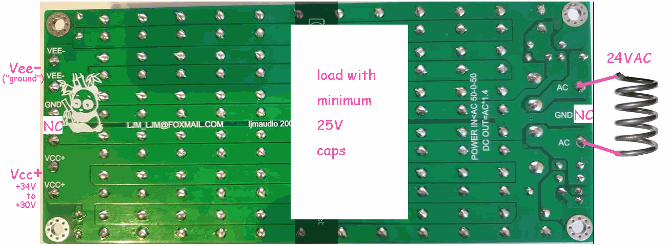

Hi all hope somebody can help ..... I am after a schematic layout for this built up board ...... the reason is I have 24v transformer and I want to connect it so that I have +30v and ground. Presently this board is designed to give +VE and -VE and ground. If I connect AC and ground it works but I am only getting something like 1/4 wave rectification. I want to cut the boards tracks and re connect the -VE bank so that it works as positive.......... the transformer would then connect to each AC input but not ground....
The problem I have is this is dual layer circuit board .... so has anybody built one of these and can they help regarding a general schematic...
https://oi1064.photobucket.com/albums/u367/D3savage/Top again_zpsnkkeg3kj.jpg?t=1594110071
https://oi1064.photobucket.com/albums/u367/D3savage/Top Left_zpsyh7bgqkz.jpg?t=1594110096
...I am only getting something like 1/4 wave rectification.....
Interesting?? :scratch1:
The connection below is full-wave. Simply *ignore* the "GND" terminals. As-made, it has to be loaded-up with twice as many 25V caps as you would need with a simpler plan with half as many 50V caps. It is not hard to wire this up without a PCB. However since you are not clear, just do it this way. If it is already full of >24V caps, you are good to go.

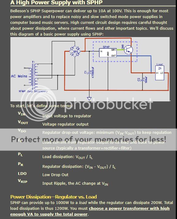

Hi here is the circuit ..... the issue I have is that I have a Belleson SPHP positive regulator 19v ...... my transformer is 12 0 12 so if I connect the windings on traffo I get 24v ac.
What my regulator needs is + and ground I don't need -vee side and I could do with isolating -vee capacitors and using them for +vee I am not sure about rectifier I need to make full use of rectification not 1/4 wave.
If I connect as you suggest I will get + 26v rms (ish) and -26v rms approx 52v my regulator will not accept -vee see diagram below....
https://oi1064.photobucket.com/albums/u367/D3savage/Belleson SPHP_zpsbjwbks8x.jpg
Hi PRR thanks for the reply ..... I connected it up as suggested and got 34.4v sweet....I am still concerned that the -vee ground (-17.2v ie When I measured between ground and +vee got 17.2 and -vee and ground 17.2 ) ..... I don't want to zap regulator.
