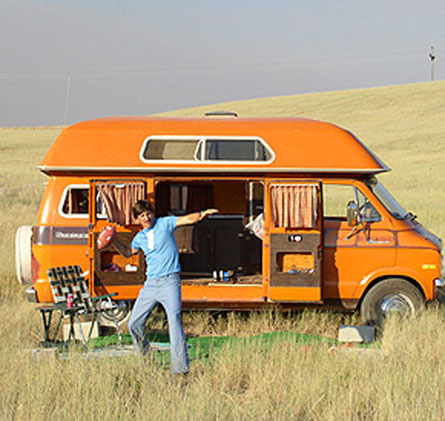

Ok, here's my home. Not sure if these pictures help at all. So it would be easy to put them in the ceiling. But of course that's not ideal. What about converting one of these ceiling cabinets to a speaker enclosure? Is that a stupid idea. Or the floor ones, but then they will be pointed at the floor....

Both of those flat-pak kits are larger volume than what is optimum for the drivers. 18mm maretial is overkill.
FF85wk in 2-2.5 liter, FF105 in twice that.

Just build a pair of uFonken. Plans are here: Frugal-phile | Box Library / Fostex
Build a cardboard mock-up and use it to figure out where they can go (i can see quite a few -- you'll need to rig roof or wall mounts for them). Then after you build them, you can play with all the places you could put them and see which works best for you.

I bought some Vifas. They are so cheap I figured I might as well install them in the ceiling, if nothing else it's a vast improvement on what's here now.
But, I'm interested in building some stand alone speakers as well. And, now that I have a basic system going (as soon as it arrives) I can also take a bit of time and put a little more money into it if needed.
That being the case, for a small space like my van, is the Fostex 85WK with uFonkens my best bet? Looks like a manageable enclosure for my limited knowledge so I'd be game for it.

As long as you have the Vifa's you could make these:
http://www.diyaudio.com/forums/full-range/252627-viva-la-vifa-curvy-cabinet-dcr-tc9fd.html
They can be made with rectilinear panels very easily.

Got the Vifas today. Will probably install this evening. What do you guys think would be best, in ceiling or in one of these cupboards?

And If I mount them in ceiling, how far away from the cupboard should they be?
If I put them in the cabinet do you think it's still ok to have stuff inside the cabinet? I could just make the cabinet a speaker enclosure and keep my clothes somewhere else.
Or maybe in the wall here (if there's enough room in the wall) on the flat part facing back into the camper on both sides of the entrance.

OK, got them installed in the ceiling. Obviously not ideal, but I must say, I'm already quite impressed with these tiny guys. Plenty of sound. Some weird issues with eqing because of the set up, and sometimes the bass literally sounds like someone knocking on the ceiling... I could imagine with a good enclosure these would really be great.
Anyway, already quite happy. Big big improvement on how I was listening to music up until now. Thanks very much for the tip. Can't imagine better for 38 euros...!!
