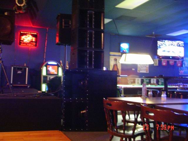

I had a moment today to get a pic.
Now that they sound like something we'll see how the week goes.
Cheers for now till I can get a day to put all the info together.
There are grilles on them but they are hard to see..
I used vinyl coated 1/2 inch square pet fencing and painted it black. Very transparent sonically. Adequate protection.
Trick is to fold the edge all around by one square for a solid mounting.
Theres a slightly blurry first night pic too. I need a new camera!

screamersusa, nice work, it seems 15" drivers work real well in TH's.
What crossover are you using? Would you be able to use them with mid-tops that go down to 100Hz for example?
I have them crossed over at 115.
I use a behringer dcx2496 digial with a butterworth 48db cut on both ends and a narrow 38hz boost at 3 db.
You NEED cabinets that go down to 100hz to make it all work right. I'll probably have to build 15" tops to get it right.
Everyone loves the sound of the system.
Much to my amazement, I got crap for it not bieng loud enough.
Turns out the TH design does take more power without blowing the driver...It was scary cranking it for 6 hours straight with 1000 watts per 450w cabinet.
Looks like I need 6 total to be safe but these three have survived a full week of hardcore combat duty so far.

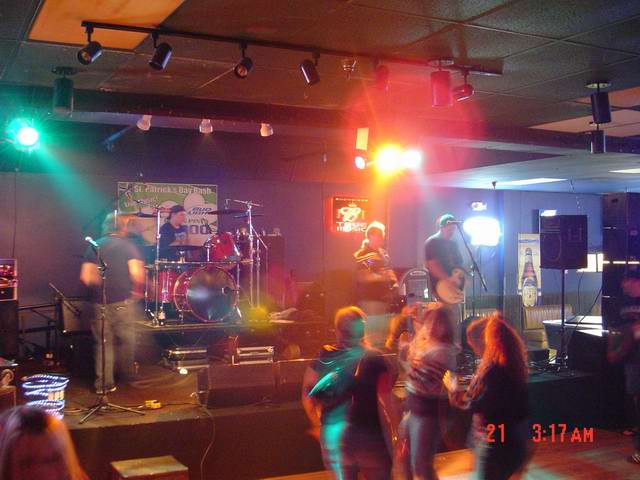

For those who know: This place is starting to get like CBGB. I'm pushing the system hard enough that I'll need to get it up to,
6 th subs stacked, 8 tops, 3 exciters, 2 delays.
ugggh, like I don't have enough work already.

1000 watts per 3015lf?! according to hornresp you would be WAY out of linear excursion at that point. how was excursion lookin in real life though is the real question im after! everything look like it was within linear?
this was with rock music yes? surely the result would be different had it been reproducing bass synth sounds?
very impressive system though, its a shame i live too far to hear it 🙁
Nice to see you back around Screamer.
Looking good.
And yes xstephanx
I would say there wasn't a square wave going through them. Dance music is a beast all in itself.
And not loud enough?
You were pushing 8-10K watts total? Jeez. Sides what GM said (is that why Americans like Mackie?) maybe it was the freq range you run those subs at? Missing the 100-300 range? That attack on the kick drum?
