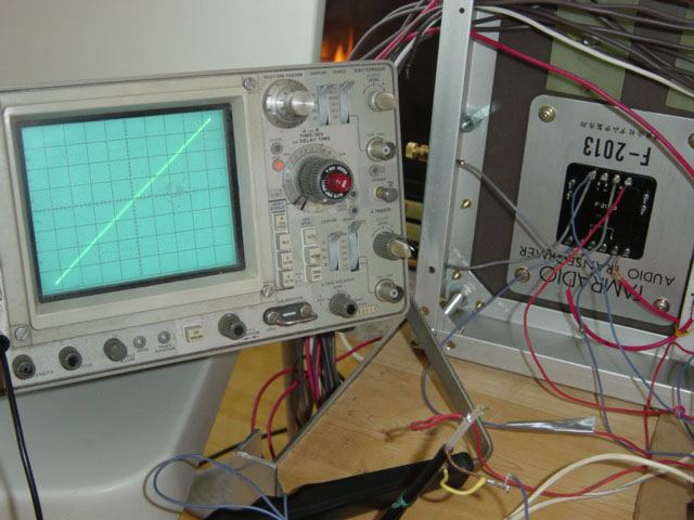

And a gapped core increasing linearity is not a fantasy nor a marketing trick but a reality (also derived from Maxwell's equations) used for transformer manufacturers al over the world, not just Partridge, here is a Tamura
attachment.php
There are others more linear but I have not pictures... 😀
BTW, a SE OPT just does not works without a gap...

All transformer equations can be derived from Maxwell's equations.
Apparently PP Tamura, Hashimoto and Tango that are collected with no gap at all anywhere, not used. All these transformers were relegated to the dustbin due to the nonlinearity in the Partridge. Or have not passed the acceptance on your oscilloscope. Look closely to your screen, it SE transformer and the magnetic core HI-B . 😀😀😀
attachment.php
T
Tamura F-2013 is a push pull opt; not such a good example here 🙄
There are some SE opt's working without a gap 😉
