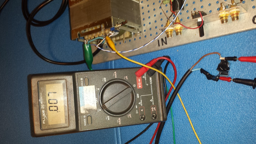

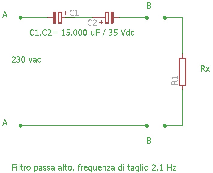

But I wrote one article about the presence of dc on primary of a trafo.
If you connect a, p.e. an hair dryer, close to one power trafo you can see the dc components.
On these stuff to obtain the half of power most of them have a single diode in series with the 220 vac ( in my case), this will create a disturb.
So you can get this the wave as fig. 6 in attch where we have the current that flow in the primary with the dc component
In fig 5 the same without dc.
to avoid this you can use the solution in fig.7 where rx is the trafo, in this case the dc components is blocked.
That all, stop OT, for me.

  • Figura 6-corrente ac_dut_con disturbo-1kw.pdf
  • Figura 5-_corrente ac_dut_senza disturbo (1).pdf
Cheap hair dryer uses a low voltage DC motor in series with a diode. This is a DC component across the line. Most "elaborate" uses a 4 diode or molded bridge unit. But in any case, it generates disturbs in two ways, motor collector commutation, nearly proportional to speed, and another synchronized with line every time line voltage plus voltage drop in the resistance equals tacho generated voltage by the motor itself.
