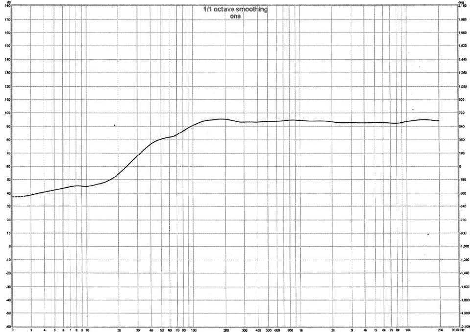

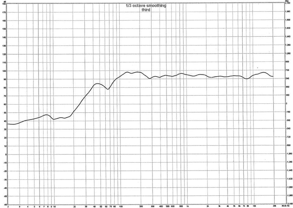

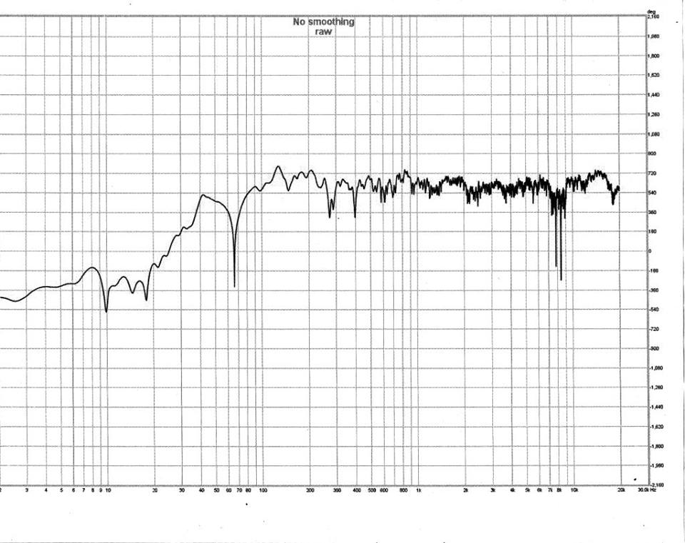

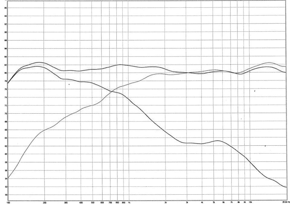

Hi There !!
I used a 5.25" CB woofer for use with my 9.75" tall desktop DIY ESL and the two worked together seamlessly!!
I could not locate either driver in any of the material I had sampled on them, They just worked as a whole like there was only one driver.
The First FR chart shows the interaction of the two drivers as measured from my listening position as showed in the First picture.
The next 3 FR charts are more precision measurements I did with less room reflections and are calibrated in true SPL levels at a nominal 95db or so at 1 meter.
If I run this at a more normal lower level of 85db (nearfield at 2' to 3') then the bass response becomes much flatter and more extended.
This was about the maximum that I can get out of the one little woofer, and if I had maybe 3 or 4 of them it would suit this little panel quite nicely as it would do in excess of +105db all by itself.
At this level (95db) the woofer was at its Xmax mechanical limit for the lowest frequency's (40-60Hz) but it still sounded clear and non-distorted.
Kick drums and Bass guitars did sound amazing, very clean and punchy even though I thought that the cone was going to come lose and fly out at me!!! 😉
I was measuring somewhere around 1cm of p-p excursion and maybe slightly more by a few mm or so on the very same tests that I made these FR charts.
