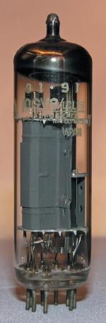

10GV8 tubes....No direct replacements. I found eight NOS and bought them all.....Because the tubes are 'Unobtainium" , s5 Electronics, discontinued this kit and replaced with another. I bought this one of a fellow in the classified section. I guess he had it in the closet, unbuilt, for years. BUT, The owner of s5 had a massive heart attack a few days ago and passed away. So sad, a great guy and a real friend to the tube amp community. Kathy in his office is liquidating the company. Not sure if you can buy anything at the moment. Might want to contact her through the web site.

Nothing wrong with your calculations but it seems that the 10GV8 is indeed equivalent to the LCL85. See the picture and the RCA datasheet.
Strange that this tube is called "10GV8" while the heater voltage is 11.6 V. Why not "12GV8"? Or even "11GV8" if they wanted to make it clear in some way that the heater voltage is not the usual 12.6 V? As far as I know "12GV8" and "11GV8" were never adressed to any other tube type so these designations seem to have been available.
