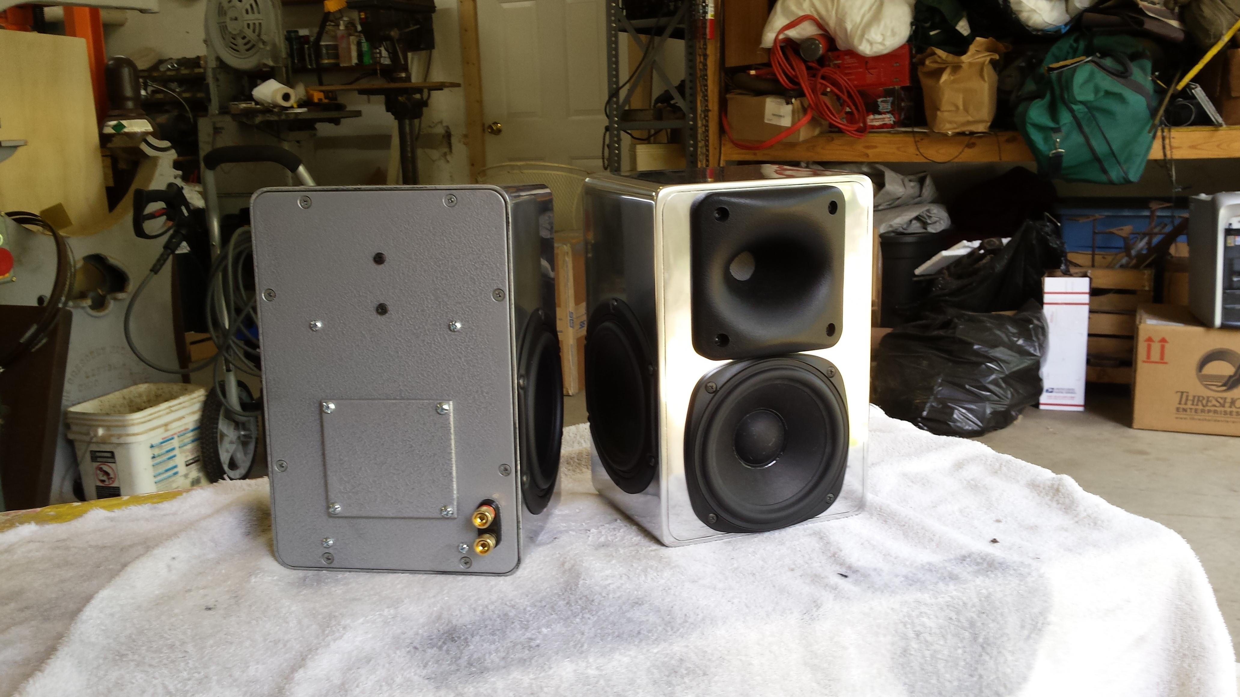

The small speakers I built for my home office are wonderful but bass shy. I am going to build 4 small subs using the drivers on the link. I will use the Behringer iNuke 3000DSP. So how should I wire 4 speakers into two channels?
