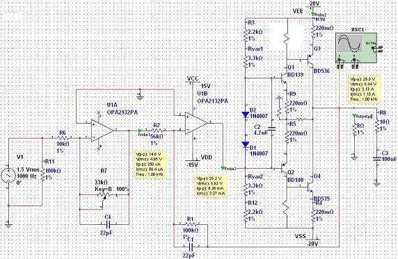

I always learned (with the few electronic lessons at study of physics) that there only can be current flowing to the base of a transistor, not from the base of a transistor.
The emitter (or collector with PNP) would be the current from the collector + the (very little) current from the base.
So why should there be current flowing from the base of Q1/Q2 though the diodes etc ?
Or do I miss a point ?

an NPN transistor has current flowing into the base.
The Emitter Current = Collector current + base current.
A PNP transistor has current flowing out of the base.
The Emitter current = Collector current - base current.
But, it's not just about the directions of the base currents.
The collector current of the upper driver can only be sourced from the base of the upper output device. The base current is very much dependant on the output current and so the driver is going to see a variable collector current and as a result it will not amplify linearly, if it works at all. There is a missing resistor. That's why I asked

So a resistor (with the same value as R3?) from base from Q2 (net6 and output opamp) will do the trick ???
If that is the case, it will be funny, because I found it strange that the schematic from ESP (and thus mine) is not symmetrical. 🙂
(variable resistor in the diode chain would be better I think if we put another resistor on the negative site ???)
So this is what you mean?

The idea of push pull is that one polarity transistor turns on while the other turns off. When a transistor is turned on, in order for it to turn off in a respectable amount of time, it requires some way to deplete the charge from the base, at least a resistor between the base and emitter. IOW, the way it is now, Q3 & Q4 will cross conduct and blow out. Q1 & Q2 collector current equals the base current from Q3 & Q4 and this is way too small a current for Q1 & Q2 to operate, the other reason for a resistor from base to emitter.
Question: If the output of the op-amp is placed on the bases of Q1 & Q2, and the output is fed back directly to the emitters, +/-15V for the op amp, +/-20V for the output, do you see the problem with getting rail to rail swing from the output? Also, if the gain of the CFP is set to unity, it may be difficult to get stability and keep it from oscillating. (In addition you need gain to get to rail to rail +/-20V) Generally, this type of stage would have a voltage divider to set the gain of the CFP. A feedback resistor from output to the emitters of Q1 & Q2, and a resistor from the emitters to gnd. If gain isn’t desired, a follower instead of a CFP would be a better solution.
It may work as is in the simulator, but it won't work that way in real life.🙂
The output from the op-amp can't be higher than 15Vp. With unity gain of the CFP, you can't get a larger signal than 15Vp from the output. But if this is desired, then why use +/-20V?

for Q1, Q2, think of the base as the + input and the emitter as the -input.

The reason for the 20V, is that I've read that the transistor must have at least 20V and with a higher voltage the THD would be a bit better.

That may be an attempt to keep the transistor away from saturation, but it should not saturate until below 1 Vce. 5V above the peak output of 15V seems like a bit of a waste, eh?

If you are reffering to the base to emitter resistors for Q3, Q4, there will only be the Vbe (0.6V) voltage of those transistors across the resistors. 0.6V/10,000 = 60uA. Q1 & Q2 being BD139/140 needs a bias of several mA. It is possible (and probably better) to use small signal devices here but they will still need a few mA of bias. 0.6V/200 Ohms = 3mA So more like around 200 Ohms. 180 Ohms or 220 Ohms, whatever you happen to have on hand.

mm with those two 220ohm resistors on that specific place (and the same circuit) the performance is worse.
How can that be ?
There is also a very big different when a put the opamp output between D1 and Rvar2, D1 and D2 or D2 and Rvar1.
Which one van I use?
How can that be ?

Wonder how it would work paralleling resistors with D1, D2?
maybe like 330 Ohms? Op amp output between the resistors (D1, D2)
Here is a new update, maybe will that be more clear.
The opamp is now connected between the two diodes.
First, at post 44, the opamp was connected between the lower diode and Rvar.
Any further improvements/comments on the schematic ?
