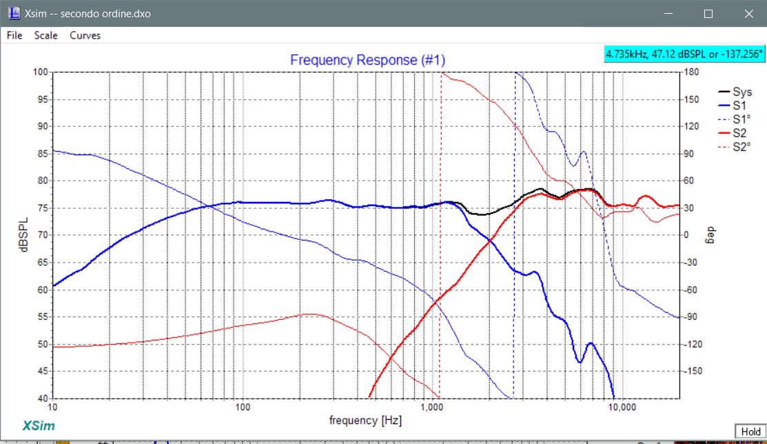

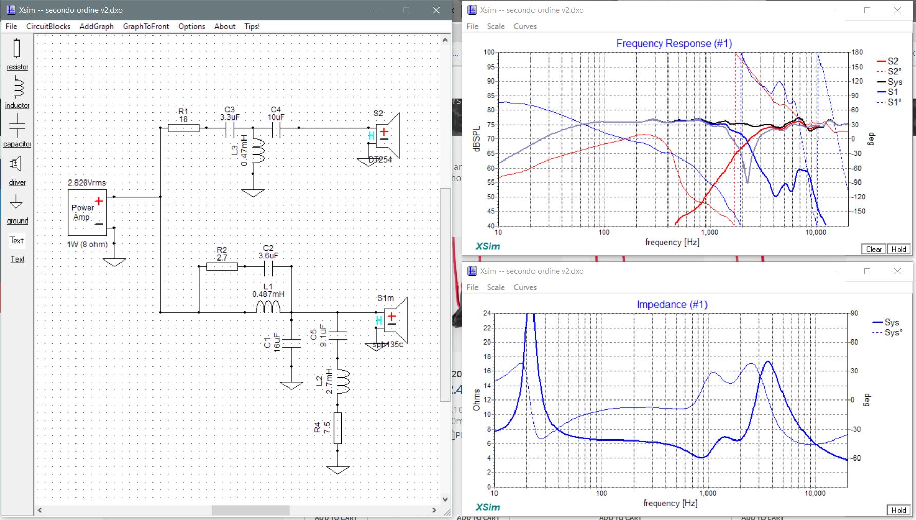

As already said you have to calculate your box size (14 liter tuned at 40Hz is fine) and include baffle step in tour FR to properly design a x-over. There are many tools out there but I prefer to use Vituixcad because all the tools are included in one package; so the steps are:
- design the box and save the frequency (low part or nearfield)/impedance files with the Enclosure tool.
- design the front baffle and position the woofer with the Diffraction tool considering that larger baffle are to be avoided in order to limit the reduction of pressure level at low frequency.
- mix the Low FR (nearfield) prevously saved with the FRD of your speaker by using the merger tool.
- use the main program to design you x-over
Monacor speaker are pretty decent, I have a 5 liter box with a 4-inch woofer (SSP-110)/Audax tweeter - using a first order filter - and I am very satisfied with it, so I played a bit with your speakers by designing a 1st and a 3
rd order x-over. I included a zip file with the frd and zma files, try both and let me know which one is the best.
