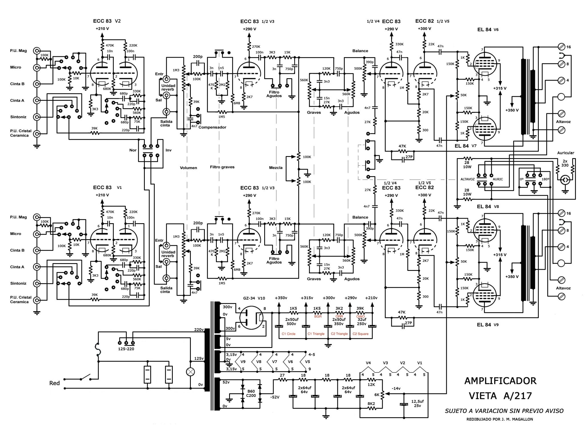

Hey there, I recently picked up a Vieta A217 integrated amp, a Spanish designed and produced model from the late 1960s. Someone already replaced the Siemens EL84s with some 6P14Ps, one of which has almost no emission. I've recapped it, replaced the bias rectifier, and it's working OK aside from the weak left channel. I have a fresh set of NOS 6P14Ps, and want to know where to set the bias on them, the schematic leaves that part out. The max line voltage I can set the amp for is 220V, and I have 230V, so about 5% high. B+ is about 10% high, at 374V on pin 8 of the rectifier. Looking at the plate curves, if my math is right, I want about -10.5V on the grid, is that right? The lowest I can adjust it down to is about -14V, and so wondering what the best approach would be. I've thought about adding a 7912 to the bias supply, which would put me in the right range.
Am I right in wanting to set the bias at -10.5V? Any reason not to put a regulator in there to drop that voltage down a bit and stabilize it?

The phenolic pots might be the 50K bias balance shown in the schematic. To monitor the current draw of the EL84 tubes you could put 10 ohm resistors between pin 3 and ground on each tube. A 1K resistor between each screen grid and the 315 volt supply would likely make life easier on the EL84s too.
To amplify on Steve's recommendations, bias is set to a particular cathode current, rather than a grid voltage. The safest and best place to measure this is as Steve says, with a small 1% resistor in the cathode lead to ground. For your amplifier you'd crank around whatever pots you have available until you see maybe 0.30 or 0.35 VDC across each 10R cathode sensing resistor, meaning 30 or 35 milliAmps each valve. 6Pi14Pi is pretty rugged, and you may even try 40mA to see if you can hear it. If you can, you're either young or not taking enough drugs; both self-curing with time. Arf.

As this amp has common bias for all tubes ( only a balance for each pair) a matched quad is needed here. New EL84 fits fine.
Also adding 10 ohm resistors in the cathode circuit will make adjustment better. 30-35mA as suggested would be a target.

Hey thanks everyone. I'll add some resistors to the cathode circuit and see what I come up with. The new tubes I have are a matched quad.

no need to fit cathode resistirs to determine tube current,
just measure DC resistance of each half primary winding (amp off and cold)
then measure voltages across half primaries (amp on and hot)
and now use ohms law I=V/R to calculate individual plate currents;

Safest is to assume (parse for: makes an *** of U and ME) that a random reader is interested but not yet totally knowledgeable (as we all are). Cathode resistors give us an unambiguous, safe, temperature insensitive, 1% plus meter accurate, should-have-been-there-already measurement. So, I campaign for this as a standard practice for professional restorations, possibly even including chassis mount test points at the cathodes.

Nothing much to add that hasn't already been said apart from setting the bias @ X volts or the cathode current @ YmA doesn't give one the full picture of a valves DC operating conditions. A better methodology might be to determine the valves quiescent power OP. EG Va * Ik. I set my amps OP valves at about 75% of datasheet maximum as I'm after long life as apposed to maximum OP power.

Following Sorento's suggested method, all four new tubes are running between 31.5 and 32ma so I'm gonna leave it as-is.

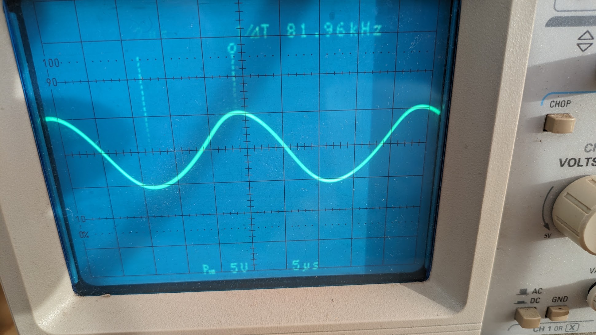

I've got two more problems to solve now: the phono stage is oscillating like crazy, I've got an 11V peak-to-peak sinewave at 82kHz on the second plates of both V1 and V2. Odd that it's both channels, yeah? I've also got a fairly loud hum in both channels, all inputs, like a ground loop. If I touch the chassis with my hand the level drops quite a bit. This is using the old 2-prong non-grounded plug, and it's going through an isolation transformer. I'm guessing the first step is to replace that power cord with a proper grounded one and see how it goes from there.
