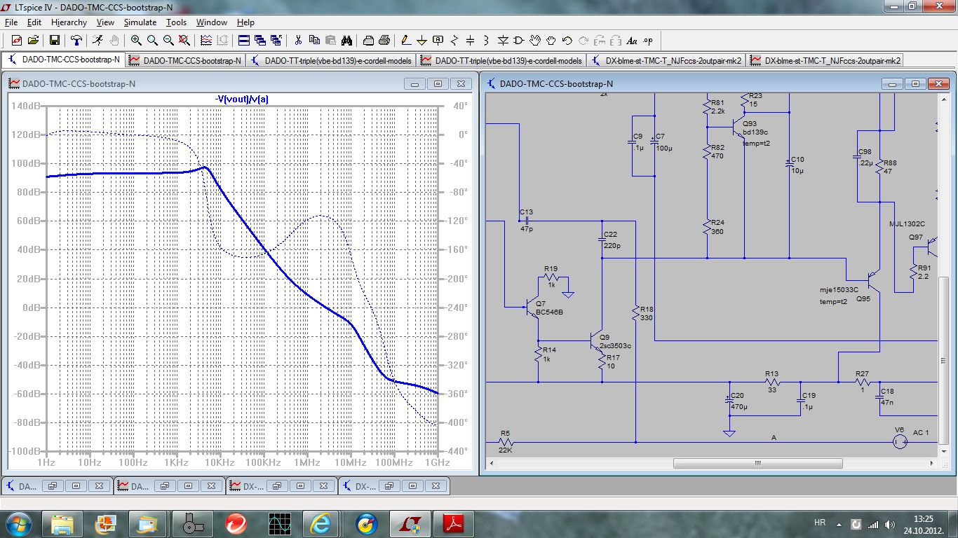

what is the difference between loop gain and open loop gain?
What do the .op statements look like for the three conditions you are examining, closed loop gain, loop gain and open loop gain?
Is loop gain the 1/NFB ratio = beta?
Loop Gain(LG) is difference between Open Loop Gain(OLG) and Close Loop Gain(CLG), means OLG-CLG=LG. LG is effective Negative Feed Back at different frequences.
You can't use .op (compute the DC operating point treating capacitance as open circuits and inductance as short circuits) to simulate LG, CLG or OLG, you use .ac for that.

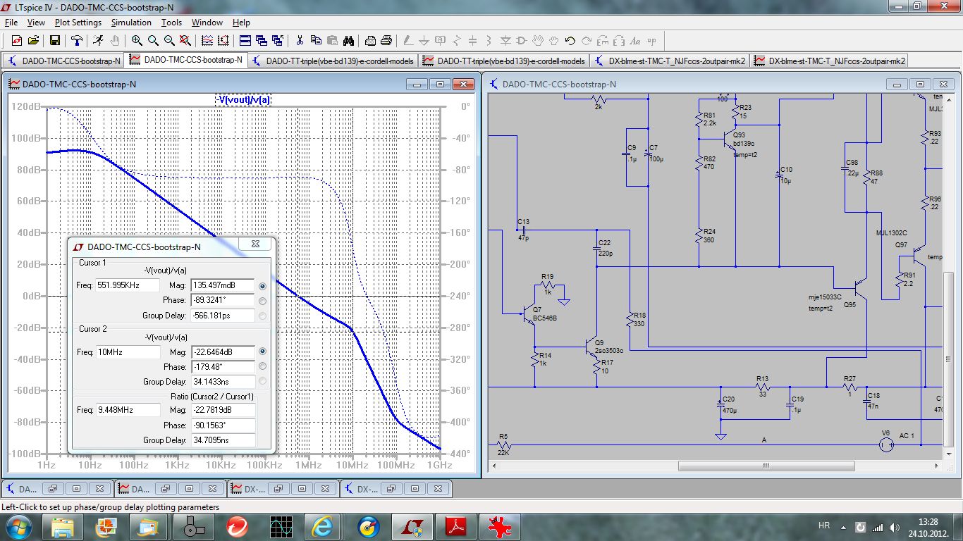

how did you compute the gain/phase response.?...

Do you mean LG or CLG?
For LG I do with TMC resistor init and out of Midlebrook probe. Look at attached diagrams.

It was about the CL phase and gain responses.

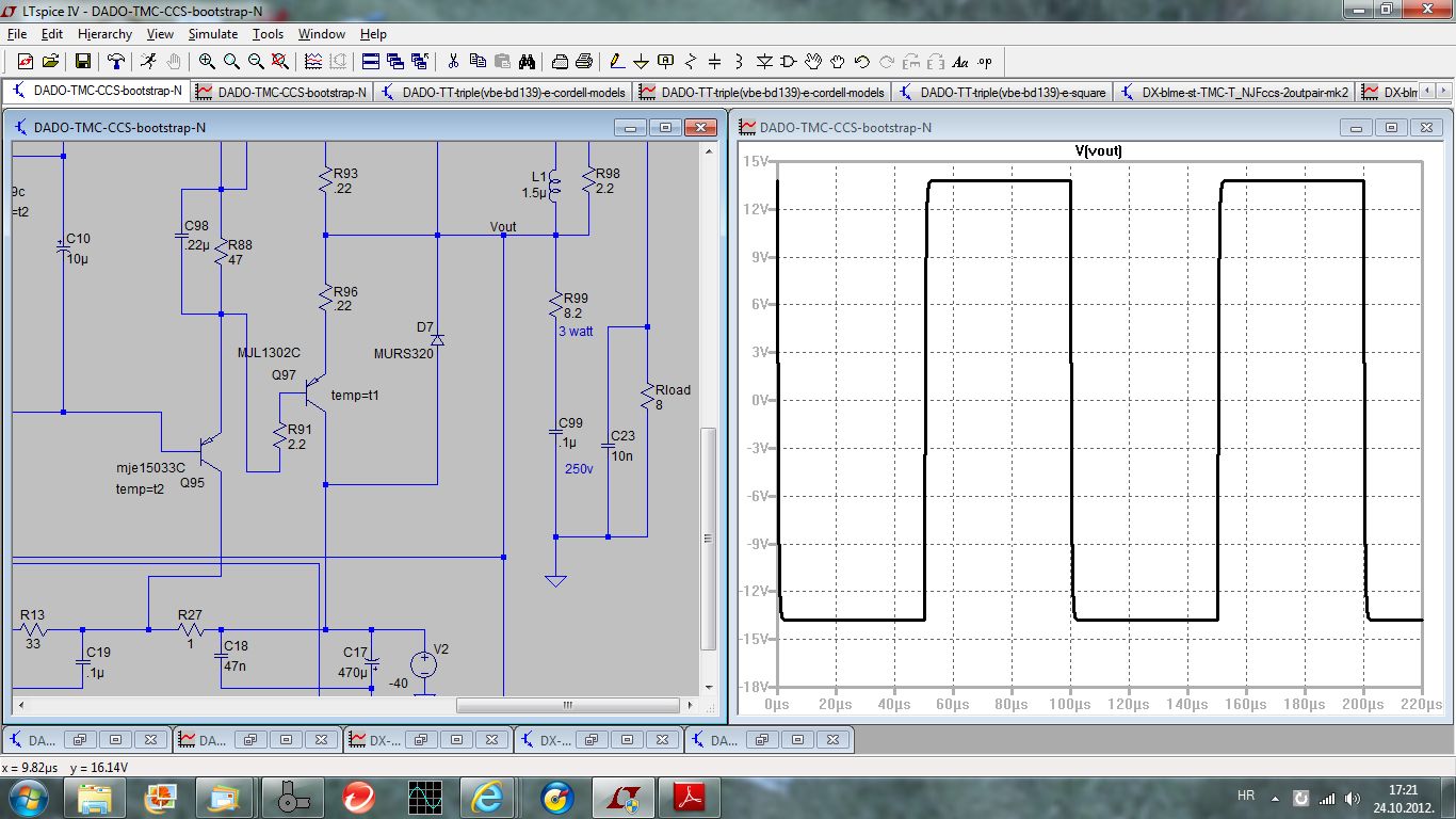

Anyway to check stability you can use a square signal
and parralel a 10nF to 100nF cap with the load , it is often
quite revealing.

I am not sure I understand what you want to know about CLG. How I did the CLG simlation?
I don't have working prototype yet to do Square wave test(I did it on similar standard TMC circuit in my other thread).
Your TMC resistor has quite low value and this generaly reduce considerably
the phase margin once the output is capacitively loaded.
As for square wave test i was speaking in simulation , not in real life ,
as the simulator provide a good estimation of an amp behaviour in this matter.

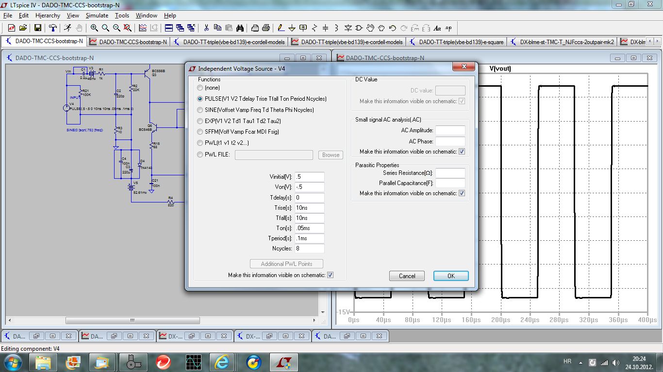

Here is zip file containig .asc file and models files. Unzip it in the same directory and just run simulation.
There are .tran .ac defined but just one active (.tran or .ac) and others passive(;tran ;ac)
Input generator V4 could be changed from sinus to square just copying the lines already there:
SINE(0 {sqrt(.75)} {freq})
or
PULSE(.5 -.5 0 10ns 10ns .05ms .1ms 8)
there one .ac for (for CLG or LG)
;ac dec 1k 1 1G
and two .tran square and sinus
.tran .4ms
;tran 0 {simtime} {dlytime} {timestep}

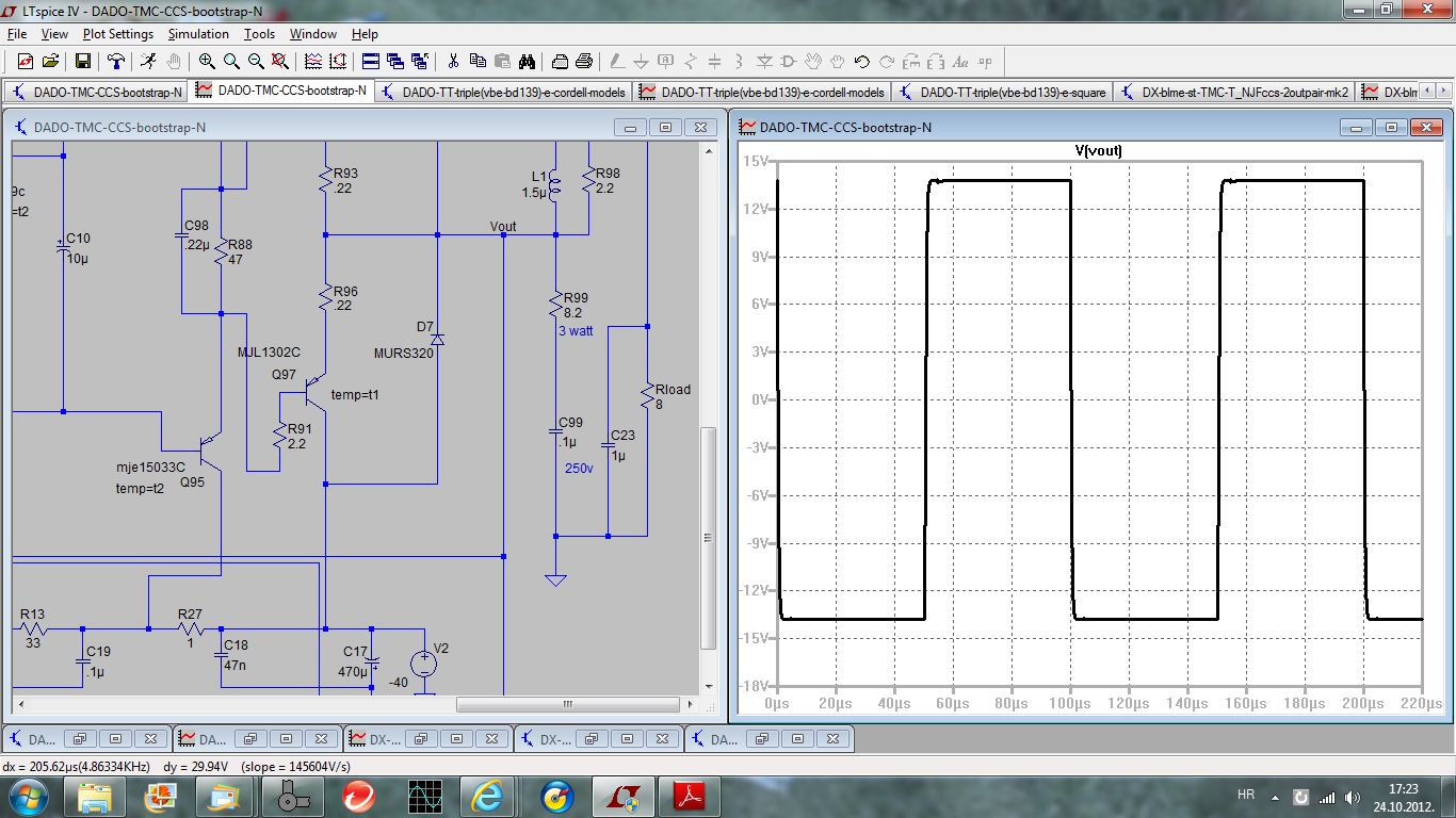

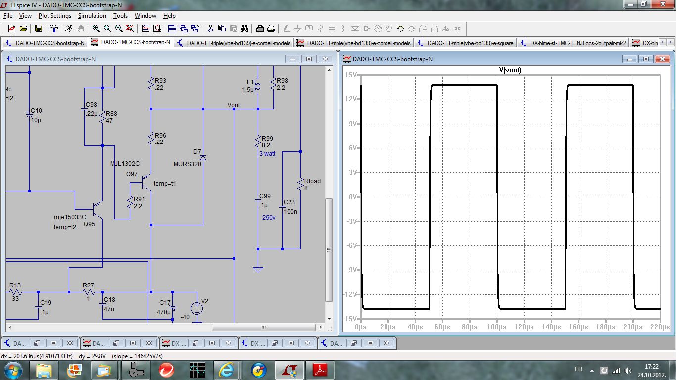

The square wave is applied to the normal audio input and passes the normal RF attenuator. This slows down the step response of the sq considerably.
To stress the circuit more, the RF attenuator should be opened up a lot, maybe a factor of 10, or maybe a lot more. Changing C2 to 22p may give a different result, But it may be that 2pF is more appropriate. But don't go to far. An ultrafast step of the squarewave may be too stressful. How do we adjust the pulse parameters to change the slew of the pulse?

@ 22pF I see some ripples in the square wave? Is this feedback leaking past the input transistor affecting the pulse signal?
@ 2pF the negative going has gone haywire. Is the pulse now too fast? I see a rise time of ~20ns?

You can change the generator rise and fall times.

What you suggest to be rise and fall time, 10nsec is to short? If I use 200nsec and remove input filter all is OK.
dado
10ns should be enough , it s about the value of average real world generators.
