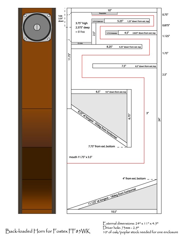

Strange how I've received a bunch of PM's and requests for a plan for this little "horn" despite never having outright recommended it. It was no more than a simple design I had in mind, where I planned to test a Hornresp simulation using a fairly simple material and build implementation.

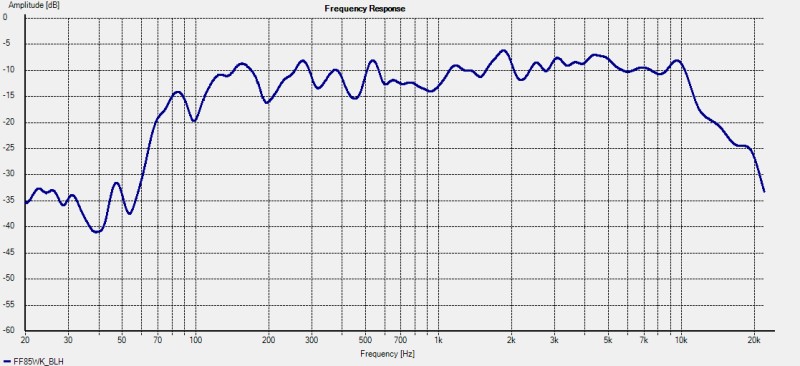

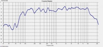

It sounded alright, but I'm sure there are much better solutions for FF85WK out there. That being said, I don't have these enclosures anymore (for maybe a good 6 months) and don't remember the exact throat setup I ended up with. Here are the images for the plan and response I could rescue from my old Imageshack account - not very big unfortunately.
The "horn" part worked well enough to negate baffle-step; these could be out in the center of the room and sounded balanced. Driver Qt is higher than typical horn specs, but the Fs being high as well allowed for a high mass-corner to use horn-loading underneath. The horn mouth could/should have been larger IMO. It had usable bass into the 70Hz range I'd say.
The horn output could have been cleaner and 'boisterous' is the best word I can use to describe what I perceived. This added some weight and punch to certain source material - but was detrimental on other stuff, much like I found my various Karlsons to be. Single acoustic instruments, voice, girls&guiar, jazz trios, chamber music and electronica all sounded pretty good. The heavier rock genres fared poorly OTOH.

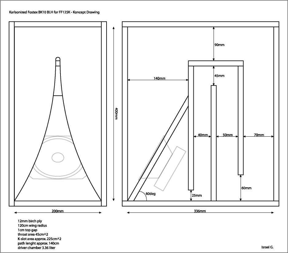

This other 'crazy' idea predates the wave of modern mini-K's but is in the HAK spirit, as well as a spiritual successor to the older mini K-lines / K-TL.
'Karlsonized' BK10
I only ever foam-cored an actual BK-10, not bad in its own right.
